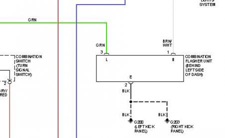

where would i change out a flasher relay? cant tell by looking at my owner's manual.

Hello .. thanks for the donation .. much appreciated Combination Flasher Unit Behind left side of dash.
https://images.2carpros.com/forum/automotive_pictures/266999_path_2.jpg
