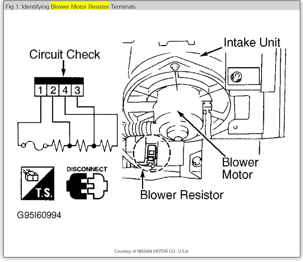

Where is the Blower fan resistor located in a 1999 Nissan Pathfinder?
Apr 26, 2008 at 3:47 AM
  • 75,992 POSTS
The blower fan resistor is next to the blower motor which is on the passenger's side of the car under the dash here is a diagrams to show you. Check out the diagrams (Below). Please let us know if you need anything else to get the problem fixed.
