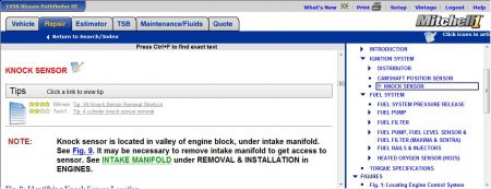

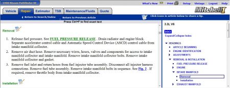

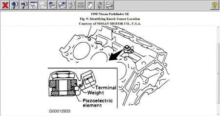

Procedure for replacing sensor
Tuesday, September 15th, 2009 AT 4:25 AM
MECHANIC
75,992 POSTS
See below
