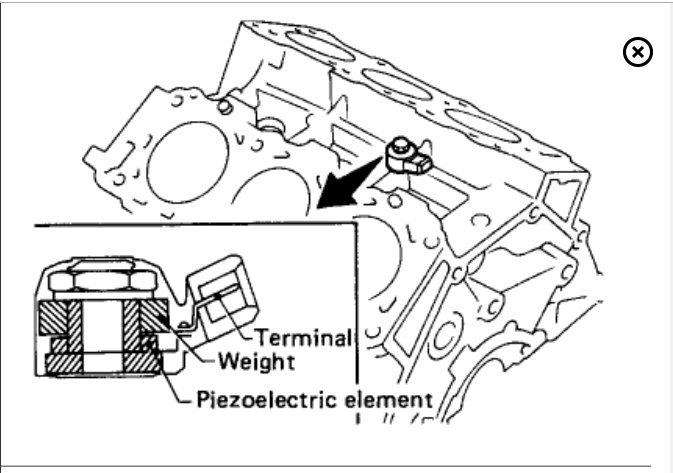

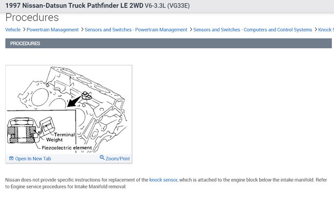

The knock sensor is under the intake manifold, here is the instructions on how to change it out in the images below. Please let us know if you need anything else to get the problem fixed.

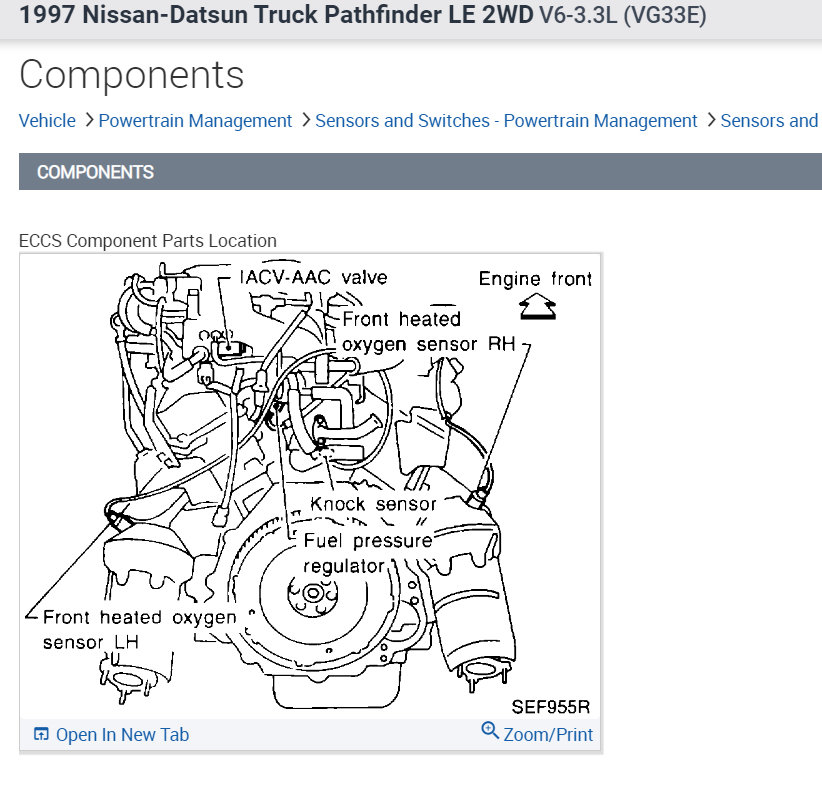

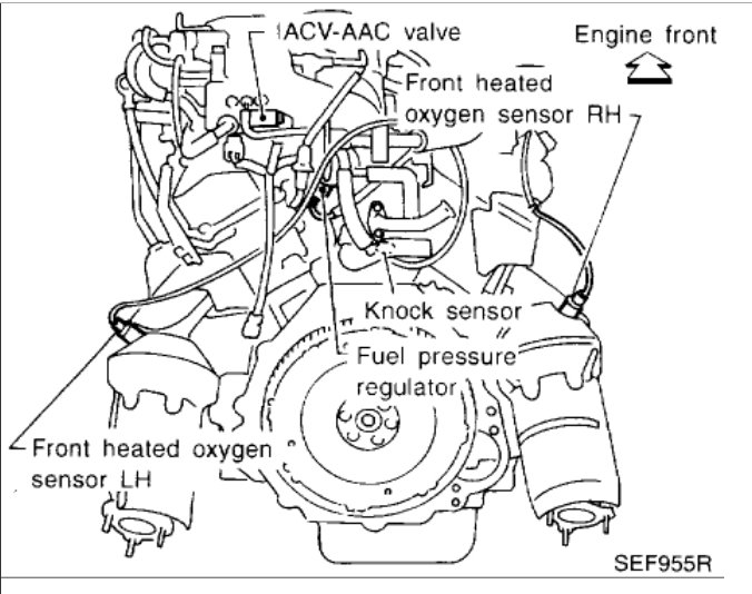

The knock sensor is located under the intake manifold between the cylinder heads. Here is the location
https://www.2carpros.com/forum/automotive_pictures/261618_Noname_1439.jpg
Here is a better view (below)
Cheers

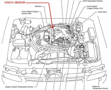

Knock Sensor On top rear of engine
https://www.2carpros.com/forum/automotive_pictures/12900_ks_27.jpg

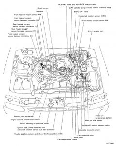

WMROCZKA
  • 1998 NISSAN PATHFINDER
1998 Nissan Pathfinder 6 cyl Four Wheel Drive Automatic

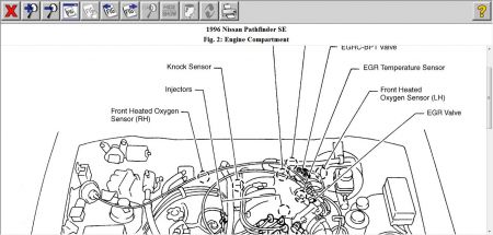

I am getting fault code for knock sensor failure.
The Haynes manual says it is located under intake plenum. I have removed it and cannot find any sensors under it or wires going to any sensors.
Where else could it be located?
Thursday, May 23rd, 2019 AT 5:42 PM (Merged)
  • 75,992 POSTS
Knock Sensor
ECCS Component Parts Location
https://www.2carpros.com/forum/automotive_pictures/12900_k_3.gif
https://www.2carpros.com/forum/automotive_pictures/12900_k1_1.gif
Engine Control Component Part Location
https://www.2carpros.com/forum/automotive_pictures/12900_k2_1.jpg
