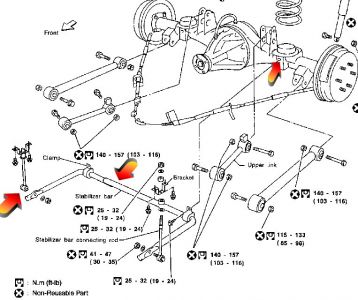

1996 Nissan Pathfinder 158k miles
My car has a pitch from side to side, sometimes violently, when in a turn. I changed the rear shocks but it didn't fix the problem. Are there additional shock absorbers on the truck that minimize the pitch and roll of the truck? Is it a problem that requires a certified tech? I need help.

HAs this been an on going problem or just recently developed? 4WD? REar sway bar on it? Get a look at the rear sway bar and it's mounting points. including the links.
https://images.2carpros.com/forum/automotive_pictures/30961_ypat4_1.jpg
