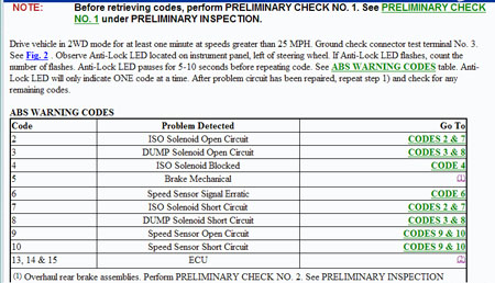

Hi, I got this old pathfinder still running strong, but ABS doesn't work in winter.
I noticed when changing brakes that there is a little nipple on top of the caliper (above fliud bleed nut). Is that for the ABS pump hose or sensor?
--Where do I find parts for ABS components other than dealer? ebay has nothing, online car parts stores have nothing?
--Where is the ABS control module computer that controls the ABS sensors and pumps on wheels?
--Need a working used/new brake master cylinder if anyone got one for 4WD 4disc brake for 90-95 VG30E pathfinders? $20?

If the ABS light is flashing count the flashes, this chart shows the problems
https://images.2carpros.com/forum/automotive_pictures/62217_ABS_2.jpg
