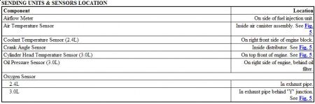

where is the cts ( coolant temperature sensor) located ---NOT the engine temperature sensor--
