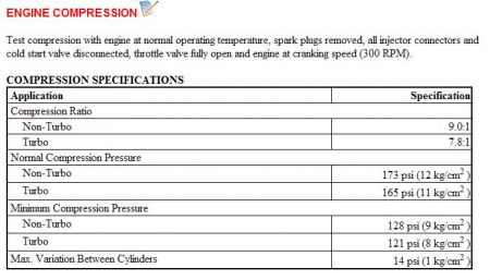

what is the normal engine compression for the 1987 Nissan Pathfinder?

https://images.2carpros.com/forum/automotive_pictures/261618_Noname_182.jpg
