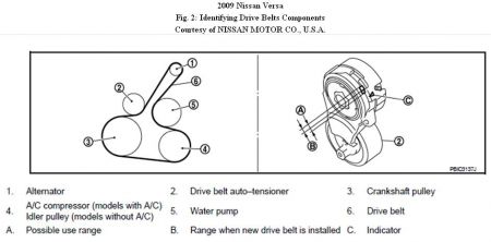

09 versa going to 30000 mi, getting ready for drive belt change. This is my first car, could you provide a step-to-step instruction to change the drive belt please.

Hi OneWidz, Item #2 is the Auto tensioner with a hex nut jutting out. Turn it clockwise to release the tension on the drive belt to enable removing it.
