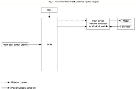

can you help me please? The front windows on my car go down spontaneously when no one is around. I will park the car, go into a store and when I come out both front windows are down. It happens at random once or twice a month. I have had it in 3 times to the dealer but the have never seen it happen and say they can't fix it.
How can I convince the dealer and what can I do to diagnose the cause of the problem.
This is a serious problem, I can't leave the car outside due to the possibility of bad weather and I am always at risk of having something stolen from inside the car.
Thank you

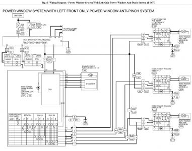

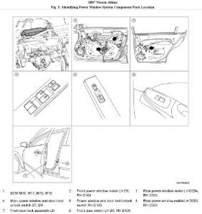

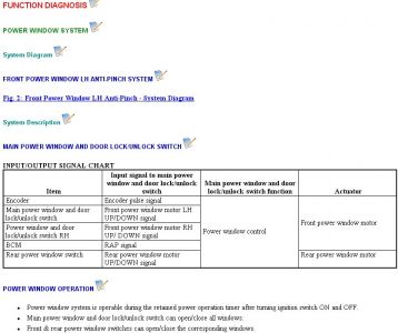

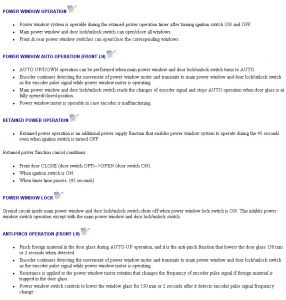

I don't know that the auto down is the thing to go after...I'm not sure what model we are working with...maybe all the nissan are the same. What model do we have? The is based on the Altima:
