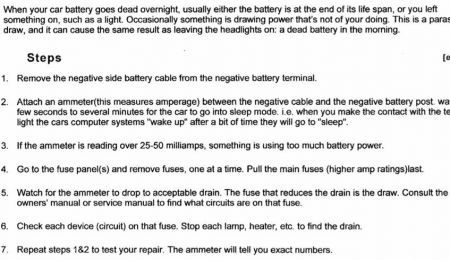

Hi I got a very old Nissan 1400 bakkie and there is a problem with the battery. It dies everyday after use. Its like it is leaking through the wires. We have replaced the battery alot of times but the problem keeps coming back. In the morning I have to jumpstart it to get it working using cables between cars and when I come back home and park the car in the garage and go to sleep the next morning its dead again and needs to be jumpstarted again. Can anyone tell me how I can either fix the wires myself or which wires needs to be connected correctly? Thanks and goodbye

Battery drain test-see below:
https://images.2carpros.com/forum/automotive_pictures/12900_pd_5.jpg
