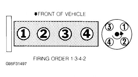

I just replace the module of my distributor (nissan primera 1600cc). But now the engine performance has diminished.There is little acceleration. The contact indicator is also not working. Can someone help me to know the problem.

Did you re-time the distributor? I hope you have GA16 or SR20 motor. I don't have info for the other engine variations.
Dec 17, 2008 at 3:49 PM
STAUKOORDASS
its a SR-20 engine. i dont think i have re-time the distributor. can you please help me? thanks
Dec 17, 2008 at 4:56 PM
ZACKMAN
  • 4,202 POSTS
You do have to time SR20. You have to have a timing light to do this procedure. Your timing marks is on the crankshaft pulley. IGNITION TIMING 1. Start engine and warm to normal operating temperature. Turn ignition off. Disconnect throttle position sensor harness connector. 2. Start engine. Increase engine speed to 2000 RPM, 2 or 3 times, then allow engine to return to idle. Engine should be operating smoothly at correct idle RPM.
https://images.2carpros.com/forum/automotive_pictures/55316_sr20firing_1.jpg
3. If ignition timing is incorrect, loosen hold-down bolt and turn distributor to adjust ignition timing. Turn ignition off and connect throttle position sensor harness connector. Recheck ignition timing. IGNITION TIMING (Degrees BTDC @ RPM) Application Man. Trans. 2.0L 13-17 @ 700-800
