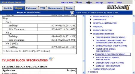

pliz can som 1 tell piston ring gap and con rod bearing torque for Ca16s engine.m overhauling ca16s,hav bought standard piston rings horn the cylinders.pliz help

Conn. Rod torque- 23-27ft lbs Ring end gap see below
https://images.2carpros.com/forum/automotive_pictures/12900_rings_end_gap_1.jpg
