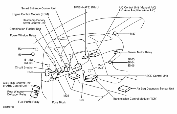

My 2000 Maxima's power door locks, keyless entry, rear window defroster, and interior dome lights all stopped working the same time. I checked all the fuses under the drivers side fuse panel but all the fuses are good. Is their maybe a main fuse or relay for all these items and where can I find it.

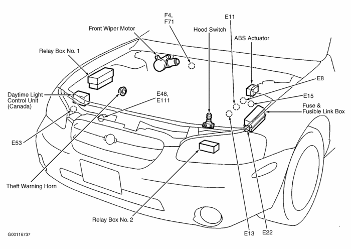

I have attached images showing all of the circuit protection devices for your vehicle. Check relays, fuses, and fusible links.

Have it scanned for Body Control Module fault codes. These are soft codes, as they don't affect emissions or engine performance at all. Also check the fuses and/or relays for the affected circuits.
