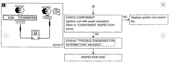

Good afternoon,
There were so many issues with these systems that all were related to grounds. The main issue was the negative battery cable gets corroded internally and cause coil failures. there resolution was to replace the cable and all the coils.
You also need to verify voltage at all the coils as well.
A scope would be a big advantage as you could see the signals to the coils.
I attached a flow chart and wiring harness diagram for you to view of the system.
