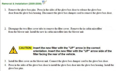

how do i change the cabin airfilter on my 06 nissan maxima

https://images.2carpros.com/forum/automotive_pictures/261618_Noname_968.jpg
