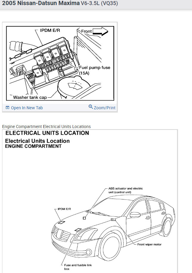

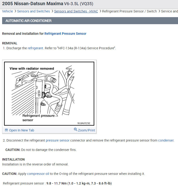

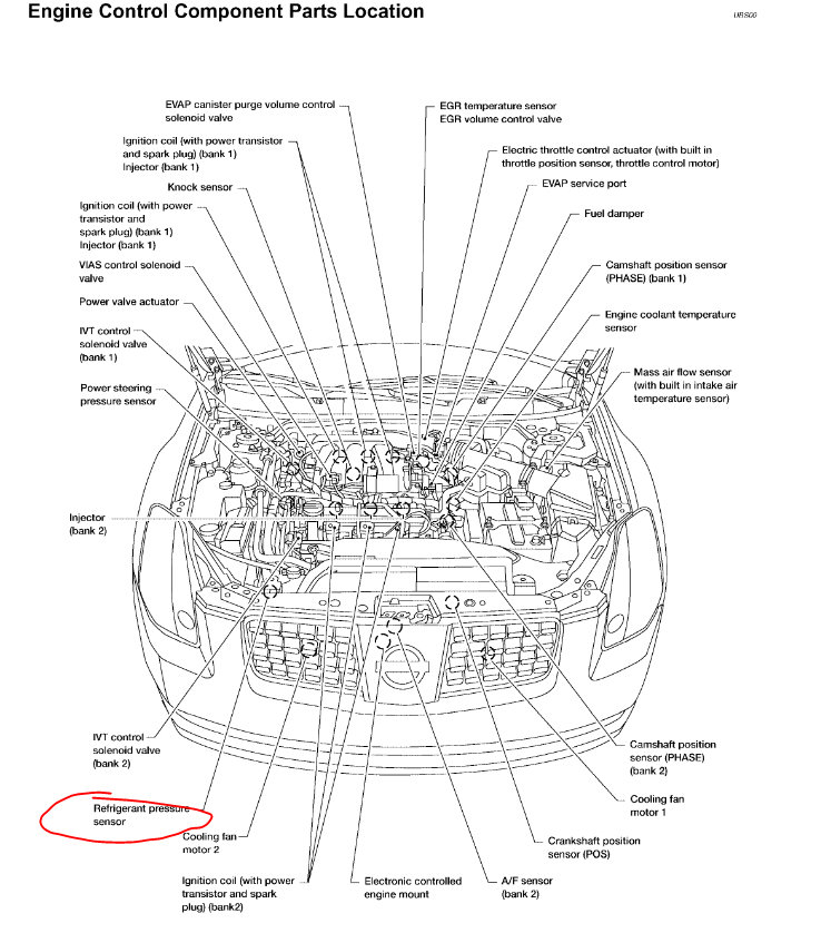

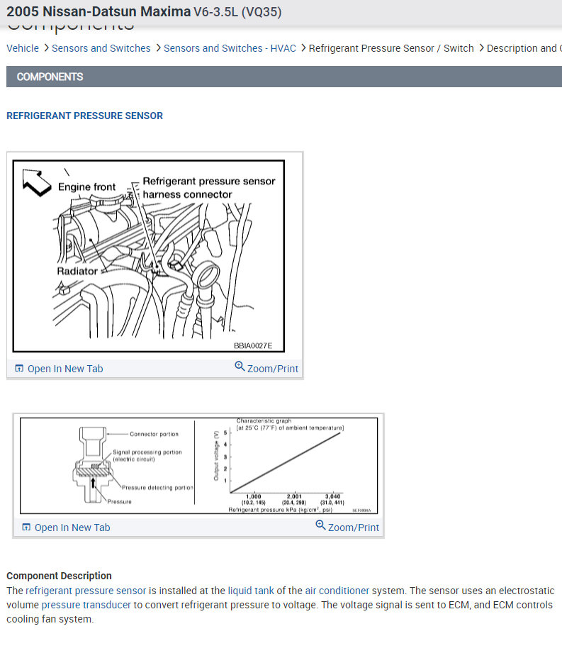

This vehicle has a pressure sensor for the refrigerant. It detects the refrigerant level for the A/C system. If that sensor is bad then it will prevent the compressor from coming on.
That sensor is located on the upper part of the condenser (see diagram).
Another possibility is the AC clutch relay being bad. That relay control the clutch and is located under the hood fuse box (IPDM) on the passenger side of the engine compartment.
Check the relay for corrosion or burnt pin.
You can also test the relay.
