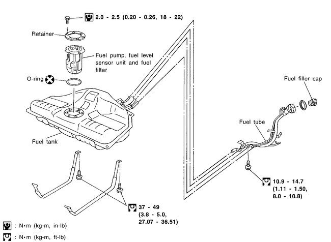

A mechanic recently told me that I need to do something about my fuel filter, he said it could be cleaned out. Is it ok just to clean it out or should it be replaced? The car sometimes doesn't want to start and I have to try a few times before it actually does start.
Apr 23, 2019 at 10:11 AM (Merged)
ZACKMAN
  • 4,202 POSTS

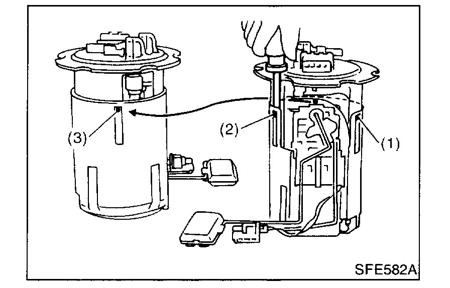

You don't have a replaceable fuel filter. All you have is a fuel strainer inside your gas tank.
STEVE W.
  • 15,348 POSTS
There is a filter built into the pump, however the description sounds more like a failing pump as a filter would act differently. It's not that hard to replace as there is an access panel to the pump under the back seat. Remove the seat then the cover, release the fuel lines and disconnect the wiring. Remove the screws and lift out the pump. Be careful of the fuel level sender and it's float. Then remove the filter from the pump. Reverse the process to install the replacement. However if you are doing all this because the car sometimes doesn't start you would likely be better off replacing the entire pump. Especially if it has a lot of miles on it. Don't go cheap on a replacement as many of the aftermarket units don't seem to last.
