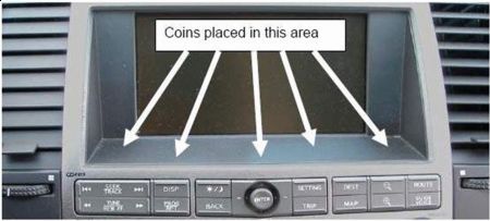

When the gas tank was full one day, I replaced the car battery. Everything works perfect except radio stations mixed up.
Later I discovered that :
1- The fuel gauge indicator, when the car is off, is pointing down at the other side of the stop pin! When turn the car on, the fuel gauge indicator makes an clockwise small turnn and hits the stop pin and stops there! It is just looks that it has passed the pin and got stock there.
2- Sun roof does not work. I have checked all the fuses inside the car fuse box, all of them ar OK. Are there any other fuses somewhere else that I have to check?
I will be glad if you answer me.
Noel

i dont know if you did this, but worth a shot. Also there is another bulliten about PCM grounds needing to be cleand and reattached, and the cross brace for the steering column. MAXIMA; GAUGES / HVAC / WARNING LIGHTS DO NOT WORK CORRECTLY TECHNICAL SERVICE BULLETIN Reference Number(s): NTB07-043,  Date of Issue:   June 15, 2007 Related Ref Number(s): NTB07-043 ARTICLE BEGINNING IF YOU CONFIRM Any of the symptoms below:  Gauges do not work correctly.  Dash warning / indicator lights do not work correctly.  Heater and air conditioner controls do not work correctly. AND The customer has / does place coins on the area in front of the Unified Meter and A/C Amp. Display Screen (see Fig. 1 below). Fig. 1: View Of Coin Area Courtesy of NISSAN MOTOR CO., U.S.A. Coins may have fallen down past the screen and into the A/C Auto Amp. ACTION If you can hear coins rattling inside the A/C Auto. Amp., replace the A/C Auto Amp. with the one from the Parts Information section of this bulletin. If you cannot hear coins rattling inside the A/C Auto Amp., this bulletin does not apply. Return to ASIST and the ESM for further diagnostic information. NISSAN: 2004-2006 Maxima Classification: EL07-021 APPLIED VEHICLE: 2004-2006 Maxima (A34)
