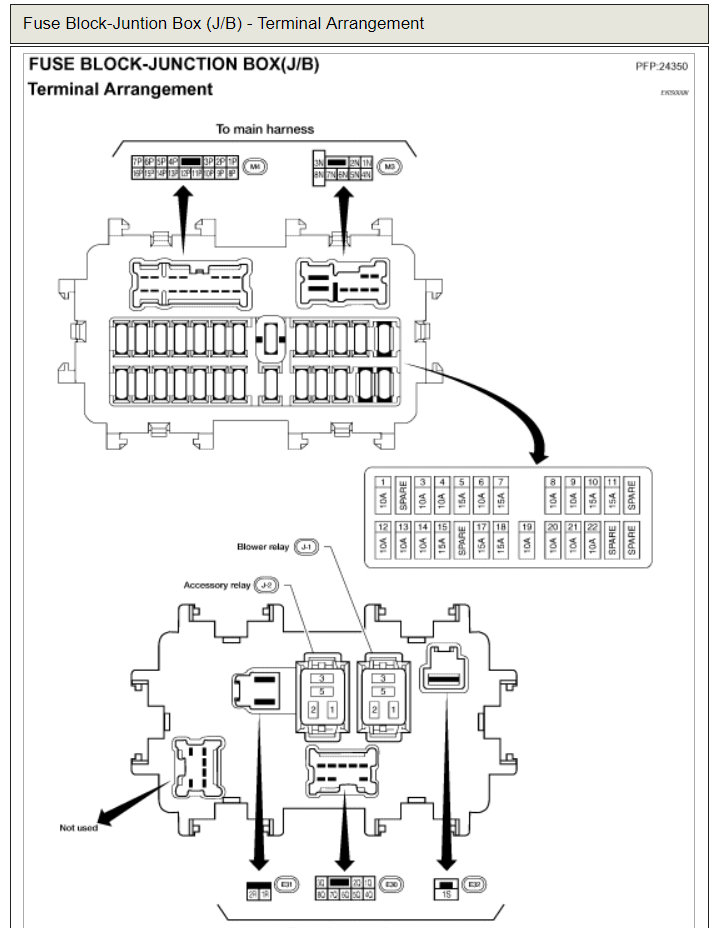

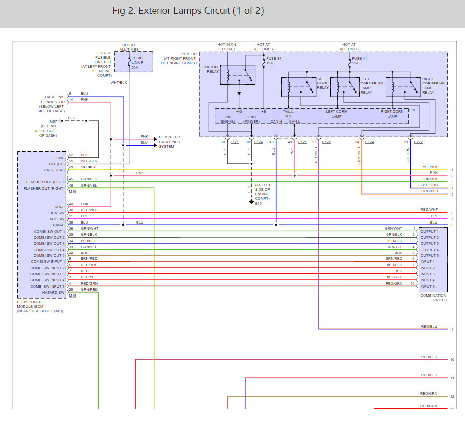

I have no tail lights. I tested the wiring going to the lights and there is no juice. What do i do now. Where should i look for the fuses or fuse box for my tail lights. I have brake lights, hazards, and blinkers just no tail lights.
Oct 12, 2010 at 9:00 AM
  • 55,224 POSTS

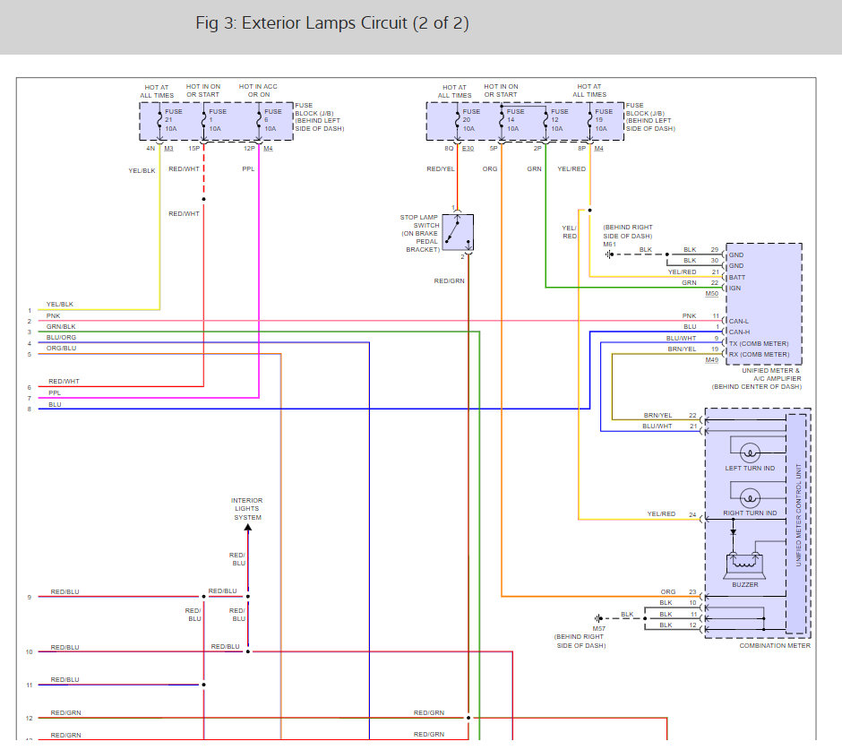

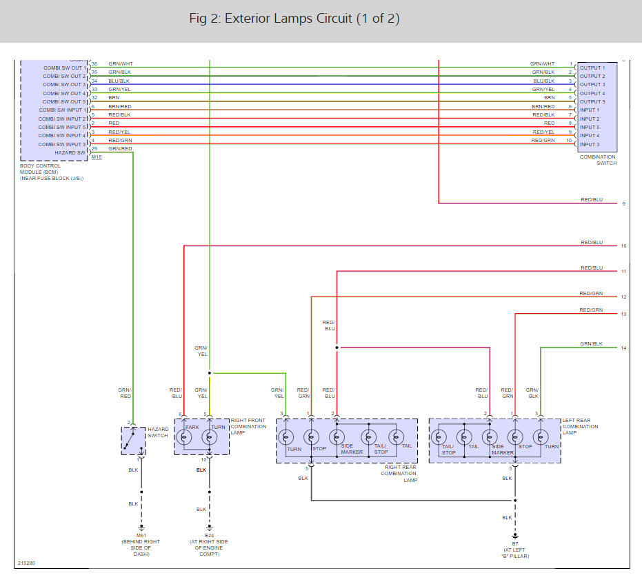

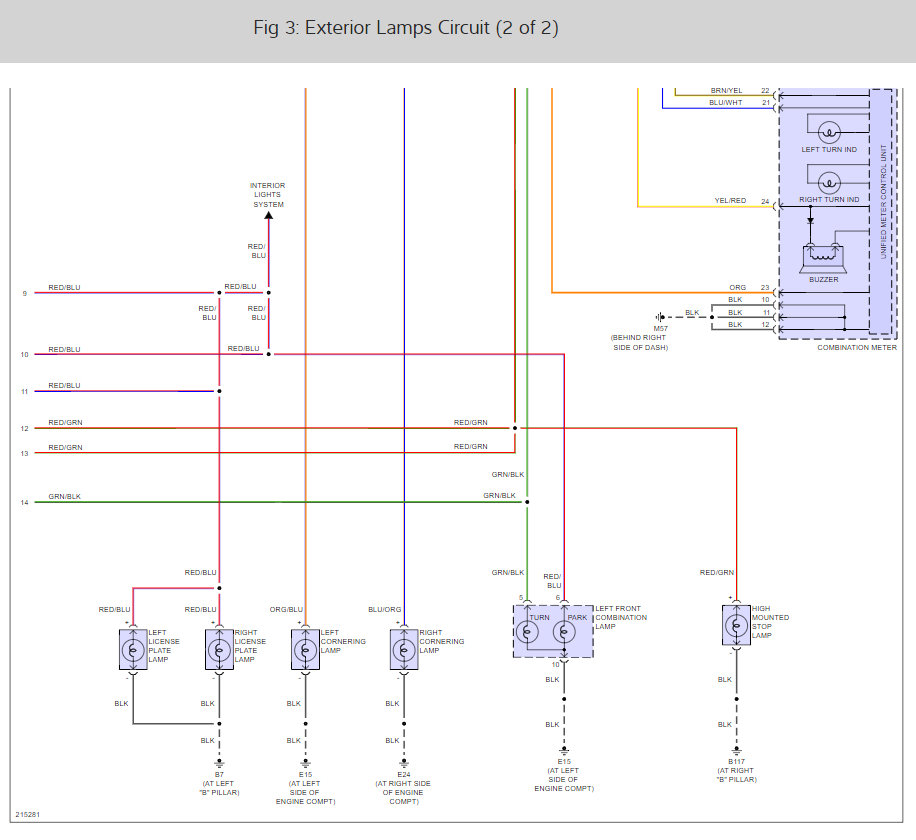

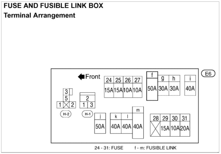

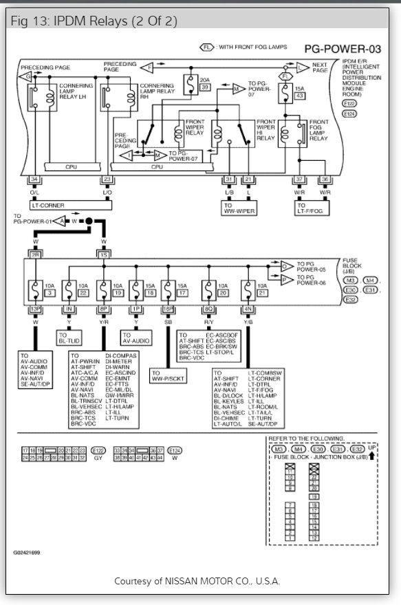

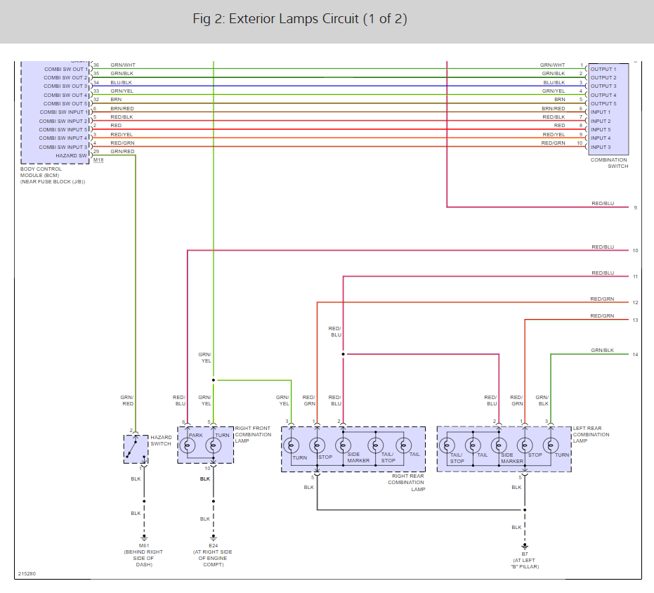

There are two fuses and one relay that runs the system. Here is a guide to help you check the fuse numbers #34 and 41.
and to check the tail light relay
See where you are losing power here is the tail light wiring diagrams and the fuse panel locations and diagrams (below)

if it keeps blowing fuses then there may be ashort in teh wiring harness and will have to be checked for that

I would start by removing all of the lights to see if any have shorted internally. Here is a guide that will help you.
