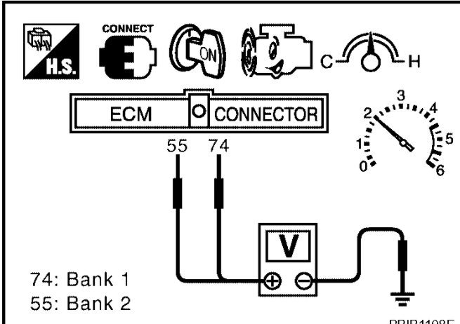

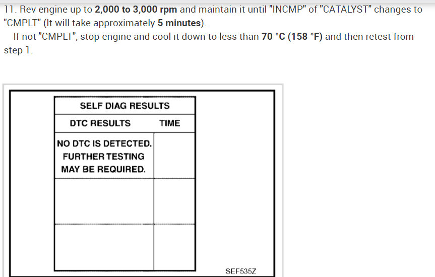

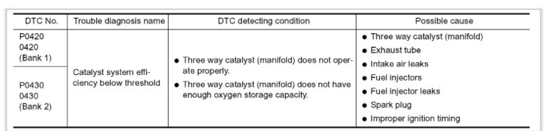

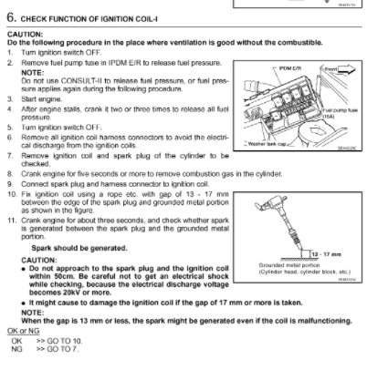

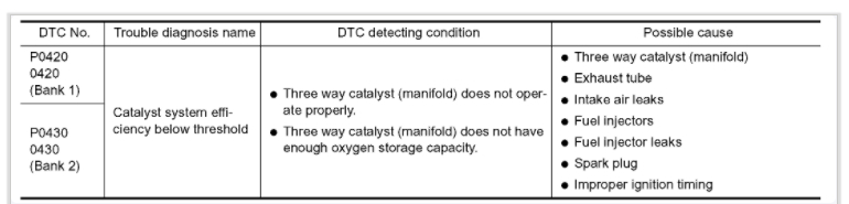

I have the car listed above and check engine light came on. checked with the scanner and and code p0420 show.
May 24, 2010 at 10:11 AM
DANNY L
  • 5,648 POSTS
Hello, I'm Danny.

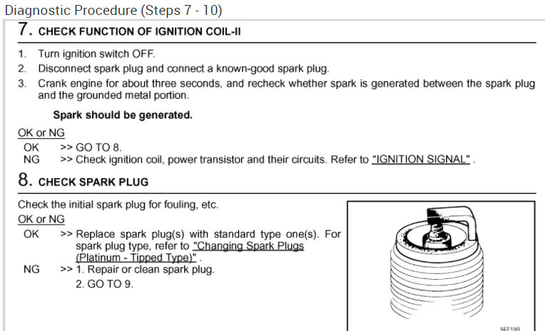

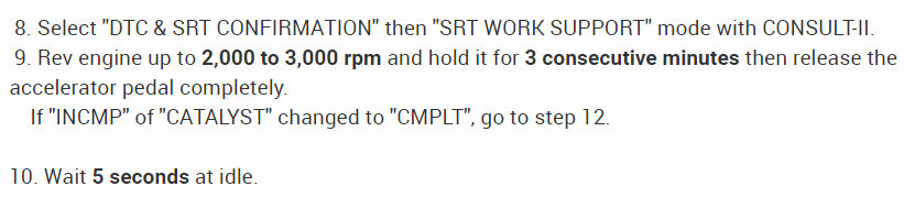

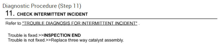

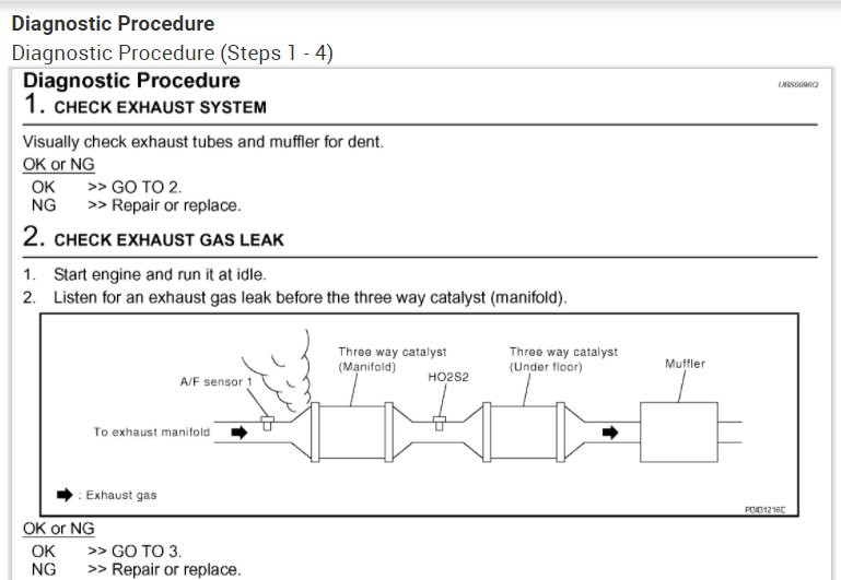

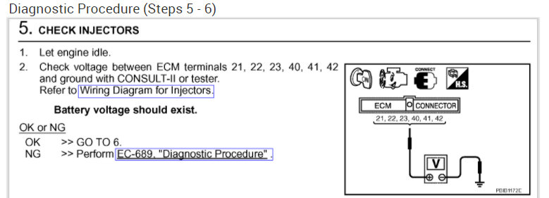

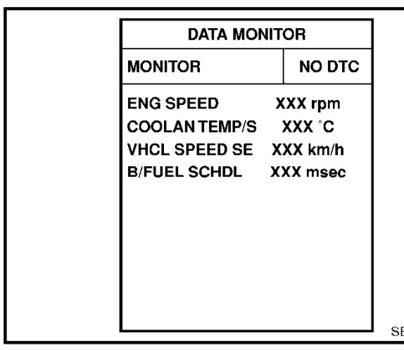

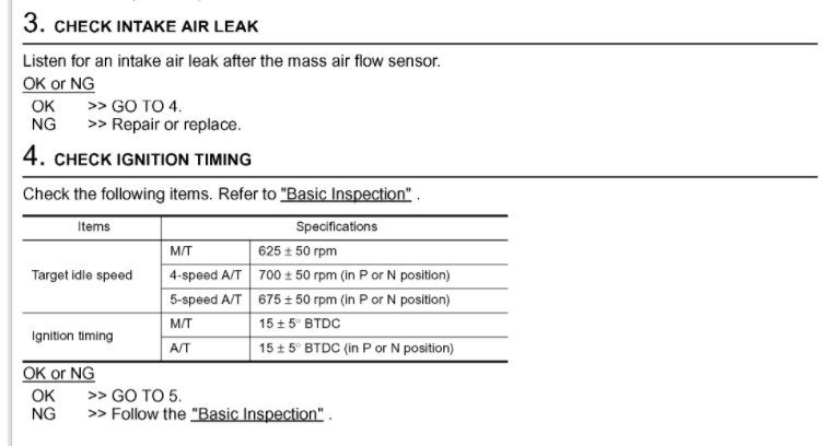

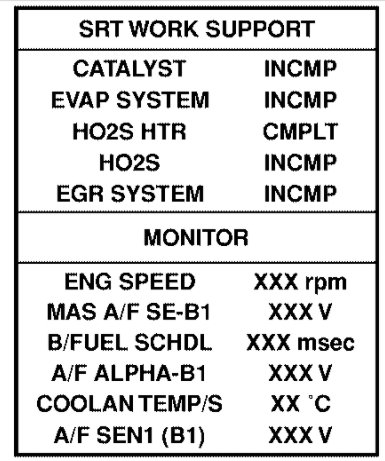

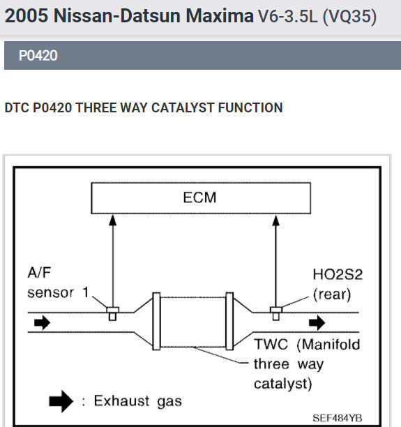

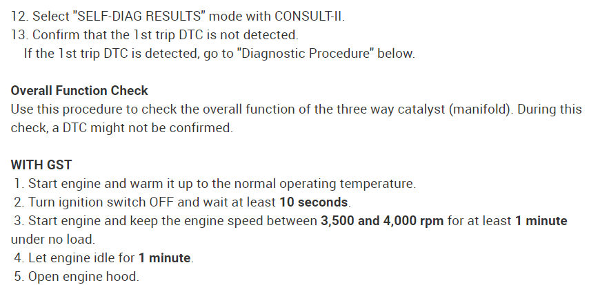

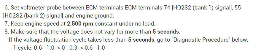

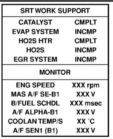

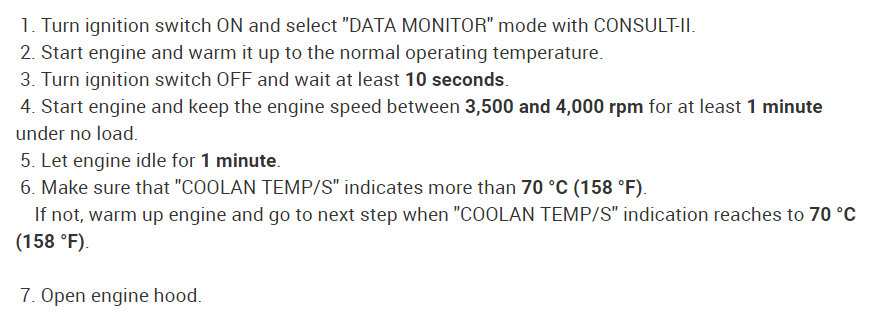

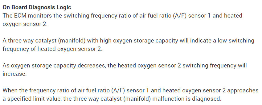

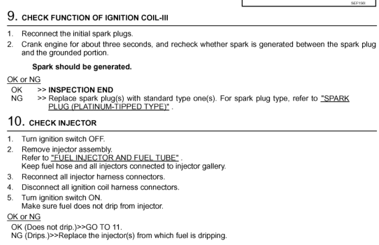

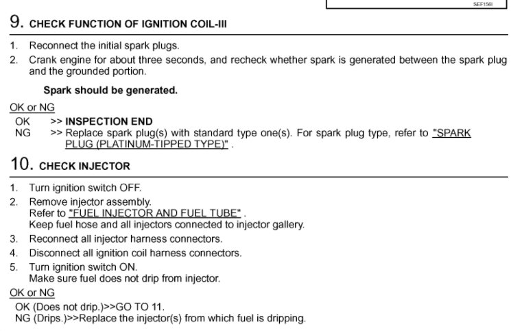

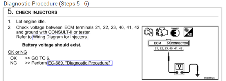

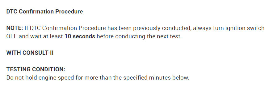

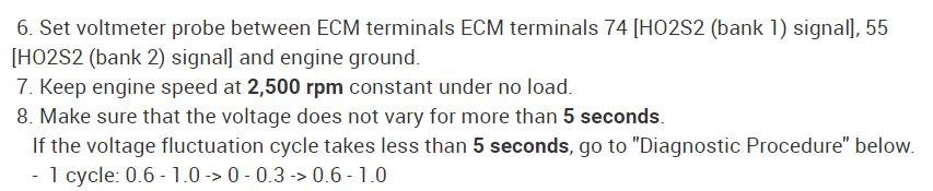

That code is for your bank 1 catalytic converter being deficient or performing below threshold. Here are a few tutorials for you to view about function, testing, and replacement of catalytic converters:
https://www.2carpros.com/articles/catalytic-converter-replacement
I've attached picture diagnostic steps below for your car for you to test before just replacing. Hope this helps and thanks for using 2CarPros.
