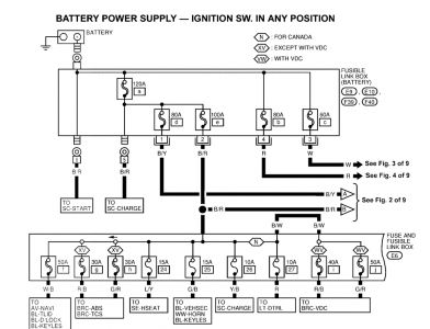

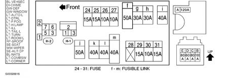

My rear running lights no not come on. I have checked all the bulbs and cannot find the fuse for the rear running lights.
Oct 1, 2010 at 4:42 AM
MERLIN2021
  • 17,250 POSTS
It's a 50 amp fusible link under the hood in the fusible link box, first one on the left.
