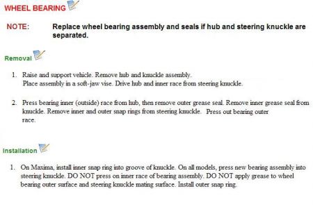

The right front wheel is very loose. I think it is a bearing. How do you change this?
Oct 1, 2009 at 12:57 PM
BLUELIGHTNIN6
Experienced Mechanic
16,542 POSTS
Oct 1, 2009 at 4:09 PM
