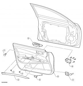

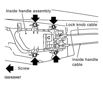

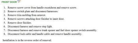

I accidentally dropped my debit card into my drivers side door through the window slot. How do I take the interior door panel off to retrieve my debit card?
