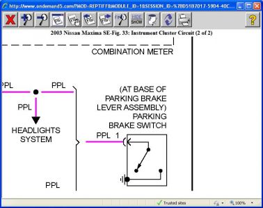

I am installing an aftermarket radio with gps and i am supposed to clip a wire onto the parking break power wire.
The only problem is i know know with color it is. So my question is what is the power wire to the parking break?

First of all thank you very much for your donation.It must be a safety device trigger because they don't want you programing a new location on the gps while you are driving.That's what i have seen on the factory one's some sort of fail safe to not allow you to put in a new trip while you are driving.On yours you must have to have the ebrake on to put a new trip in the gps.

You didn't say you knew what the wire was for going from the gps to the parking brake you said The only problem is i know know with color it is. So my question is what is the power wire to the parking break?That sound's to me like you were asking what the wire was for going from the gps to the ebrake i did read the question and i tried to answer it.I'm sorry i wasn't on the same page as you if you would have said the blank color wire to the parking brake goes where? So i can bypass the safety feature the gps company put in so i can change my trip without having the ebrake on i could have given you a better answer.If you would have been clearer in your response back to me rather then try to tell me how i was wrong answering your question and what i should have said then you could have actually gotten a good answer you could use.I posted a partial wire diagram to show you where the wire's go the purple wire is the turn on for the ebrake dash light when it's grounded thru the switch.So if you want to bypass having to have the ebrake on then ground that wire that goes to the ebrake.Everyone has a bad day no hard feeling now you have your answer and you can say you got a useful answer from 2carpros.Thank you for using 2carpros.

I've never heard of this being called a "power" wire for the parking brake. The incorrect terminology would throw anyone off course. Permanently grounding that wire will leave the light on the dash turned on all the time the ignition switch is turned on. If the light is shared with the low fluid level switch, (if the car uses one), and the pressure-differential switch, he will defeat those circuits and never know if a problem develops. Insurance investigators just love to find these kinds of do-it-yourself modifications even if it wasn't a contributing factor to a fire or to a crash that was the other guy's fault. It leaves a jury wondering what other things the owner might have screwed up. No professional would risk his job and reputation by permanently grounding that wire and no shop owner would condone such practices. To add to the confusion, while you cared enough to answer, Matt obviously didn't care enough to proof read his first post or to clarify the question in a follow-up post. To quote:
