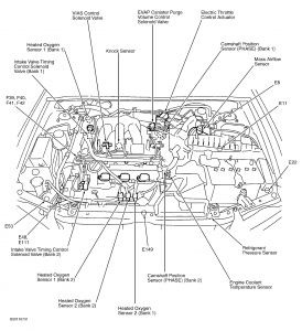

Our maxima has about 87000 miles has started clattering and the diagnostic indicated a ITC Valve the needs cleaning or replacement and, I think, cam shaft timing out of phase. How difficult is it to replace the ITC Vavle. I think that is the Intake Timing Control Valve.

Intake Valve Timing Control Solenoid Valve (Bank 1)On top front of right cylinder head. Intake Valve Timing Control Solenoid Valve (Bank 2)On top front of left cylinder head.

Component Inspection INTAKE VALVE TIMING CONTROL SOLENOID VALVE 1.Disconnect intake valve timing control solenoid valve harness connector.
https://images.2carpros.com/forum/automotive_pictures/12900_itc1_1.gif
https://images.2carpros.com/forum/automotive_pictures/12900_itc2_1.jpg
2.Check resistance between intake valve timing control solenoid valve terminals as shown. https://www.2carpros.com/kpages/auto_repair_manuals_alldata.htm
