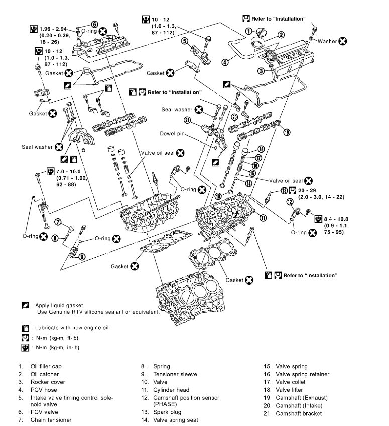

How would I go about repairing this I use mobile 1 synthectic oil and have done numerous oilchanges with the clicking still persistant. had my state in spection today and they told me that it was probably the lifter just wanted to know if there is a way to repiar this with out taking it to the shop if at all possible.
