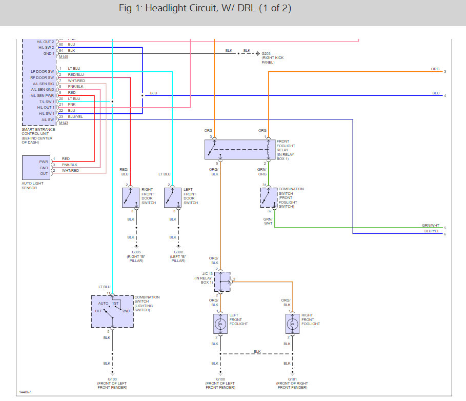

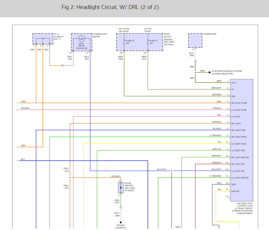

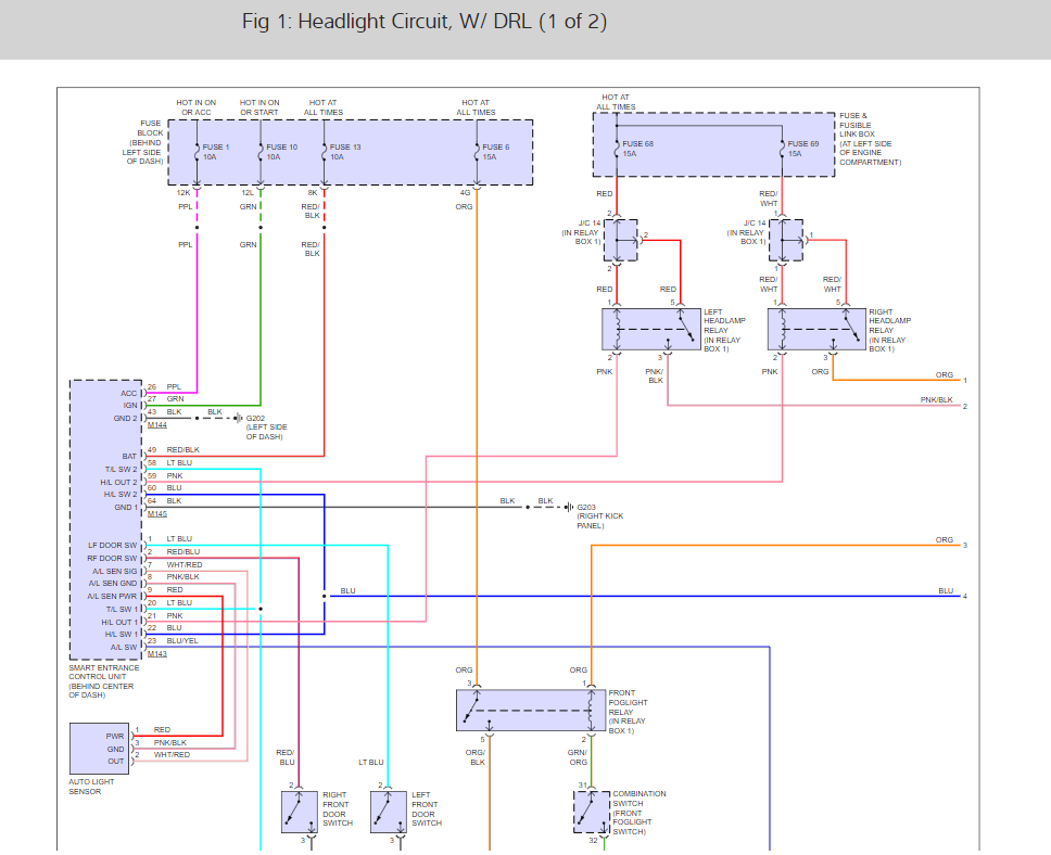

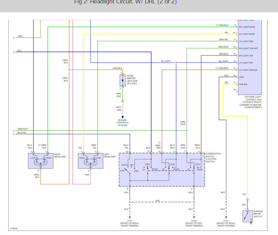

The low beam on both headlights suddenly went out at the same time. The relay checked out. What else could it be?
Apr 8, 2009 at 1:24 PM
YASGER
  • 83 POSTS
There is a smart entrance controller that sounds like it went out but to be sure here is a guide and the wiring diagrams for the halights so you can see how the system works.
Check out the diagrams (Below). Please let us know what you find.
Cheers
Apr 10, 2009 at 6:01 AM
JENNIFERC43
Thanks for this post I had the same problem had to get a new entrance controller, mine had water damage. All fixed I love this site.
