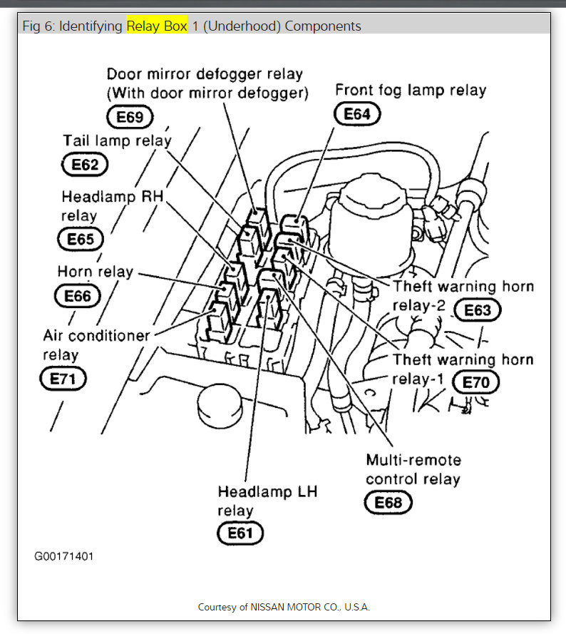

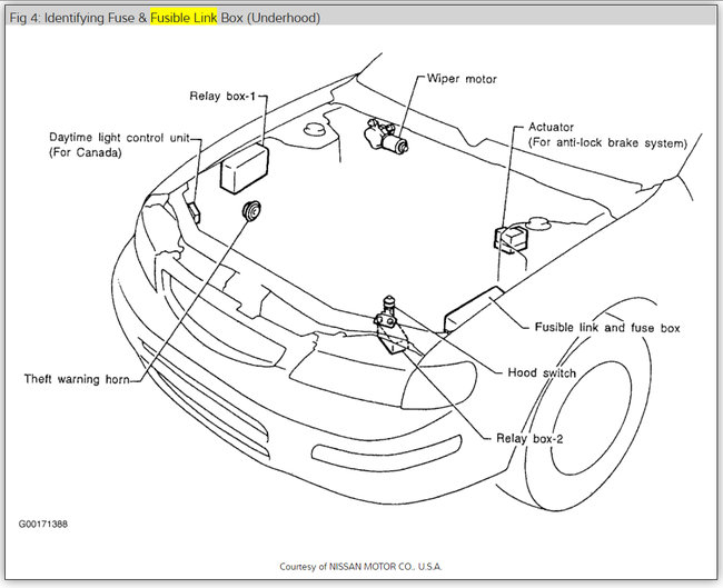

Electrical problem 6 cyl Front Wheel Drive Automatic 95,000 miles

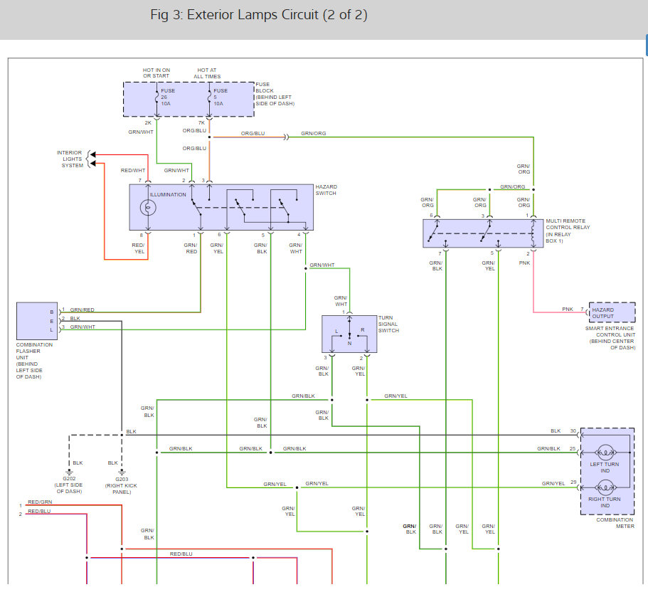

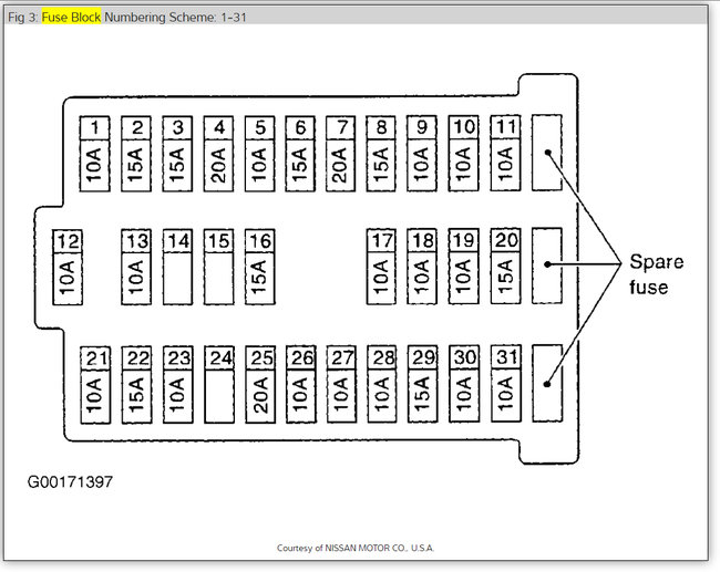

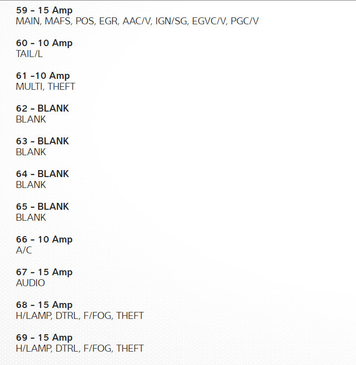

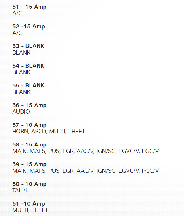

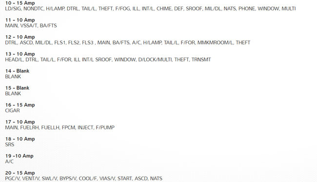

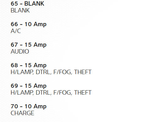

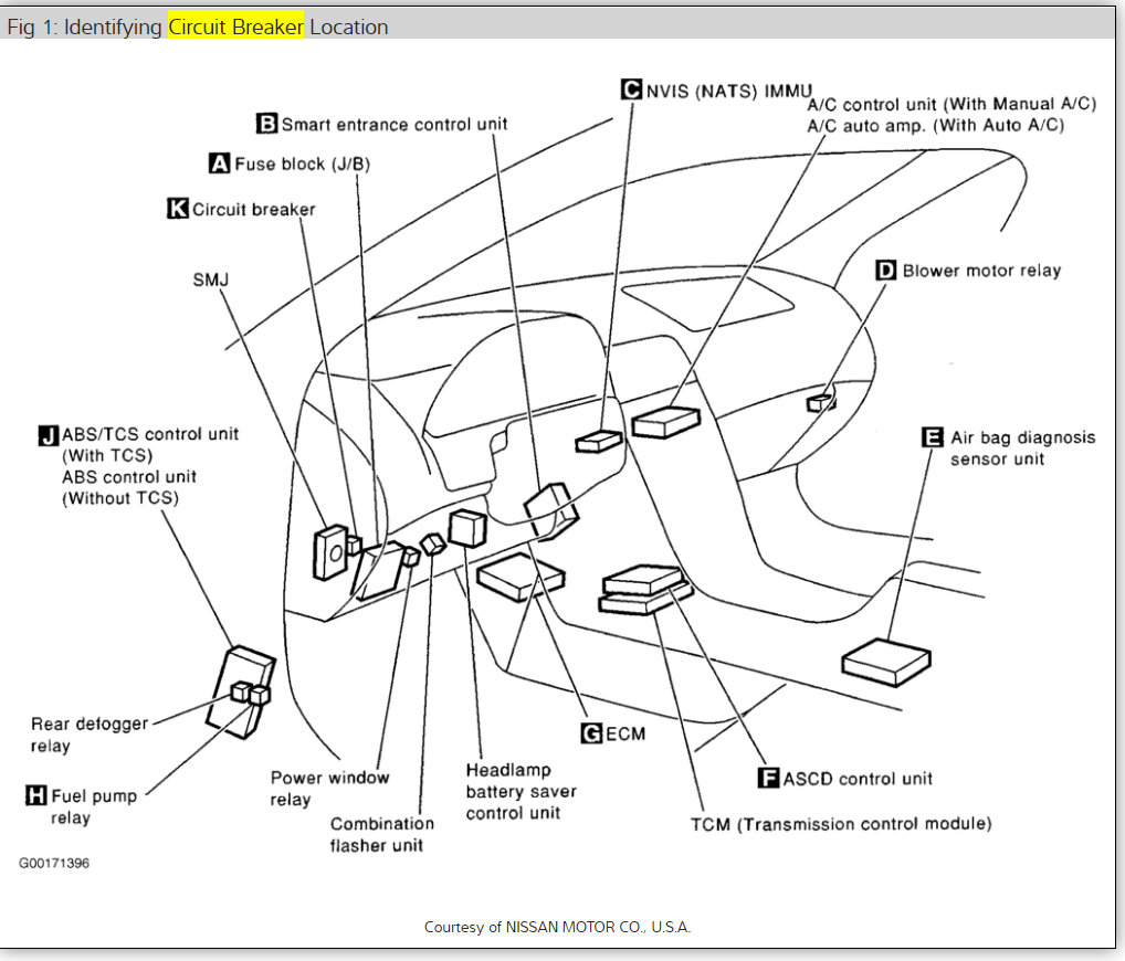

About two days ago my turn signals quit working. The emergency flasher does not work at all (press the button, no lights). When I try the turn signals, I do not get either the green arrow lights inside or the clicking sound. I have checked the fuses, and have not found a bad one. I can turn on the running lights and the headlights and they are both fine. Any ideas?
Jun 10, 2008 at 1:13 PM
  • 75,988 POSTS

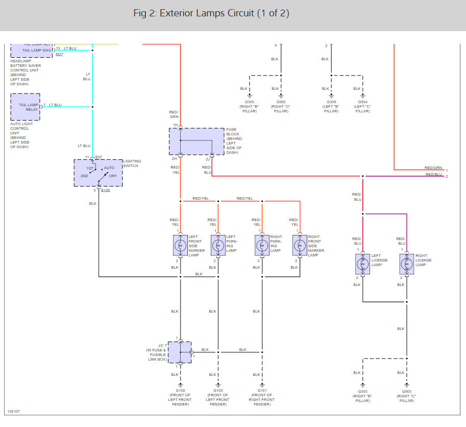

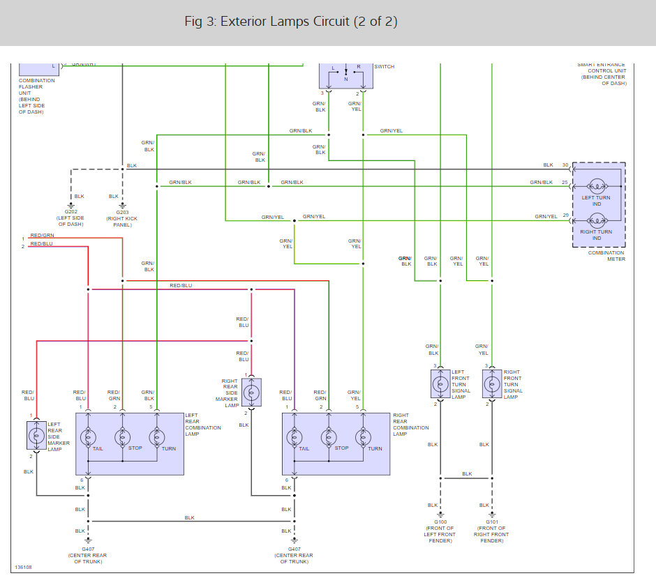

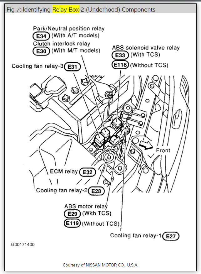

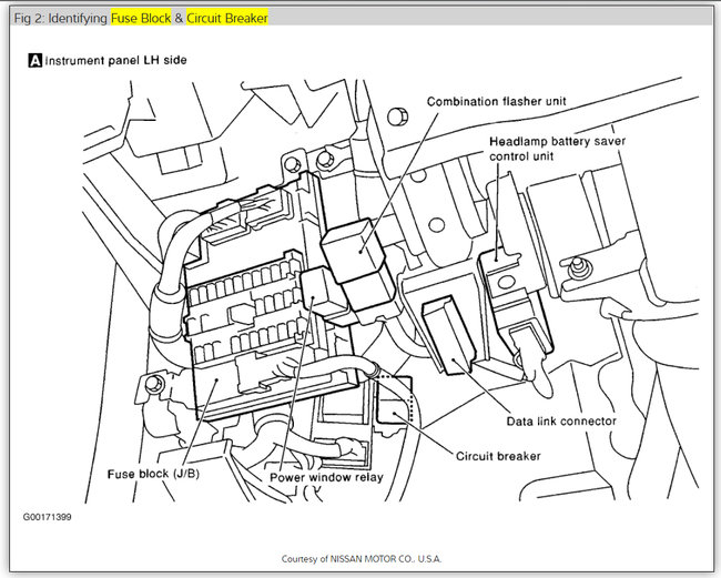

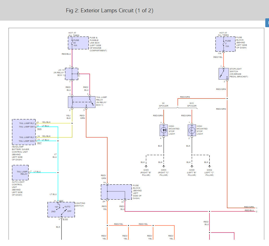

Yep there is a fuse and relay that runs the system. Here is the tail light wiring and the location of the flasher unit with a test guide to help you see whats going on.
See where you are loosing power.
Cheers
Jun 10, 2008 at 9:34 PM
GSMITCHELL
Yep it was the tail light relay thankful for the guided it was easy to follow and I did the repair myself first time ever! I love this site I cant believe it is free.
