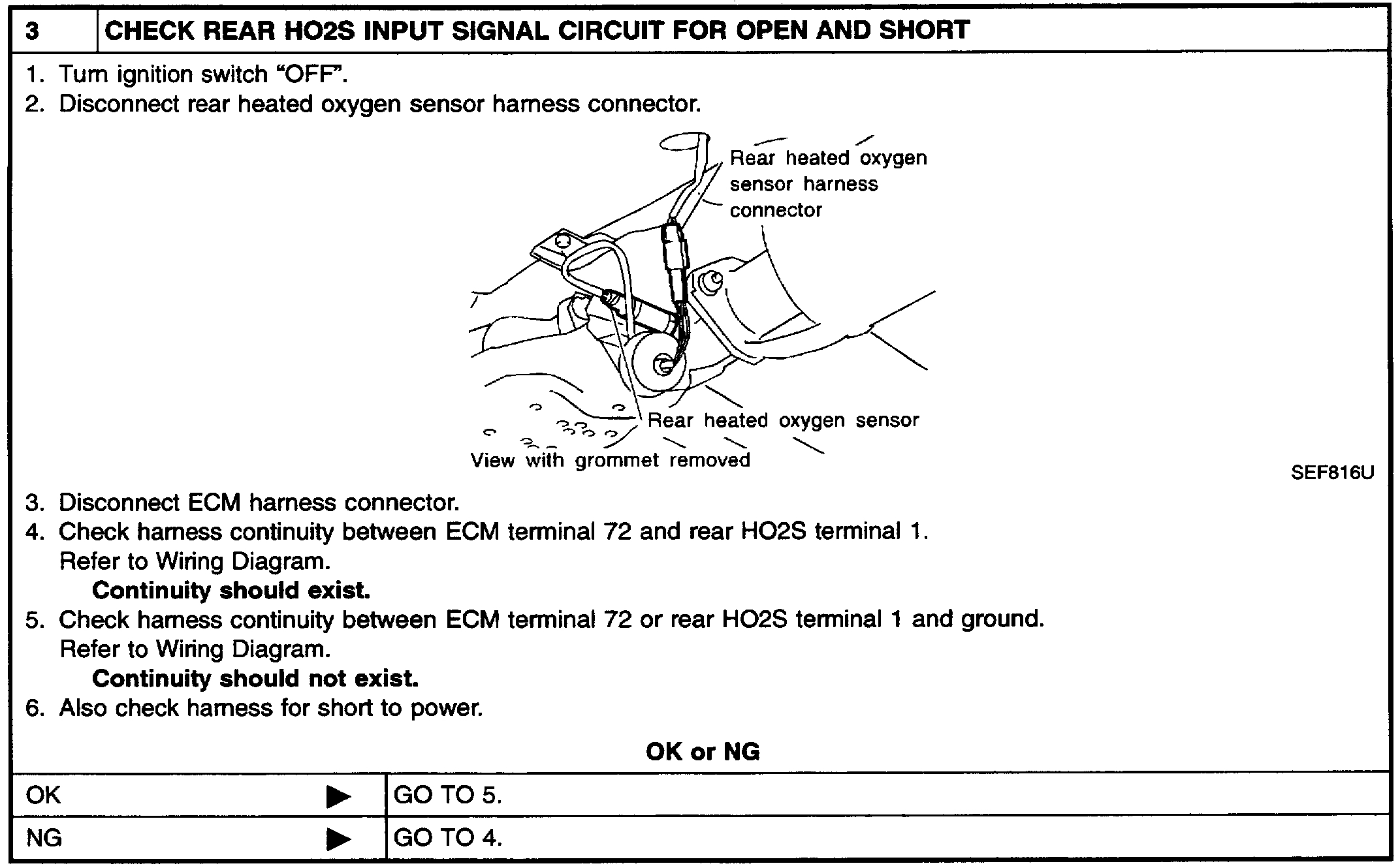

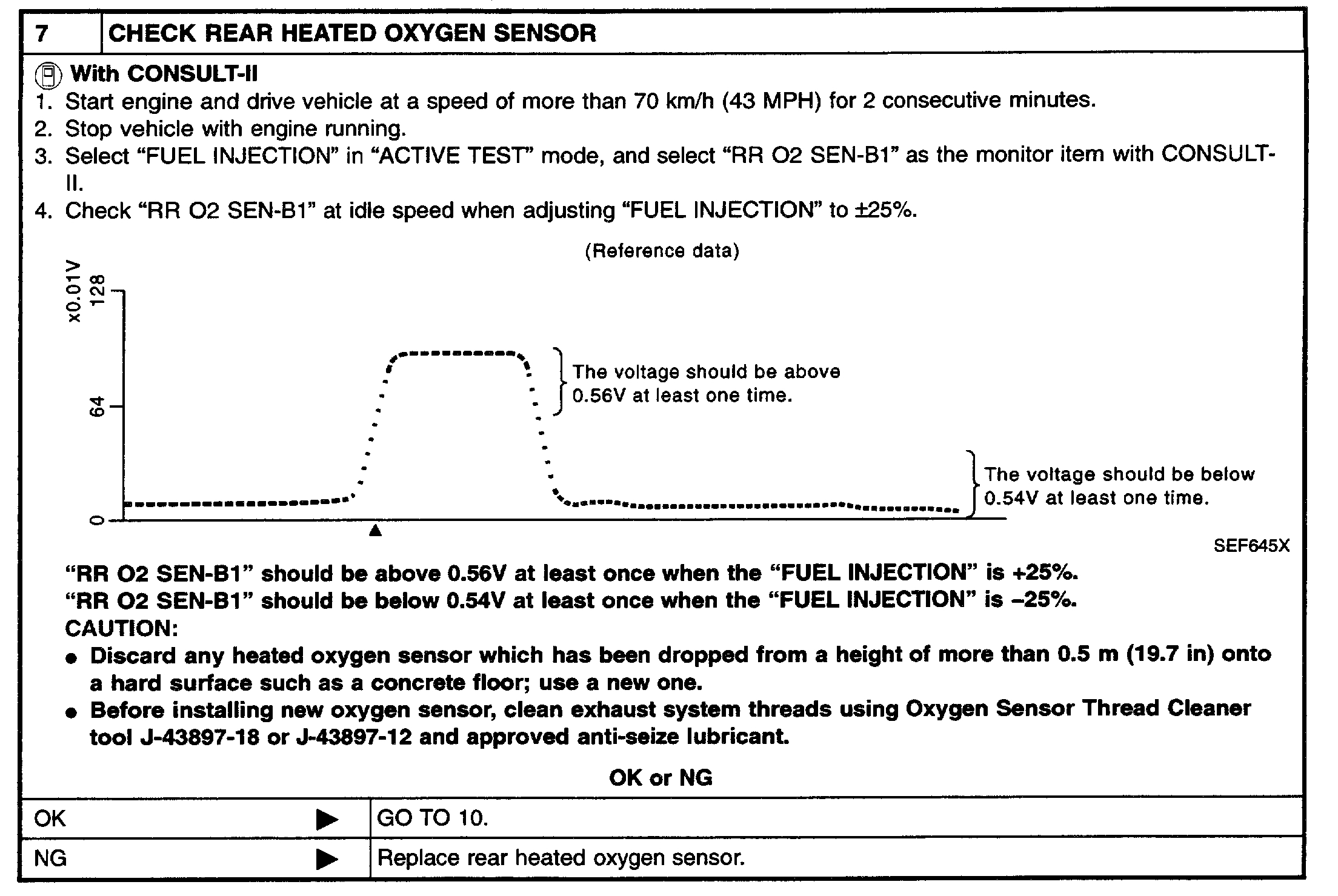

My car for some reason seems to have very little or no power at all when the rpm's get above 3,500. It screams all the way to 6,000 rpm's but the entire time it goes through that range the car doesn't seem to go faster at all. When you get on it from a complete stop it will put your head back and you can feel its power but if you are just cruising and then floor it, it will drop down a gear but does not seem to go any faster. Sometimes it also shifts gears extremely hard. Also the service engine soon light stays on and i have plugged a code reader into it that says P0138- o2 sensor ckt slow response (bank 1, sensor 2) and P0138- o2 sensor circuit high volts (bank 1, sensor 2) From my own research people with similar issues with this car have suggesting cleaning and/or replacing the mass air flow sensor and that replacing the o2 sensors did not solve the problem.
Jul 27, 2009 at 6:14 AM
  • 110,244 POSTS

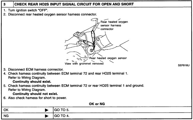

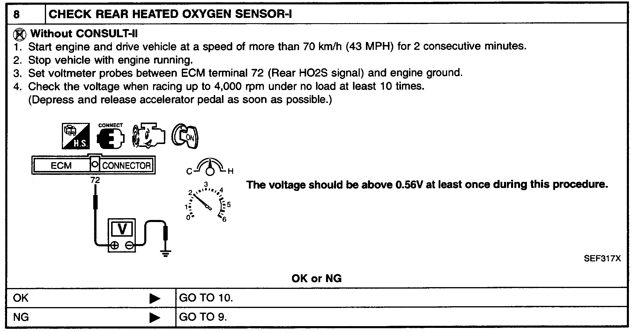

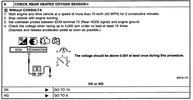

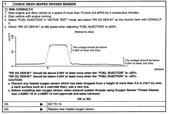

The code you have pertains to the heated oxygen sensor (sensor 2) which is post cat. What I suspect may be happening is the vehicle isn't controlling the air fuel mixture properly which can cause a power loss.
There are a few things that can cause this code to present itself. For example, a harness or connector issue, the sensor circuit is shorted or open, the sensor is bad, fuel pressure, injector issues, even intake engine vacuum leaks.
If you look at the attached directions and pics, I provided the diagnostics for this issue. To determine the cause, this is what will need performed.
___________________________________
Diagnostic Procedure
Diagnostic Procedure Step 1
pic 1

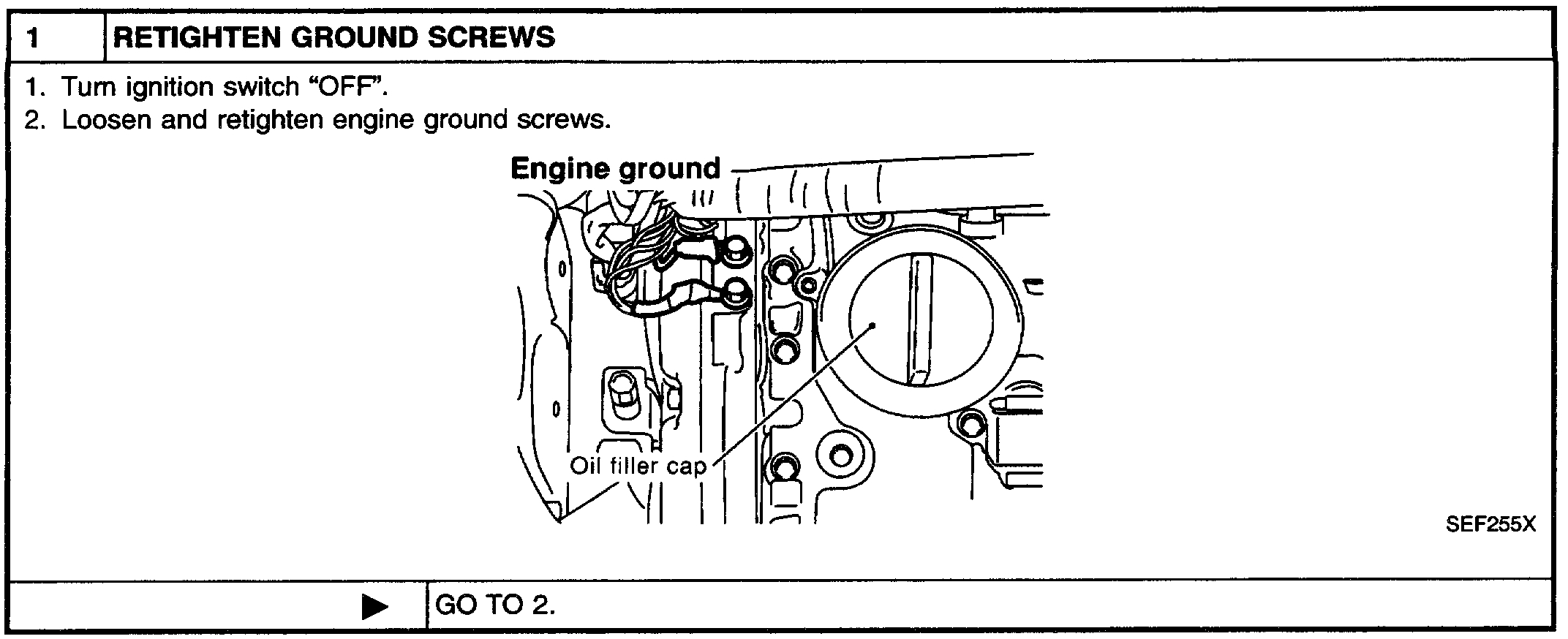

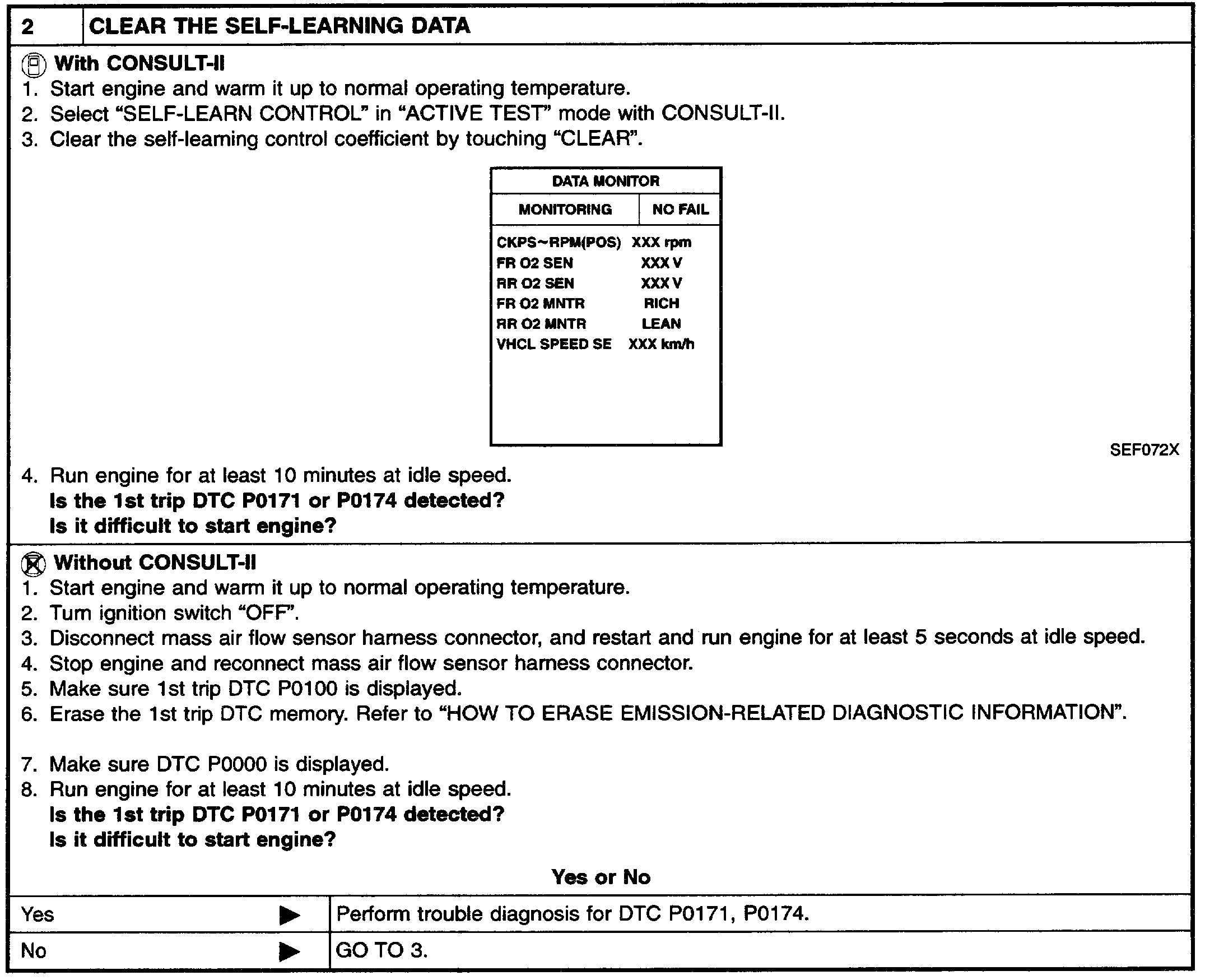

Diagnostic Procedure Step 2
pic 2
Diagnostic Procedure Step 3
pic 3

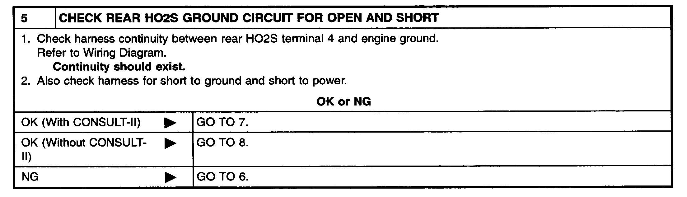

Diagnostic Procedure Step 4
pic 4

Diagnostic Procedure Step 6
pic 6

Aug 24, 2020 at 11:39 AM

Aug 25, 2020 at 1:07 PM
ROJAR
Hi Joe
Nissan have just resolved this fault. It turned out to be the Swirl Control Valve which was defective. They left it disconnected and the car is fine now.
Cheers,
Roger Hart
