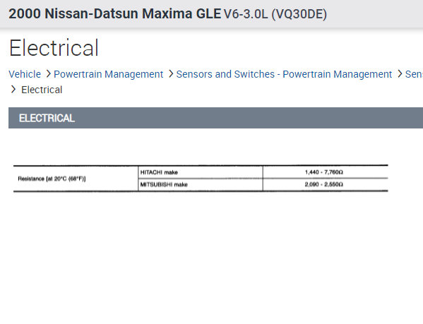

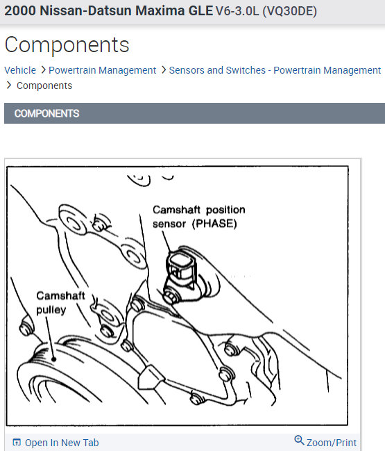

The car died and won't start. It doesn't seem to be getting any fire. I removed the cam position sensor and it checks shorted or zero ohms. Is that normal.
Aug 3, 2010 at 2:40 PM
SQM
  • CAR REPAIR CONTRIBUTOR
  • 6,383 POSTS
Depending on the brand of the sensor that is installed on your Maxima, the camshaft position sensor should have 1400-2000 ohm resistance.

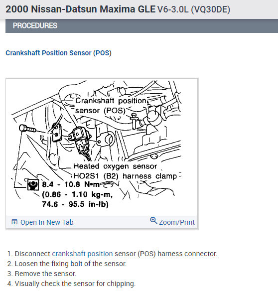

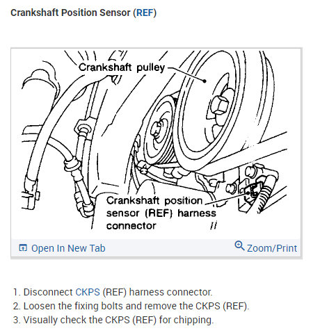

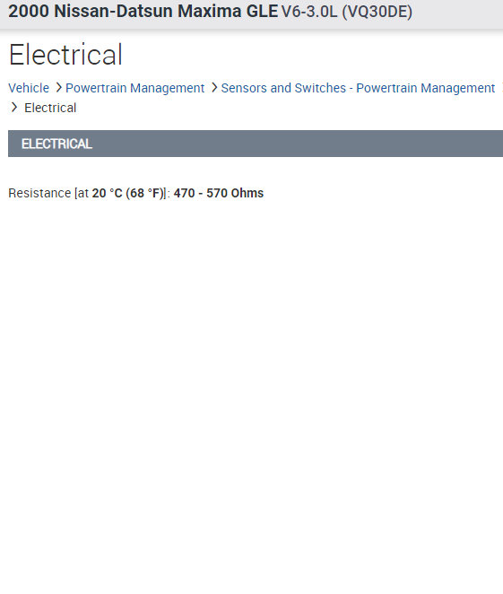

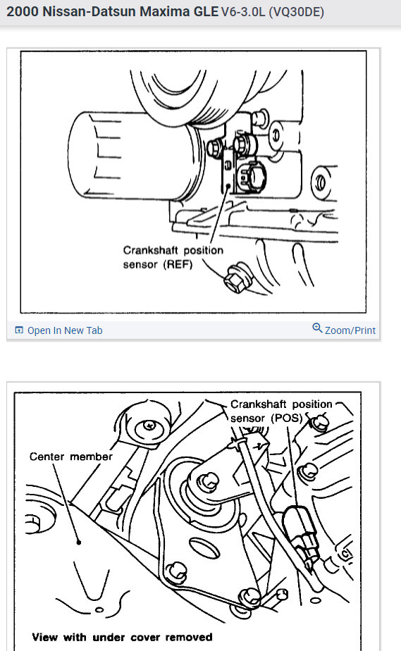

Keep in mind that typically on a no start situation it is more likely that the crank position sensor is the culprit.
