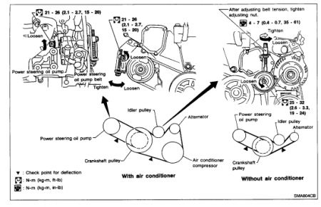

Engine Mechanical problem
2000 Nissan Maxima 6 cyl Automatic 90000K miles
WHAT IS INVOLVED IN CHANGING TH E TWO BELTS,
IS THERE A TENSIONER ON THE POWER STEERING BELT, IF SO HOW DO YOU ACCESS IT?

Please make sure in the future you include if your model is a GLE, GXE or SE. There are times there are differences. It appears on this particular question it doesn't matter. The bolt on the power steering tightens that belt, but you need to make sure the mounting bolts for the power steering pump are loose to allow it to move/tighten as you tighten the larger bolt in the picture.
https://www.2carpros.com/forum/automotive_pictures/248015_2000_Nissan_Maxima_Belt_1.jpg
