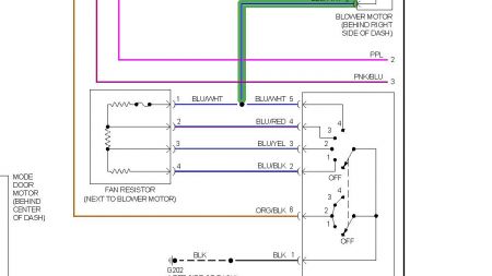

Please anyone help...... I have a 2000 nissan maxima and the climate control unit only works on highest position( number 4). I have replaced it with another one and it did the samething. It only worked on number 4 position. Can it be two bad units..

Sir You need to replace the fan blower motor resistor next to the motor The blower motor is located on the right side of dash
https://images.2carpros.com/forum/automotive_pictures/12900_blower_2_1.jpg
Need more help don't hesistate to ask
