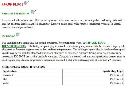

I want to change the spark plugs on the rear head near the firewall. Can thos plugs be removed from below and behind the engine with the car on a lift, without removing the intake > Does the intake have to be removed to replace thos 3 rear plugs ? These are the 100K Platinum plugs whicfh do not have to be changed very often.

Hello Thanks for the donation. Below are instructions for replacement of your spark plugs.
https://images.2carpros.com/forum/automotive_pictures/261618_Noname_90.jpg
