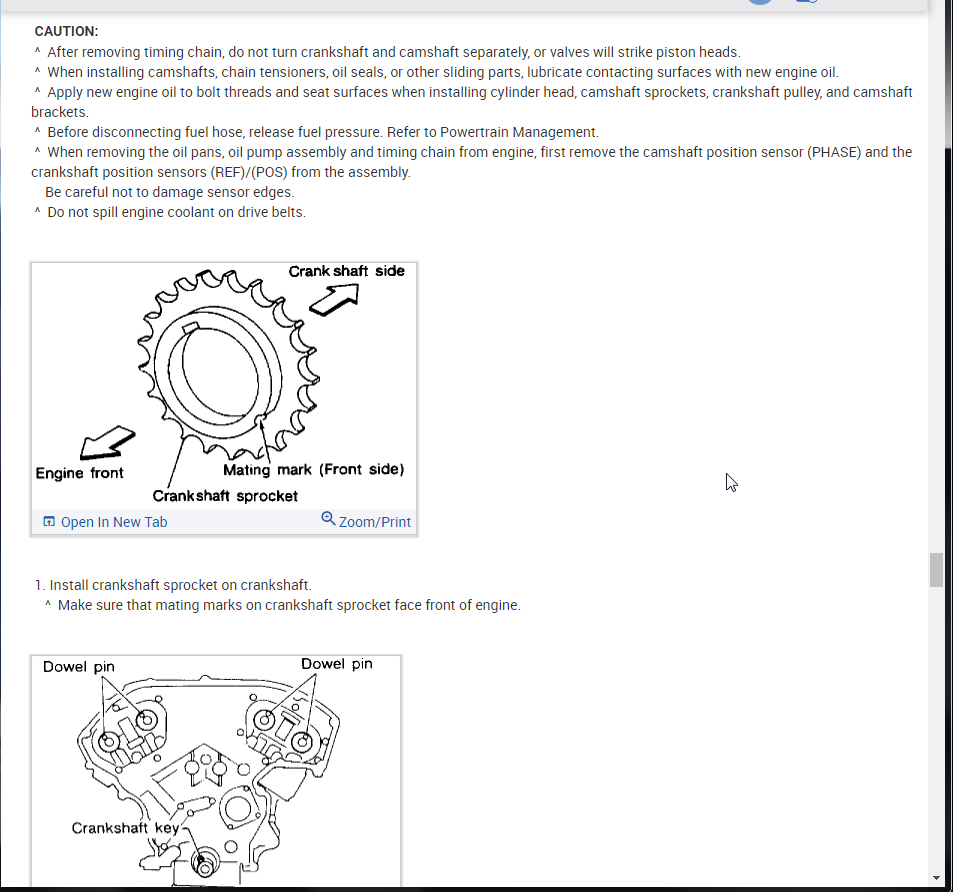

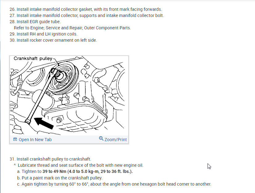

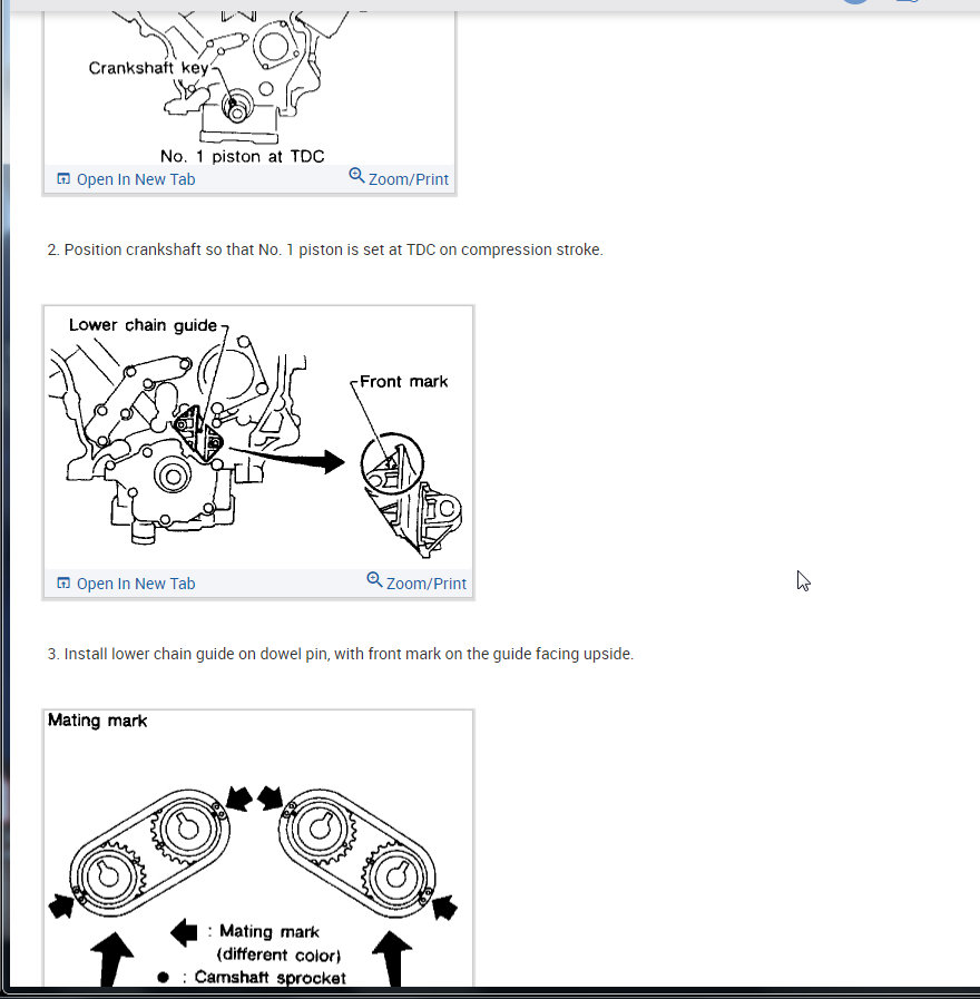

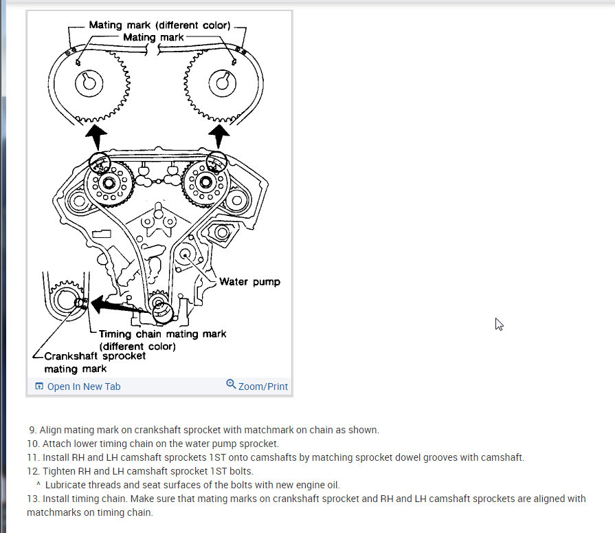

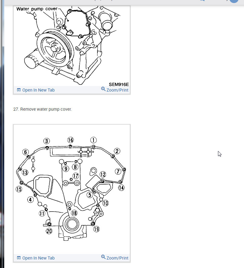

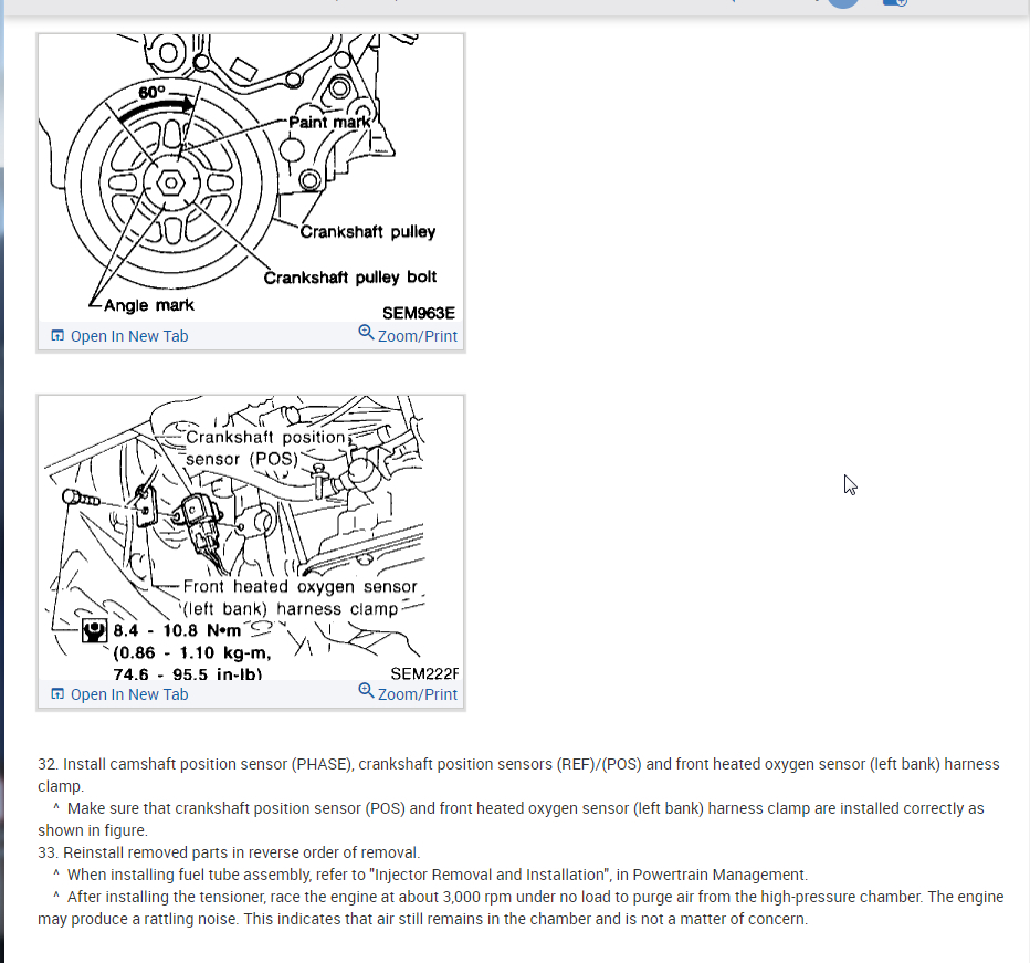

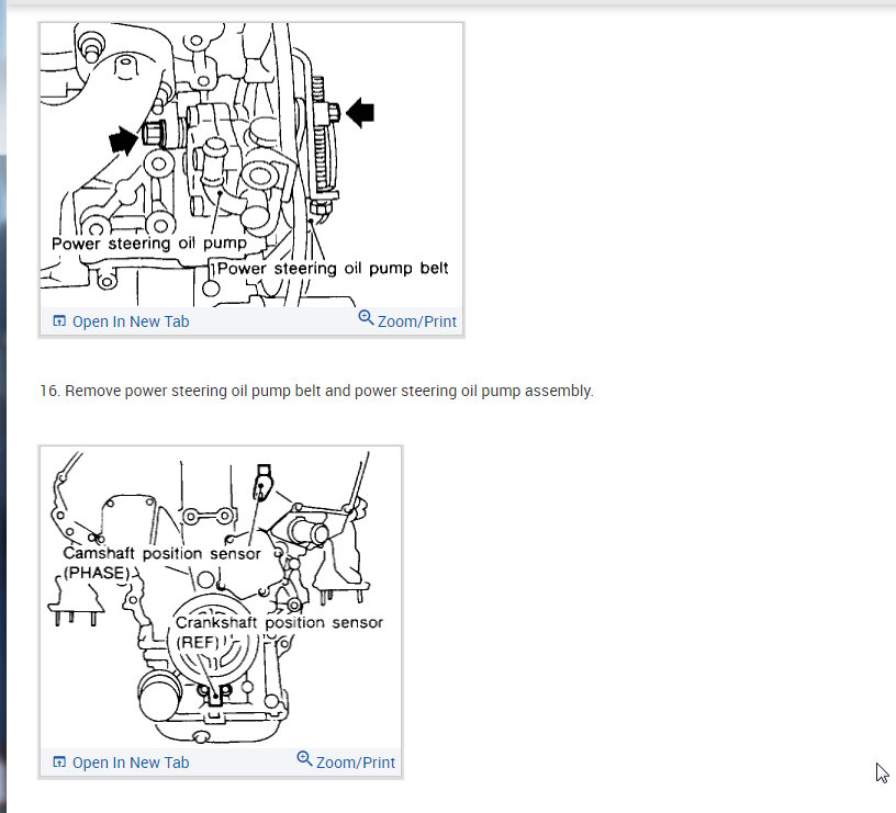

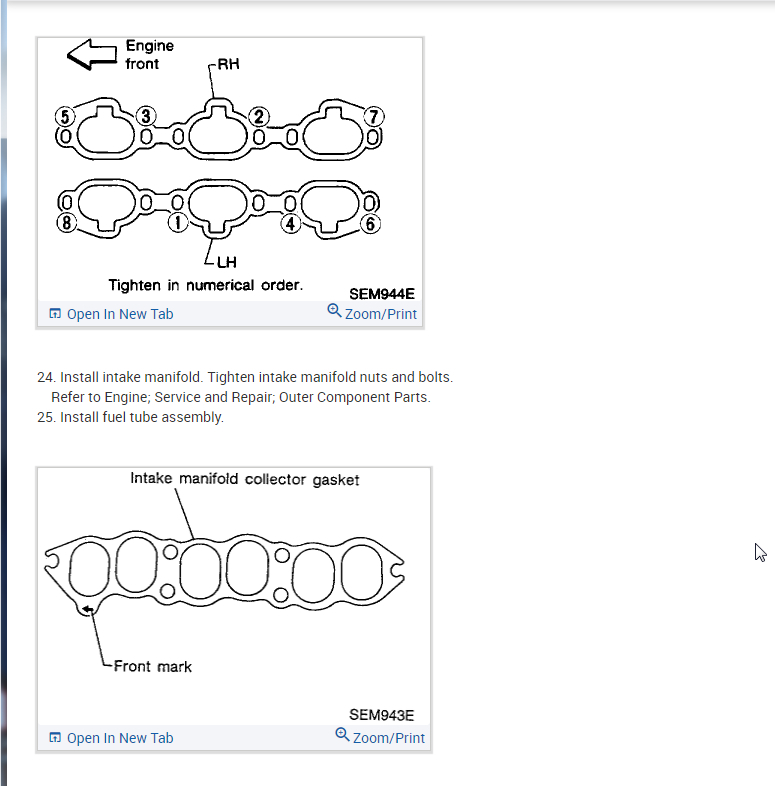

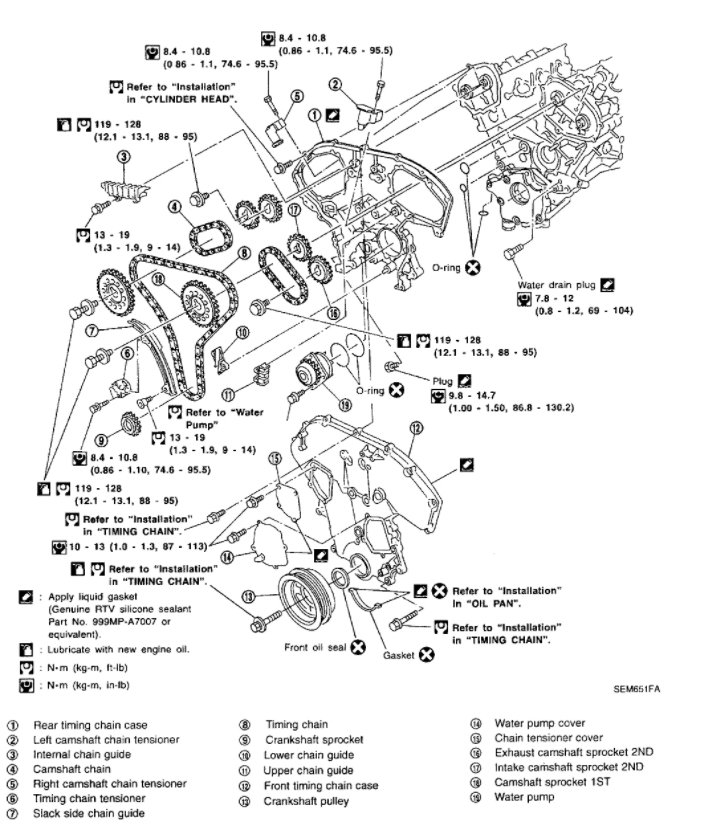

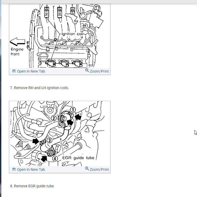

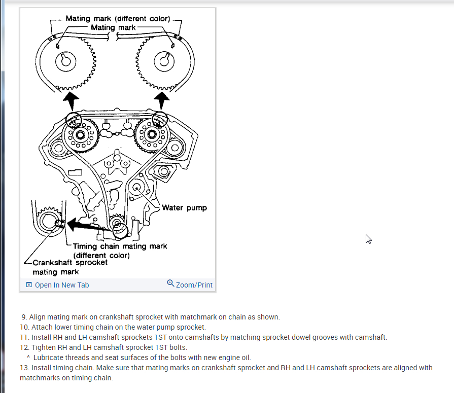

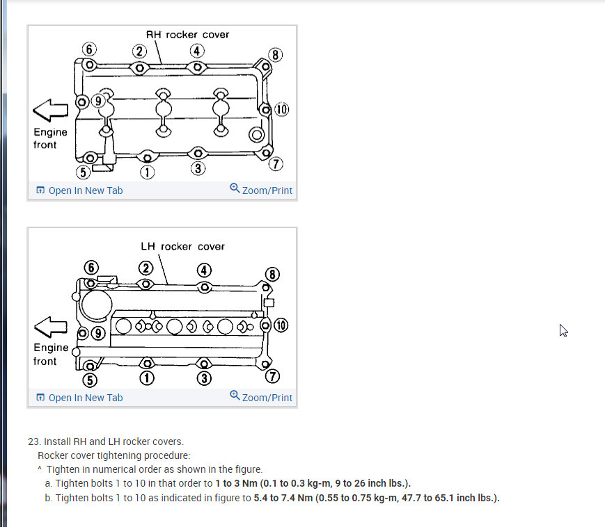

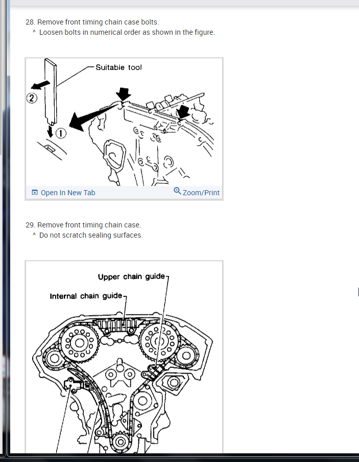

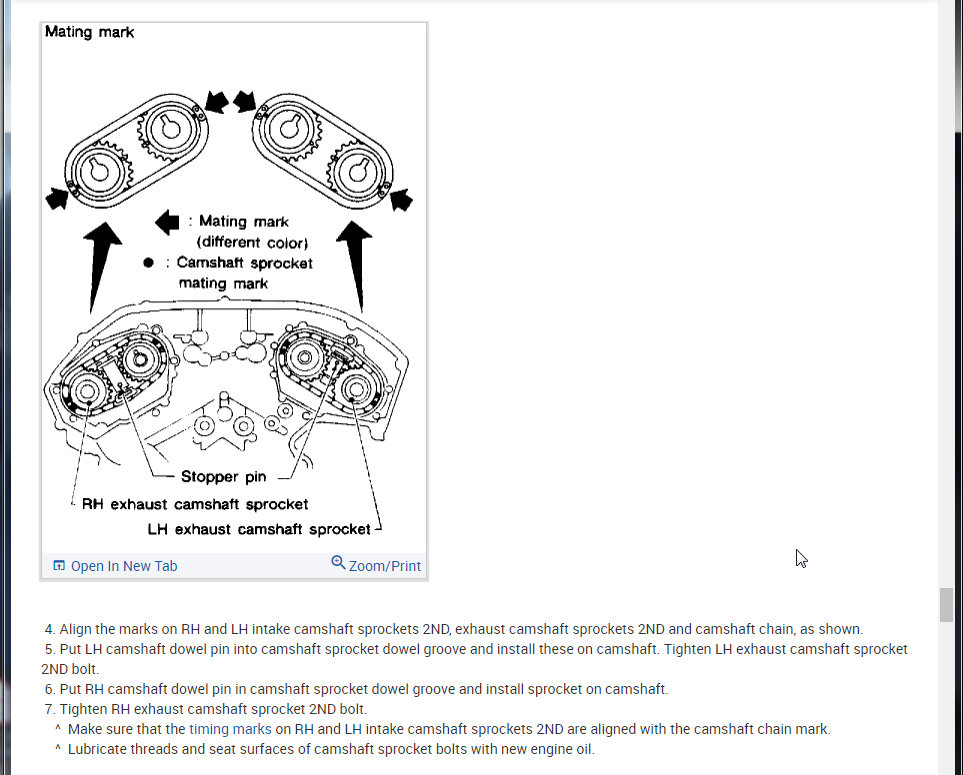

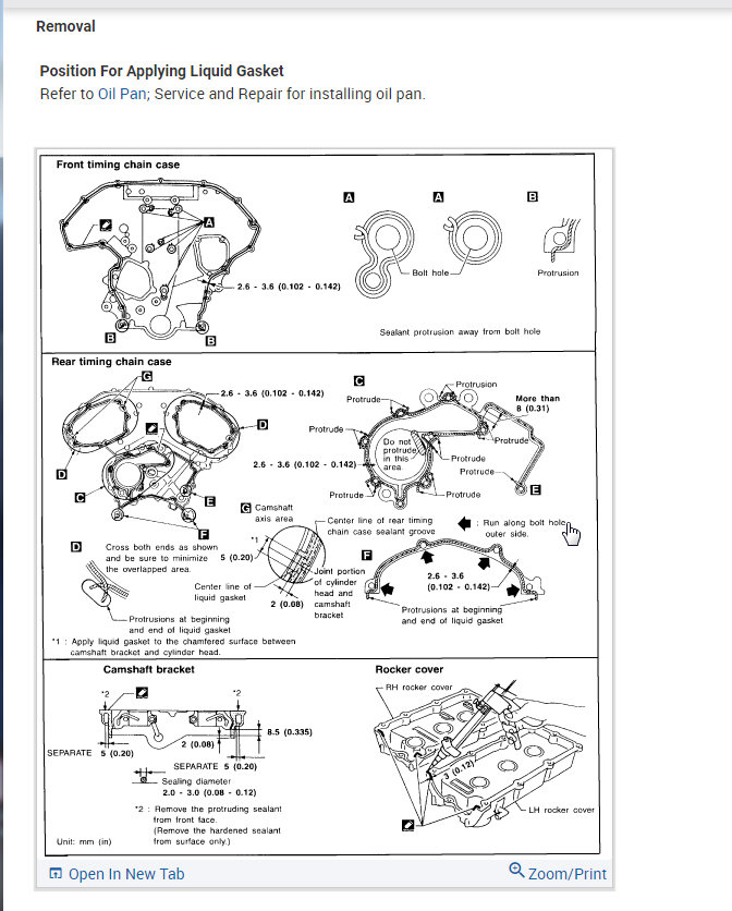

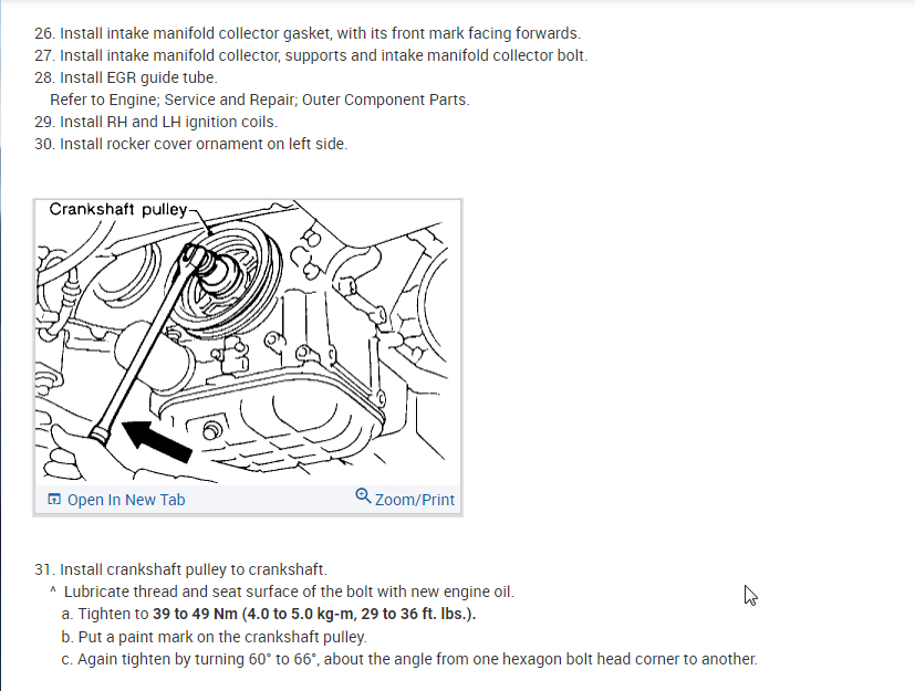

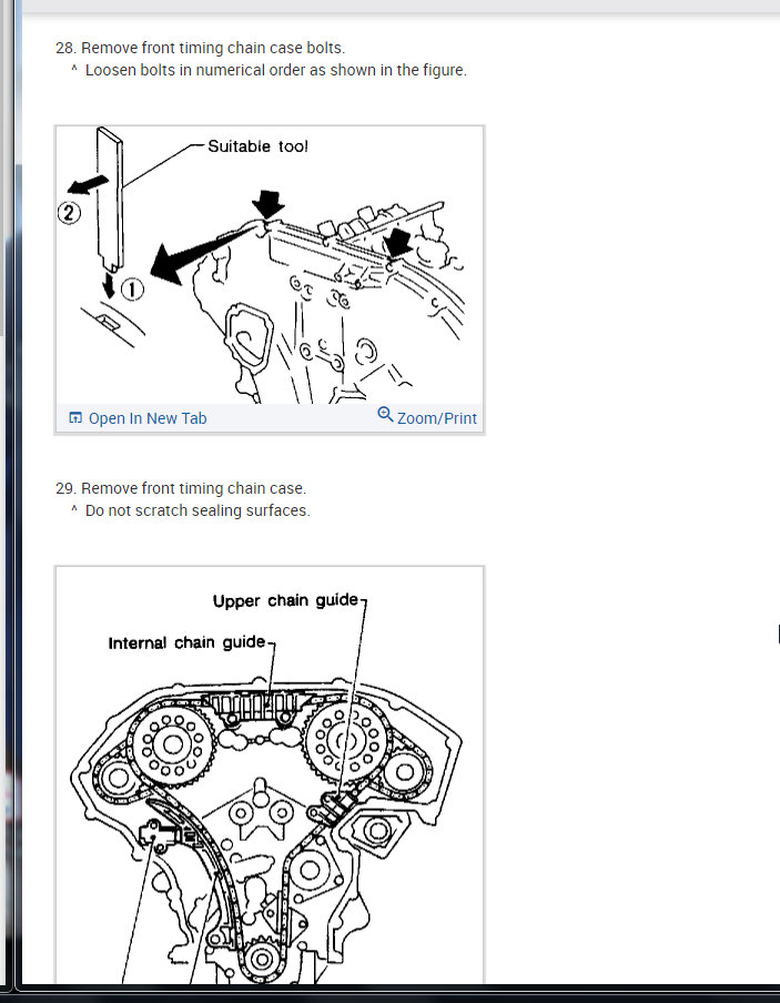

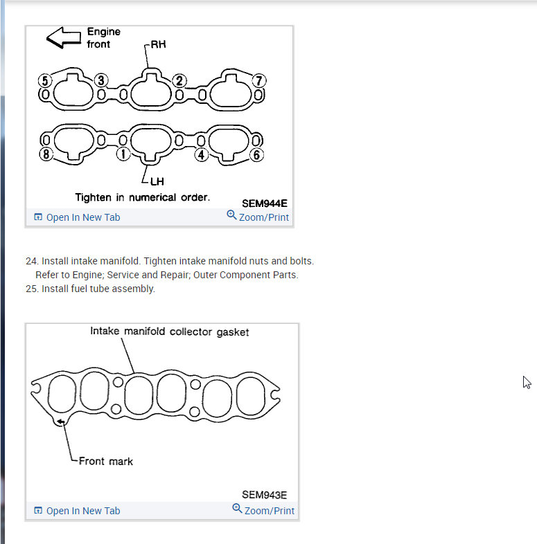

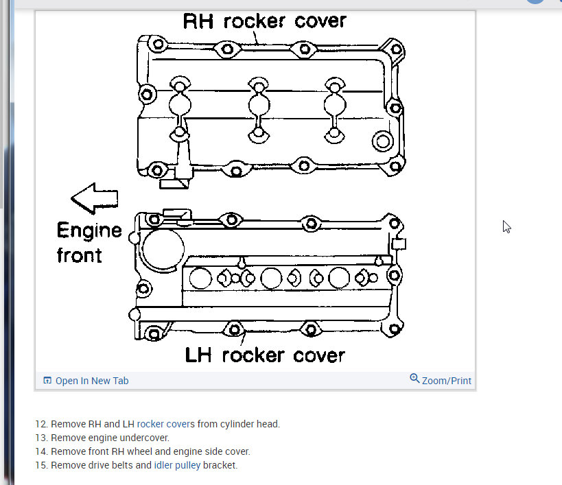

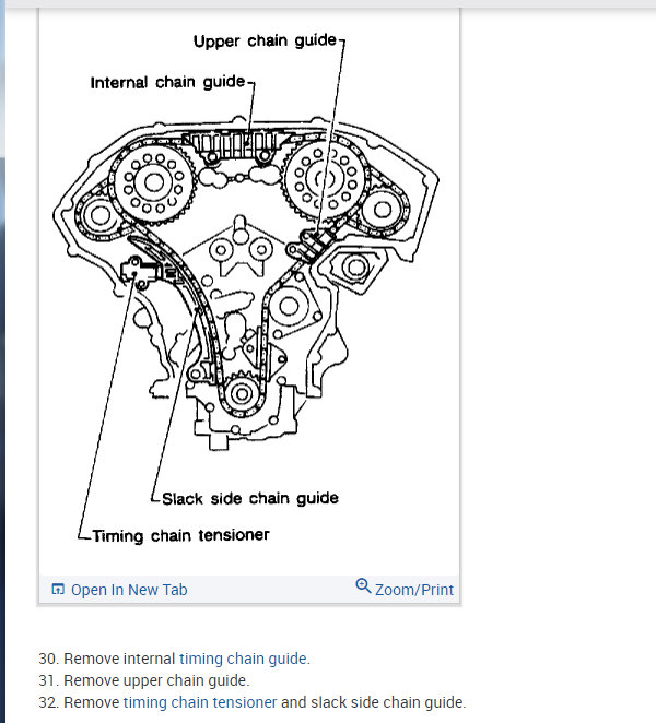

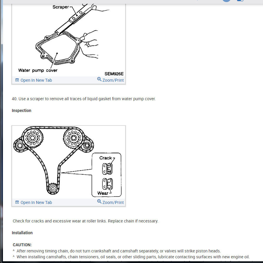

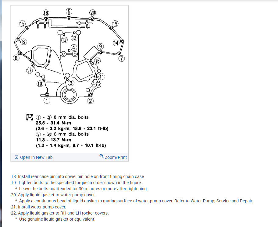

Where is the timing chain on this car and after replaced how do I time it?
Friday, February 12th, 2010 AT 1:08 PM

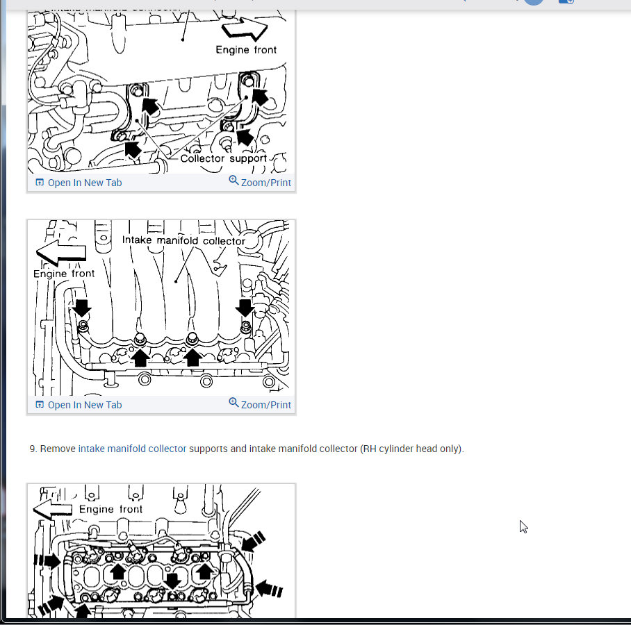

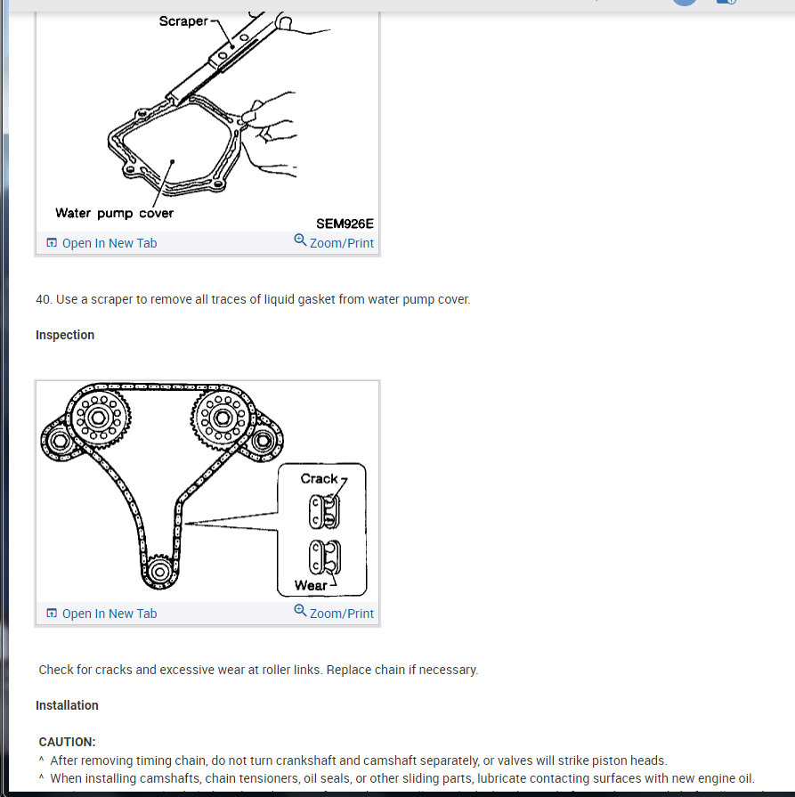

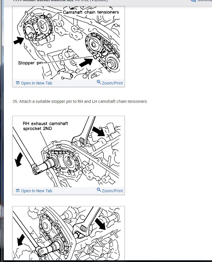

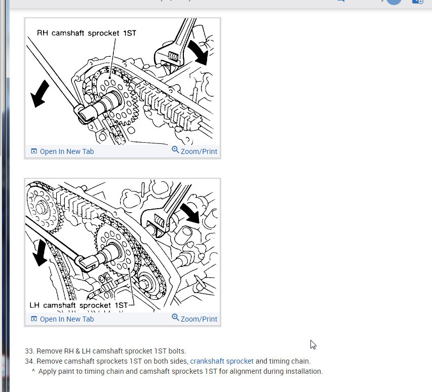

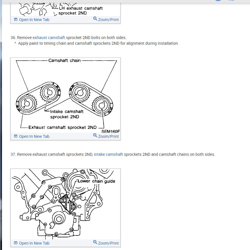

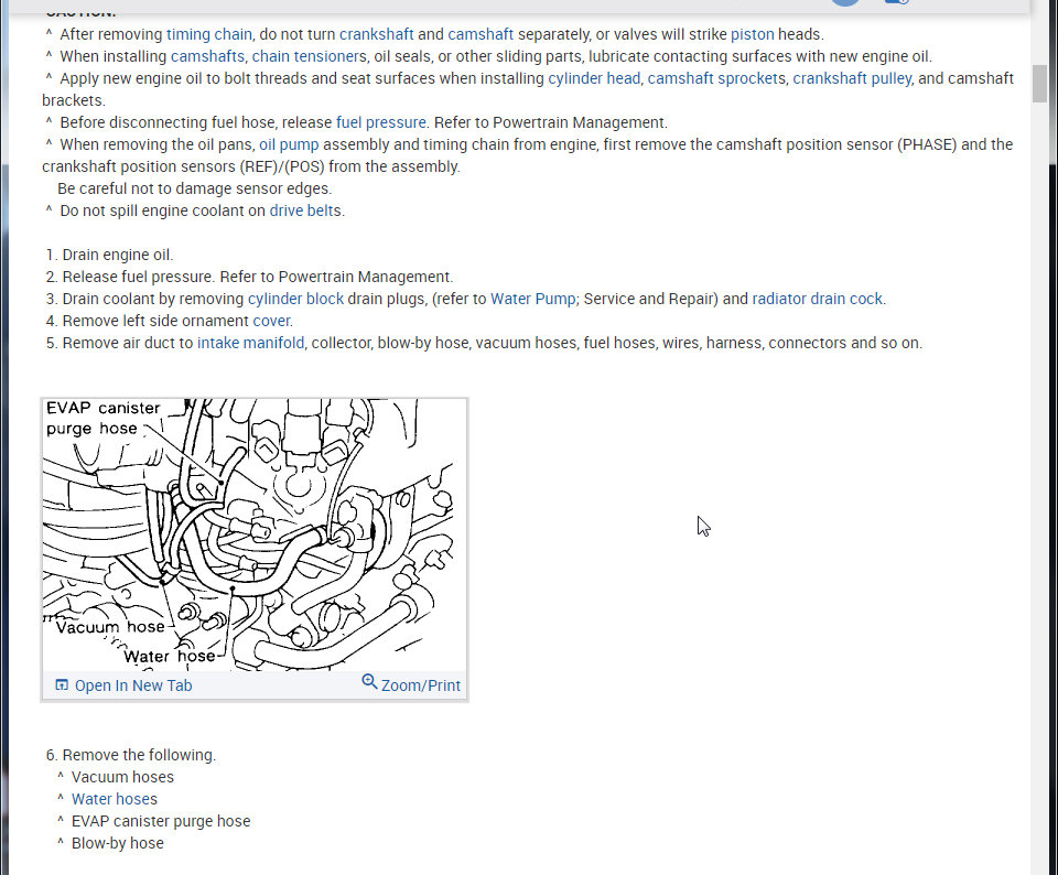

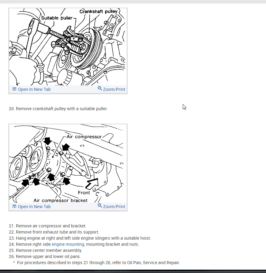

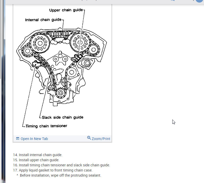

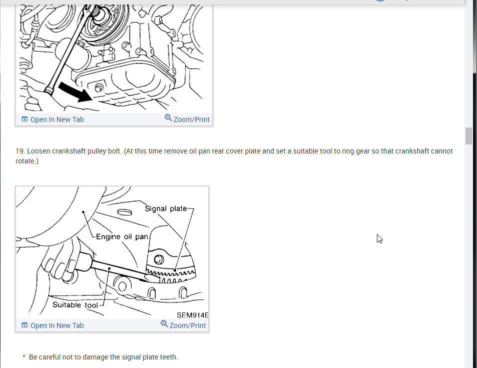

I am attaching the entire process on how to replace the timing chain and it shows everything that you will need. Let us know if there are other questions. Check out the diagrams (Below). Please let us know if you need anything else to get the problem fixed. Thanks
