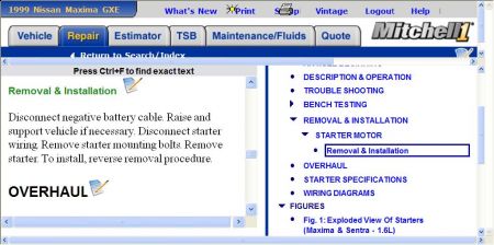

hi i have a 1999 nissan maxima se limited and need to change the starter... i checked the battery and it has a charge...when i crank it all i get is a click click click and it doesnt start... i can see the starter but how do i get it out from above or underneath the car... thank you
Sep 26, 2009 at 1:05 PM
  • 75,988 POSTS
Possibilities here could be the starter, starter relay, park/neutral switch, ignition switch, battery and connections-
https://images.2carpros.com/forum/automotive_pictures/12900_starter_31.jpg
