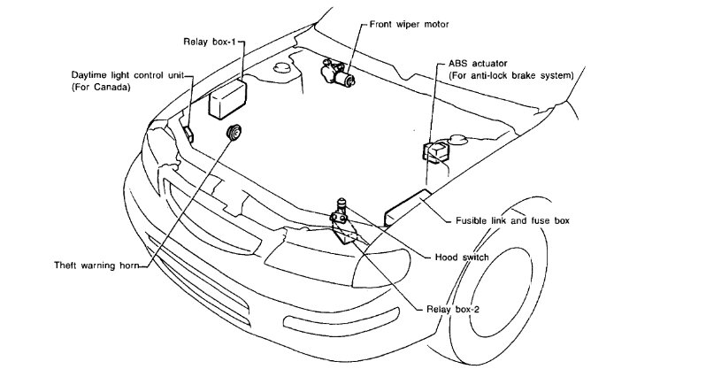

No pulse at fuel injectors?
1999 NISSAN MAXIMA
FMCFFFF7
Engine Mechanical problem
1999 Nissan Maxima Front Wheel Drive Automatic 140355 miles
Car turns over wont start replace several sensors,Fuel injectors do not seem to be working. Will run when starting fluid is sprayed into air intake.
Nov 5, 2010 at 3:28 AM
KHLOW2008
  • 41,814 POSTS

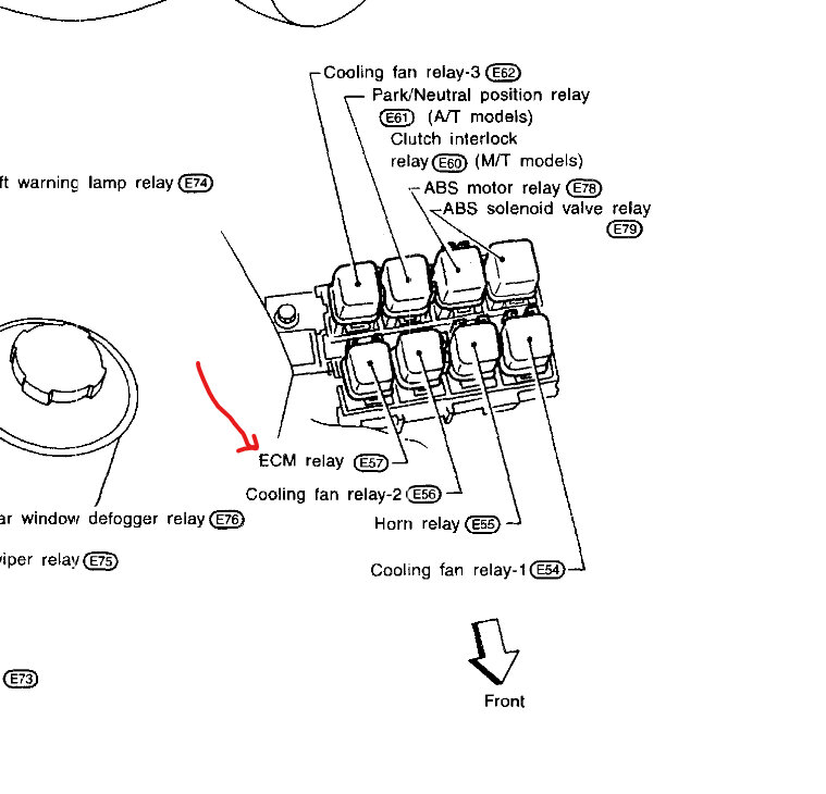

Hi fmcffff7,
This sounds like you have a ECM relay that is not working. Here is the location so you can swap it out to see if that fixes it. Check out the images (Below). Please let us know what you find.
Nov 5, 2010 at 3:46 AM
JSHANDEL
Dear fmcffff7, I have he exact same issue with the same model year Maxima. The ECM relay fixed it Thanks. -- Joel
