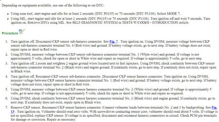

HI WE HAVE THIS CAR IN MY SHOP
THE CHECK ENGINE LIGHT IT ON
THE MACHINE SAID THIS CODE
1-P-1336
2-PO725
WE LIKE TO KNOW HOW FIX THIS CODE PLEASE
THX SO MUCH

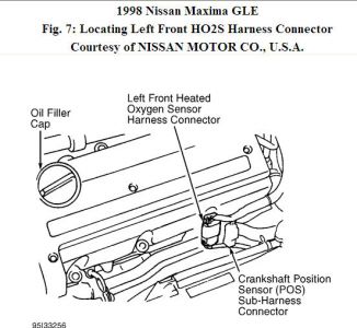

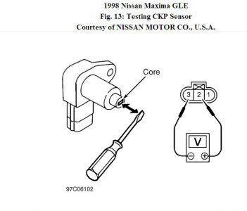

DTC P0335 OR P1336: CRANKSHAFT POSITION (CKP) SENSOR
Replace the CKP sensor !

I'd suggest you get Mitchell one or Alldata.
First code:
https://www.2carpros.com/forum/automotive_pictures/30961_1j_1.jpg
https://www.2carpros.com/forum/automotive_pictures/30961_1ja_1.jpg
https://www.2carpros.com/forum/automotive_pictures/30961_1jb_1.jpg
Second code was likely a result of the first code.
