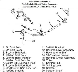

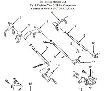

Do you have this diagram?
https://images.2carpros.com/forum/automotive_pictures/192750_Shifter97Maxima01_1.jpg
https://images.2carpros.com/forum/automotive_pictures/192750_Shifter97Maxima02_1.jpg
From your description of the fault, your problem lies with the reverse gear. It is staying engaged in reverse or reverse is engaged when 1st or 2nd is engaged. Does the vehicle tries to reverse when in neutral? Either the reverse shifter is not locking into position or the locking balls plunger for the shifter has not been installed correctly resulting in 2 gears being engaged causing the stalling. Check the above shifter diagrams and see where you have gone wrong.
