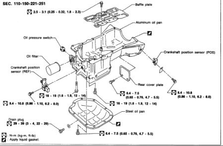

where is the oil filter and what size is the oil pan screww

https://images.2carpros.com/forum/automotive_pictures/12900_of_1.jpg
