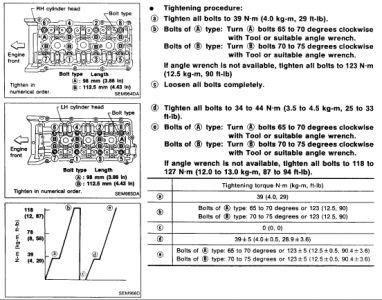

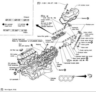

CYLINDER HEAD TORQUE SPEC
Oct 4, 2008 at 1:56 AM
IMPALASS
  • 3,112 POSTS
Please make sure in the future you include if your model is a DOHC or a SOHC. I have attached both pics. Good luck
