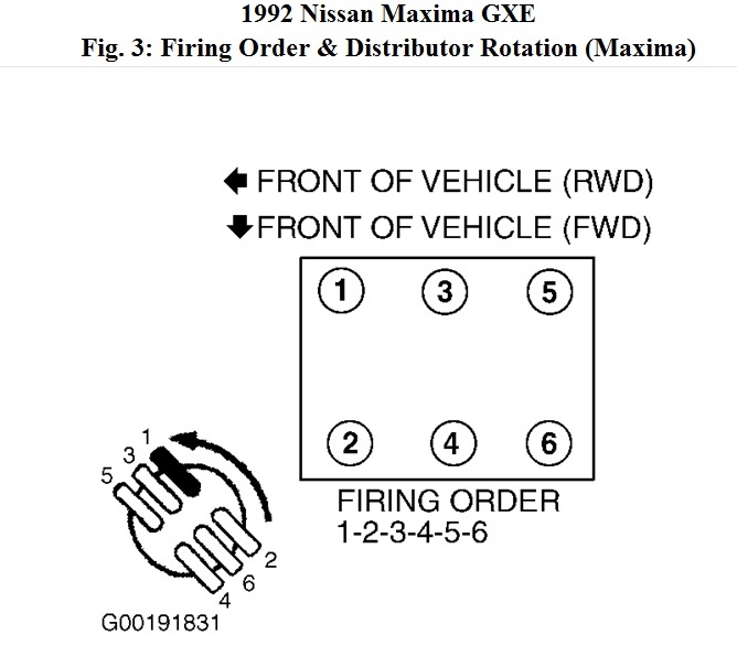

what is the fireng order from left to right on the heads. would it be 1.3.5. on the head close to the fire wall. and the head close to the rad 2-4-6

You are correct..

Distributor diagram for spark plug wires and firing order please

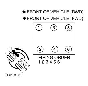

Here is the engine ignition firing order. Check out the diagrams (Below). Please let us know if you need anything else to get the problem fixed.
