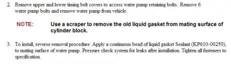

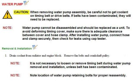

mY WATER PUMPS IS LEAKING HEAVILY i NEED TO REPLACE IT. hOW

https://images.2carpros.com/forum/automotive_pictures/261618_Noname_634.jpg
https://images.2carpros.com/forum/automotive_pictures/261618_Noname2_161.jpg
