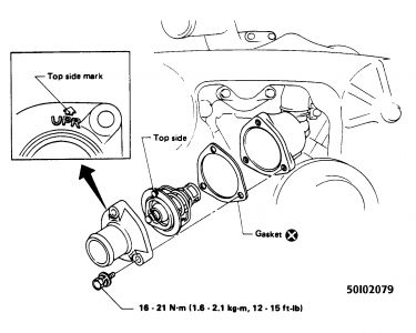

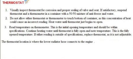

Not sure what you need to know about your thermostat....here is some information on it..
