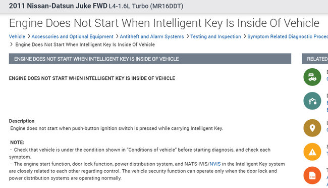

I just removed fuse box to change fuse after the car no start not detect my key-less, but can lock and unlock doors.
In dashboard I have red signs of key only when I punch to starting nothing going not open anything in dashboard. I verified all key-less battery, fuse, relay, and car battery all good.
Please can help me?
Thanks

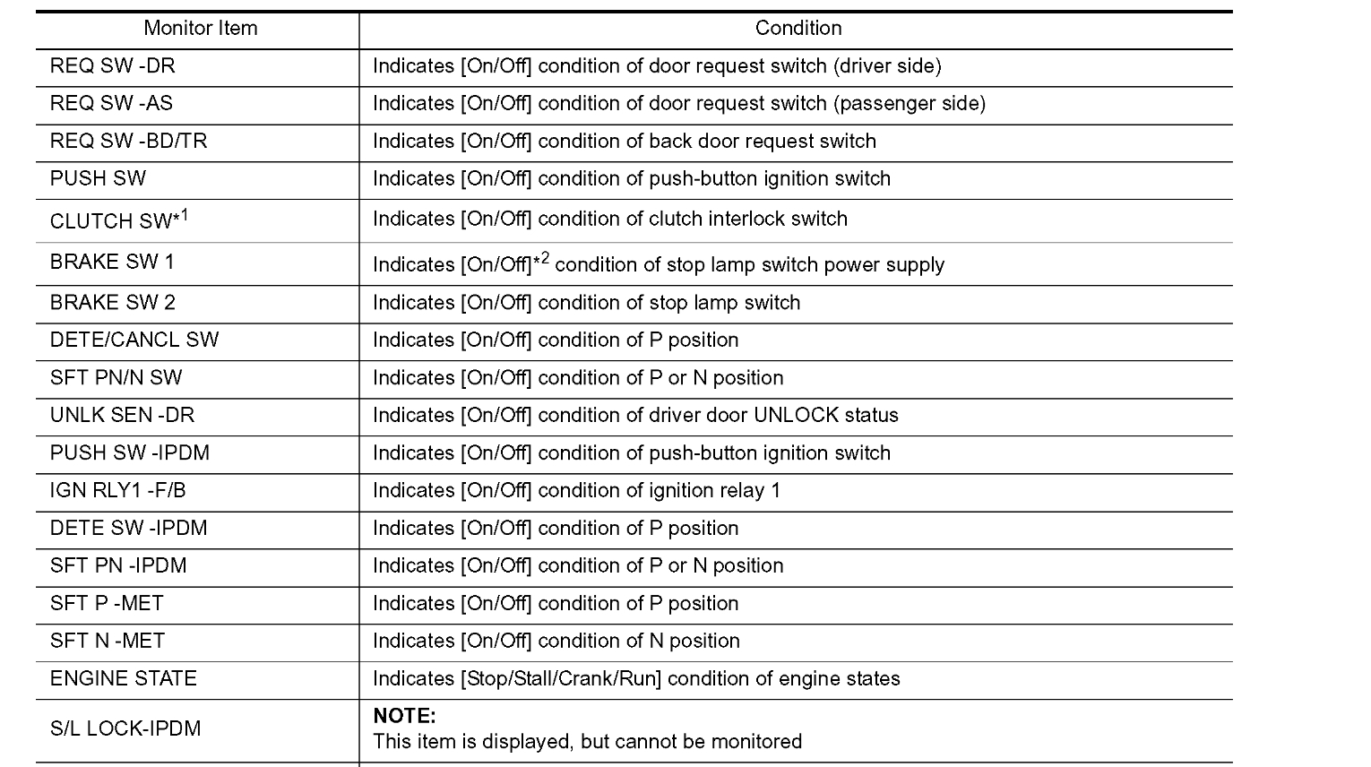

All of the diagnostic troubleshooting for your vehicle's immobilizer system must be done with Nissan's factory scan tool called the Consult - III. I can give you the directions, but unless you have one of these factory scan tools, it won't do any good. Please get back to us with want you decide to do.

Hello again,
Do you have the intelligent key or no intelligent key?

I have intelligent key.

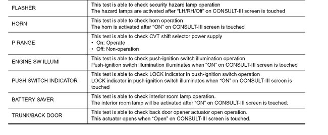

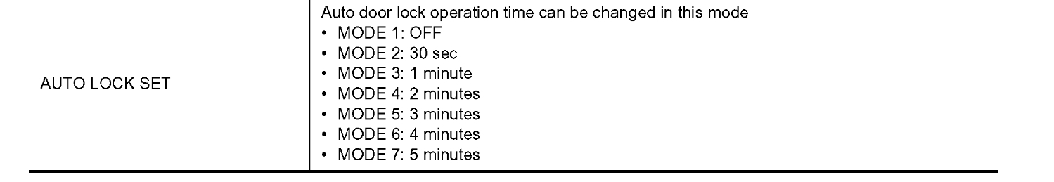

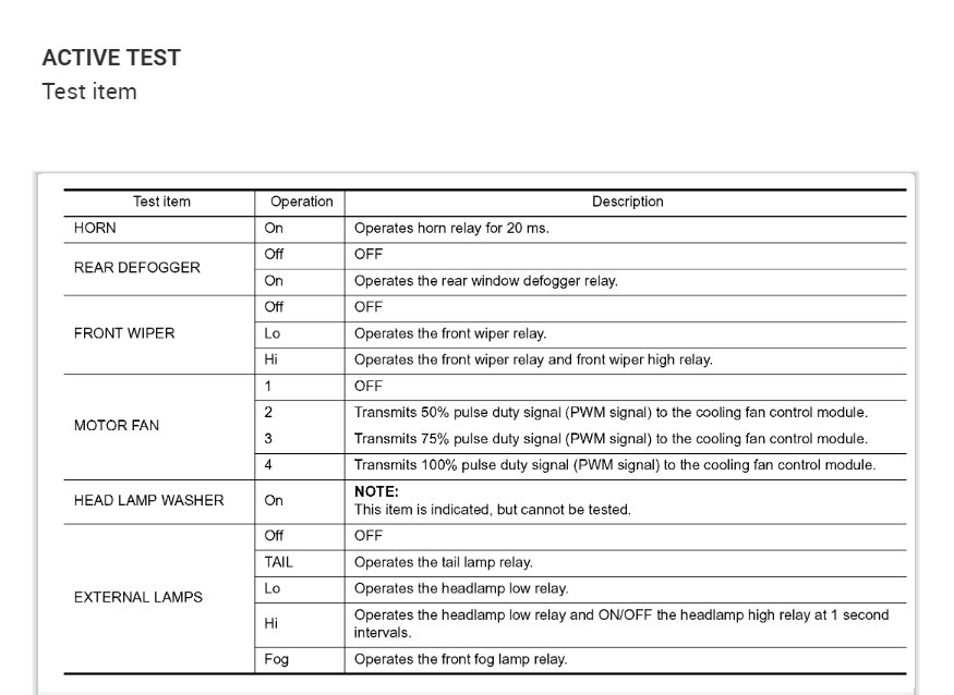

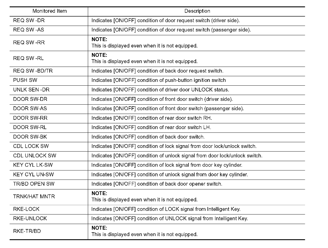

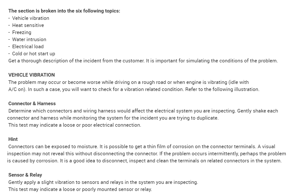

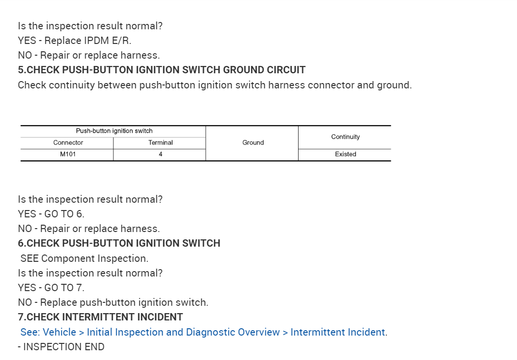

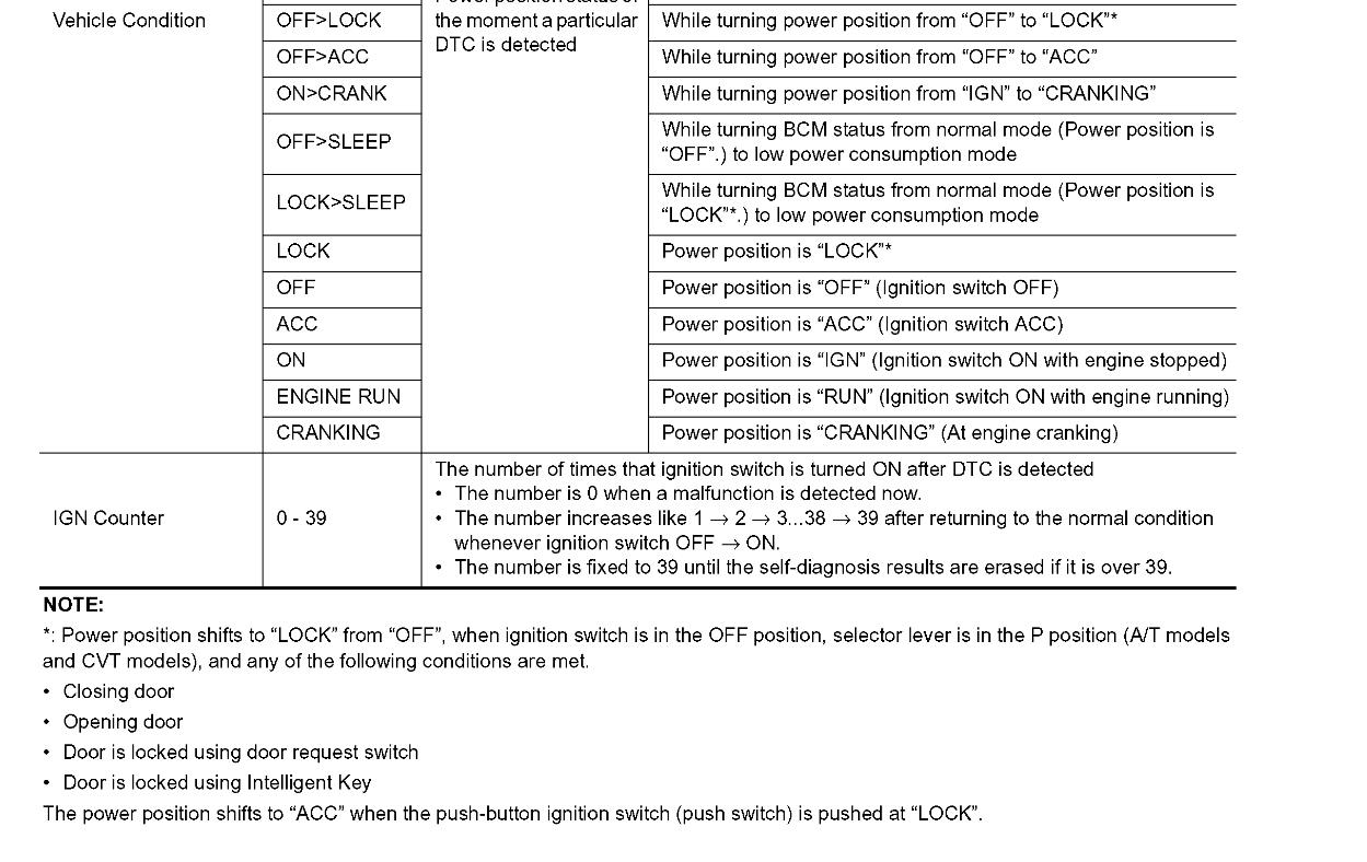

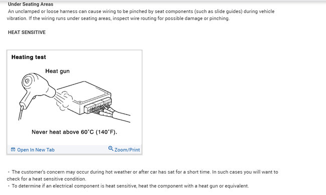

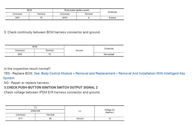

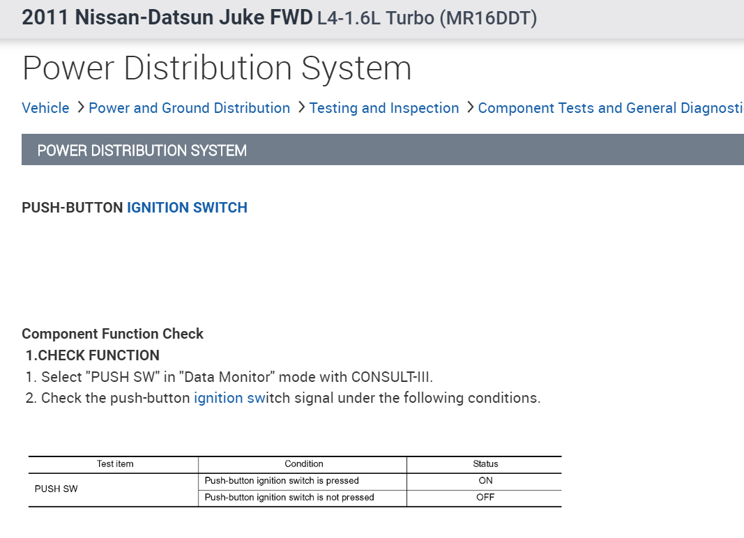

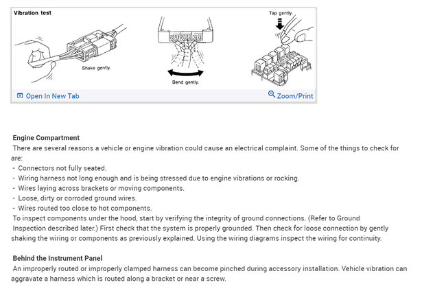

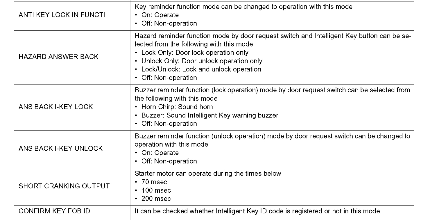

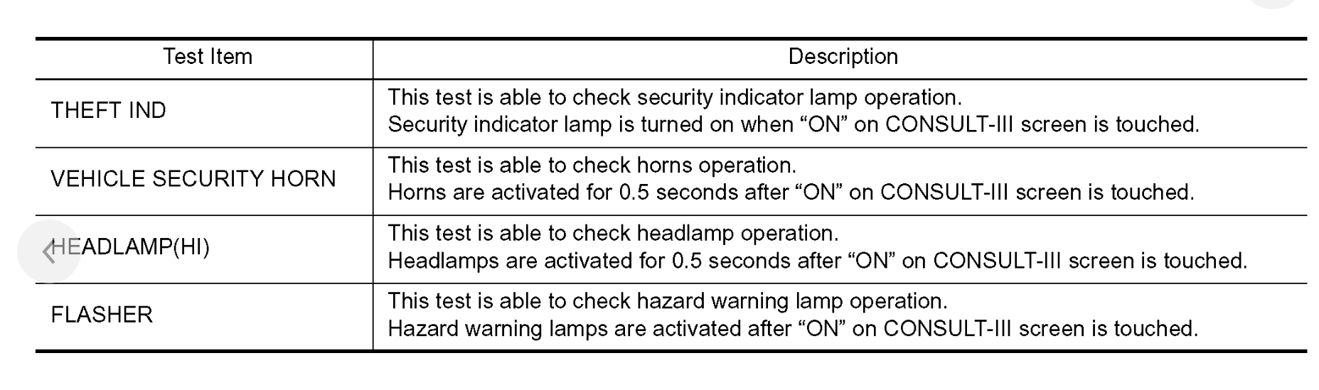

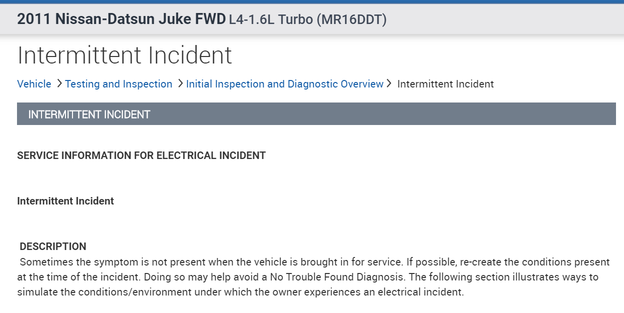

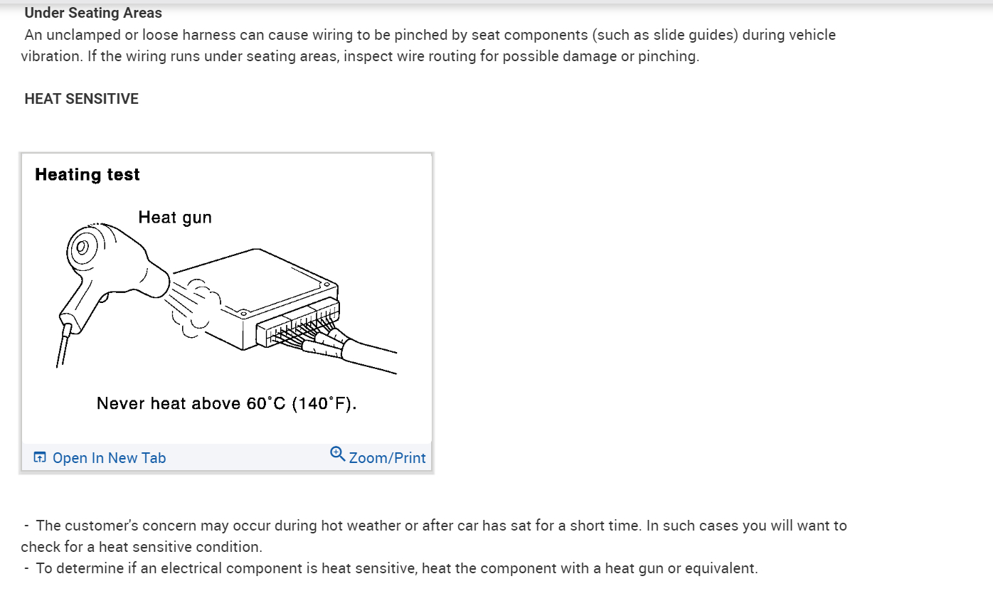

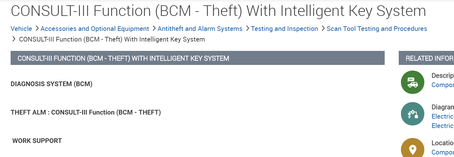

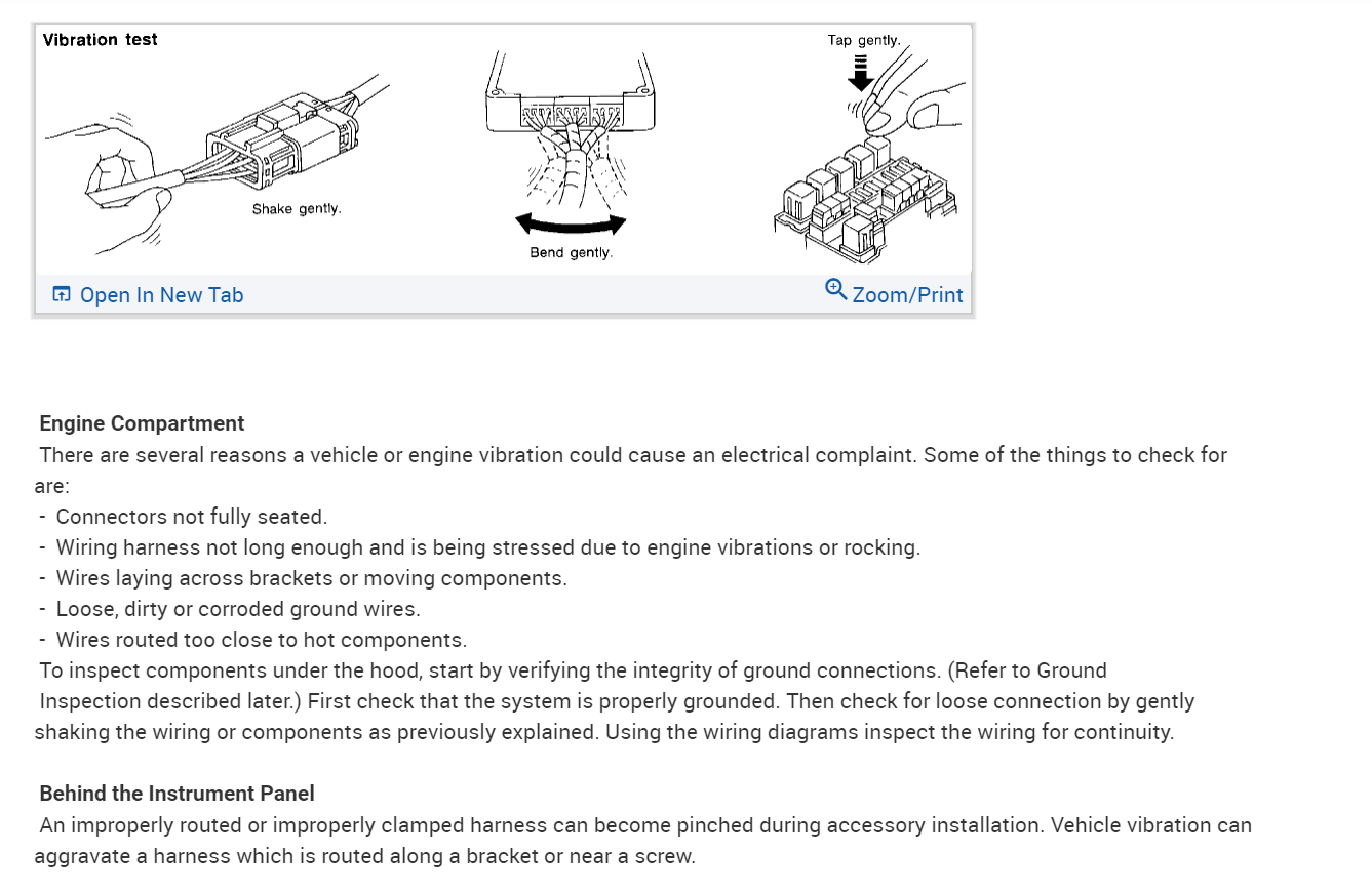

SCGRANTURISMO

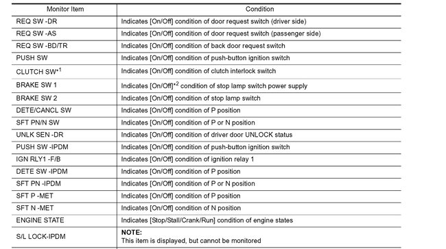

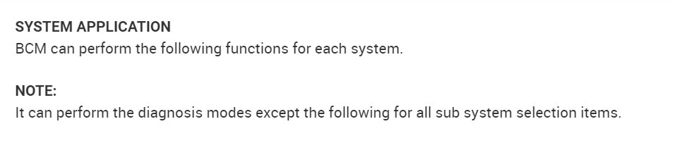

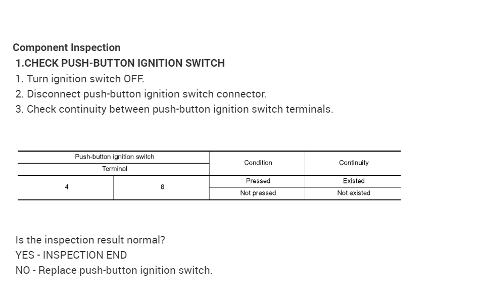

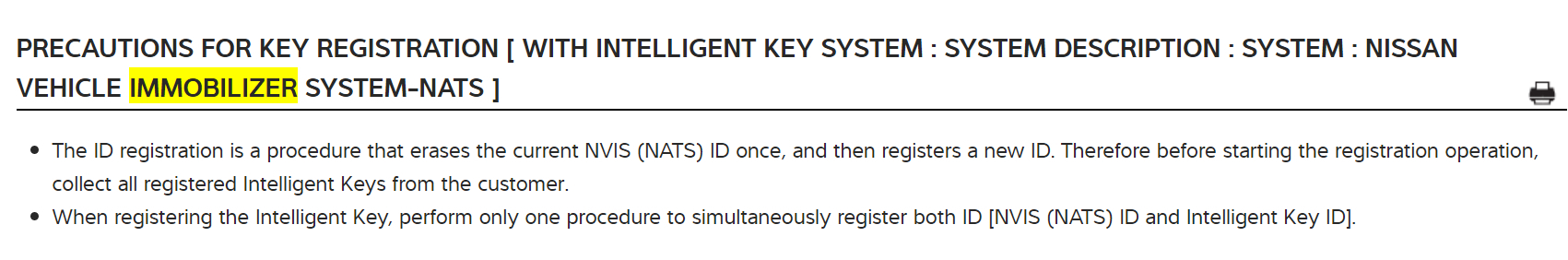

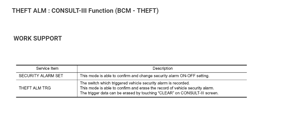

  • 4,897 POSTS

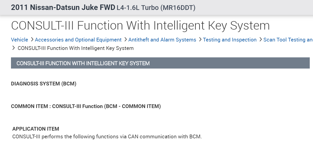

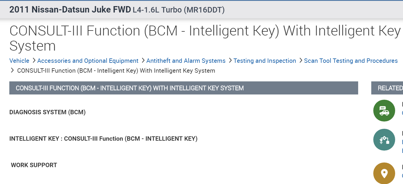

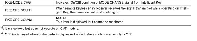

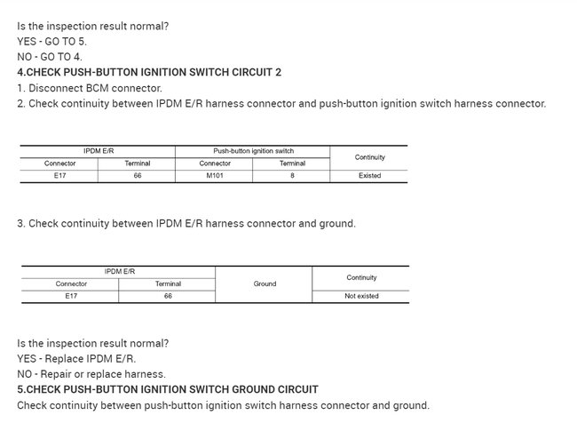

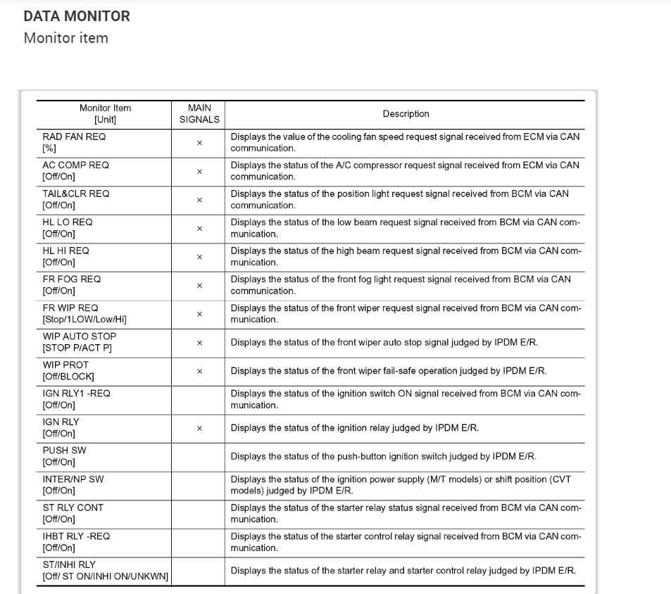

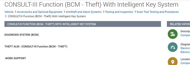

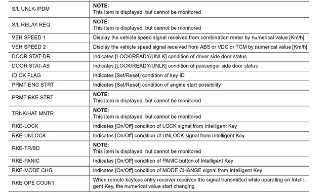

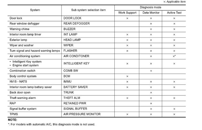

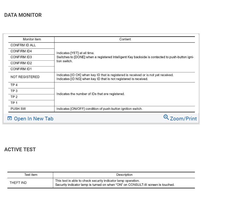

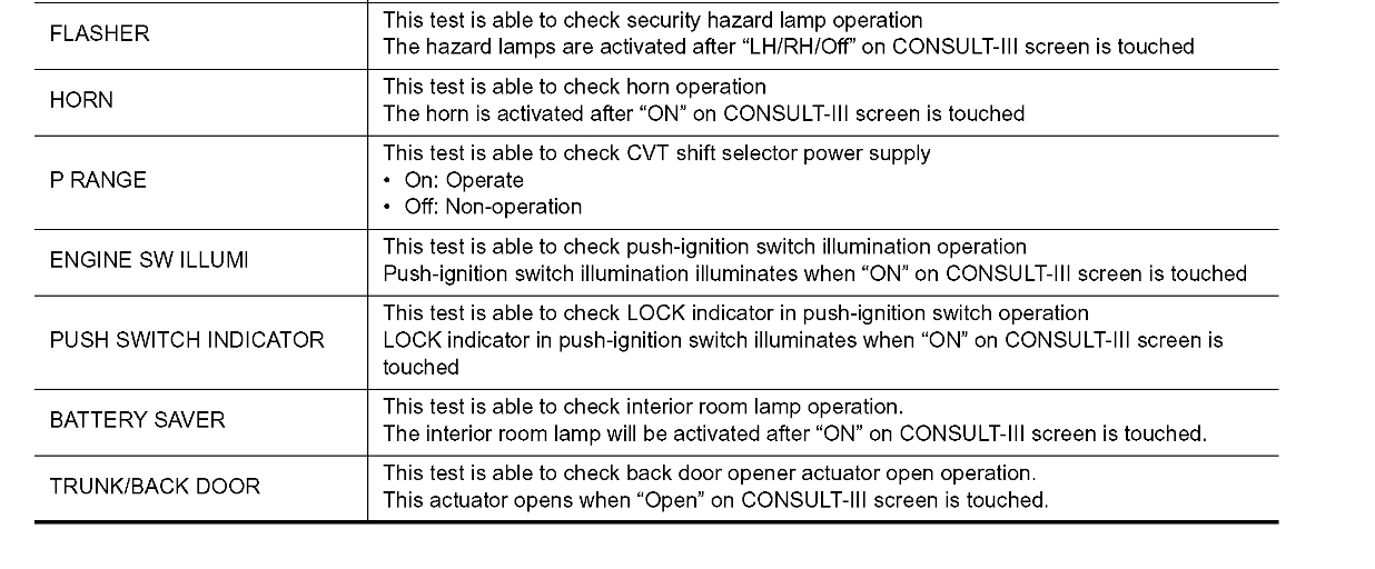

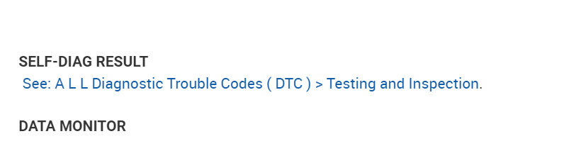

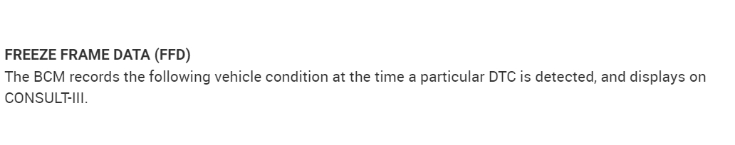

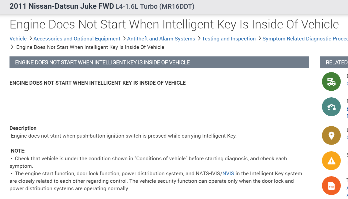

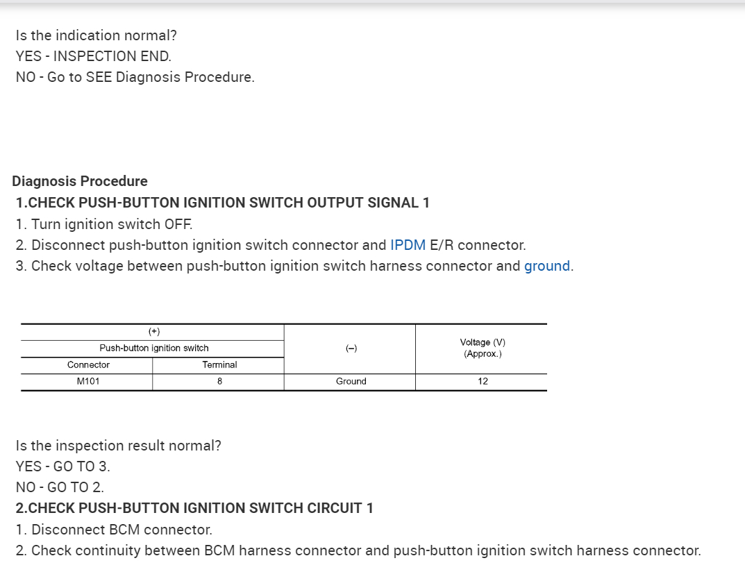

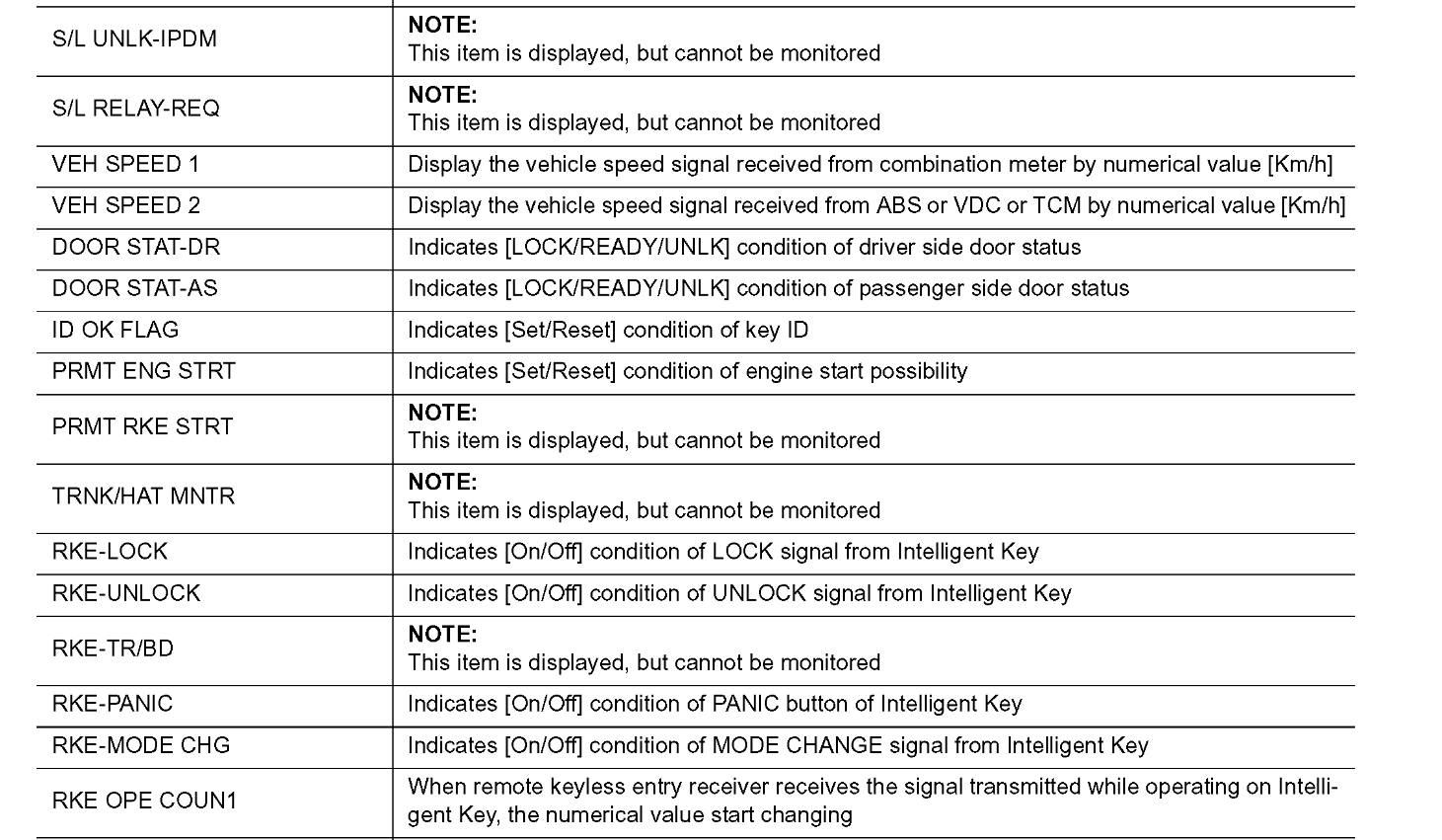

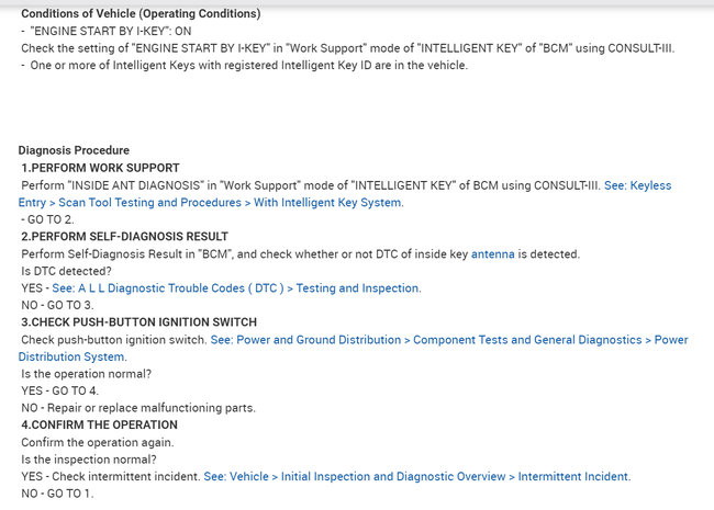

Hello again,

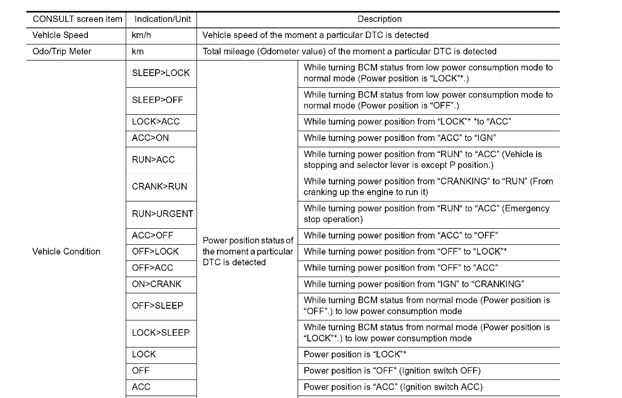

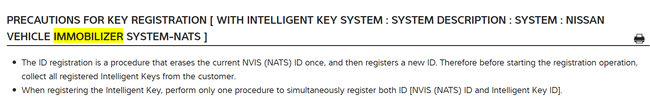

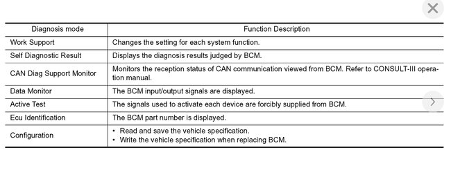

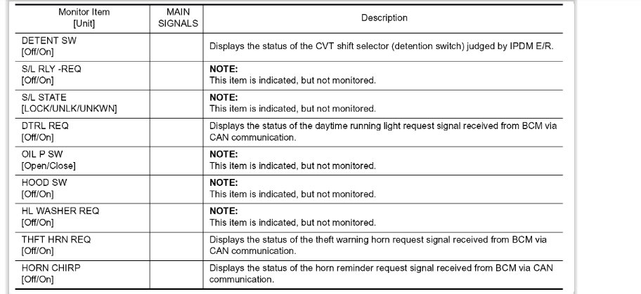

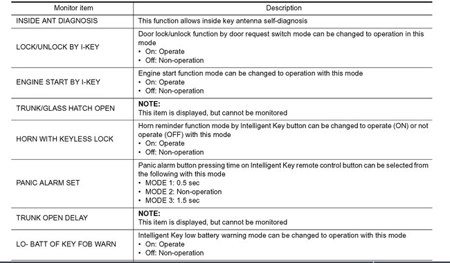

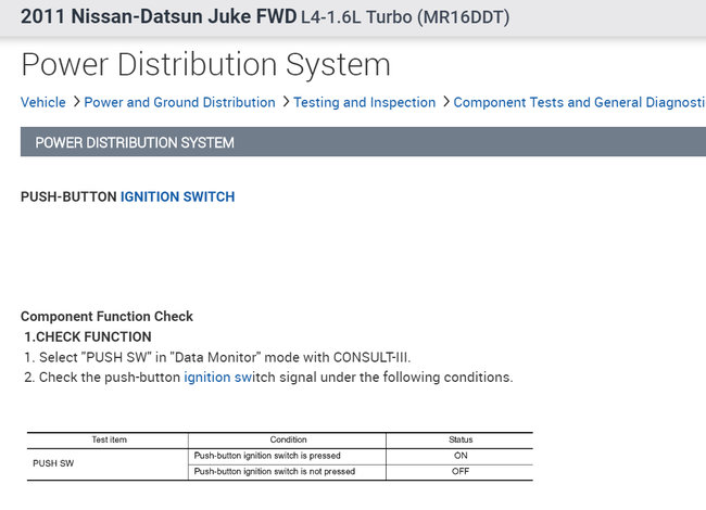

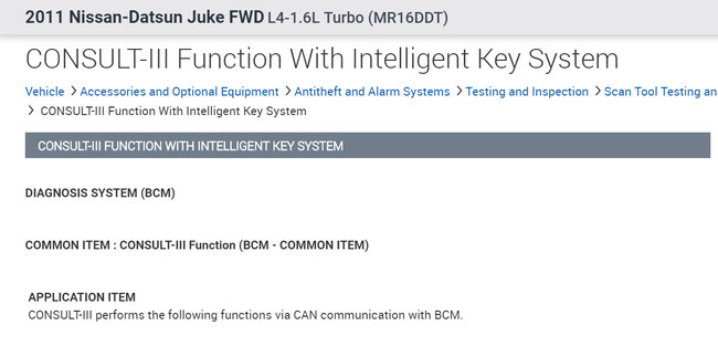

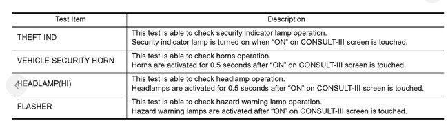

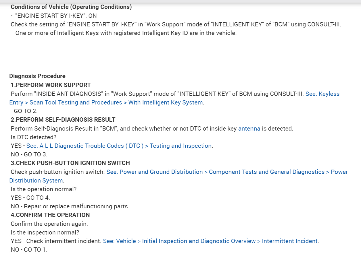

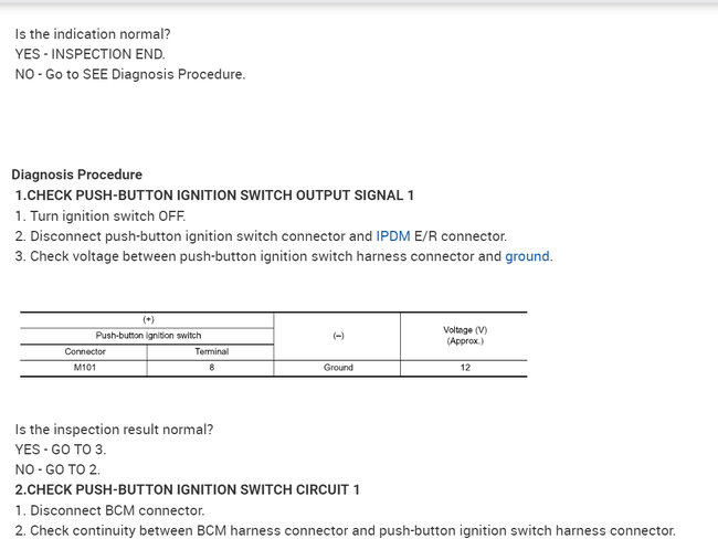

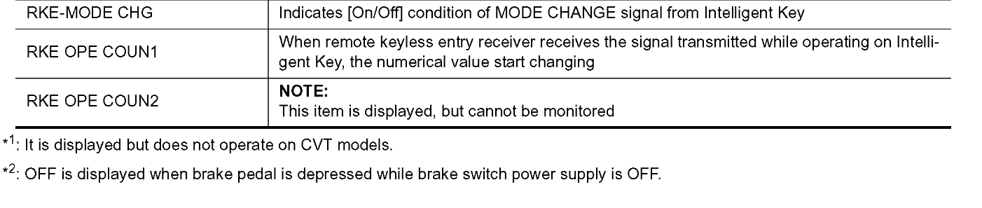

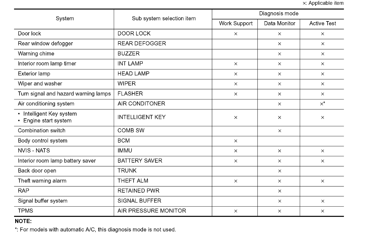

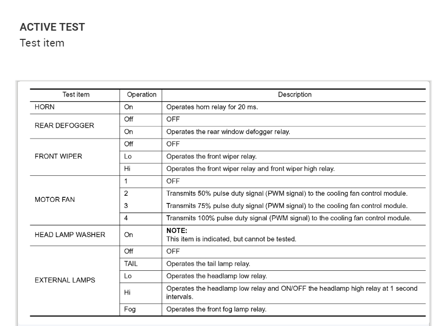

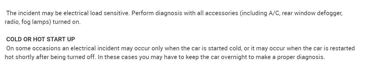

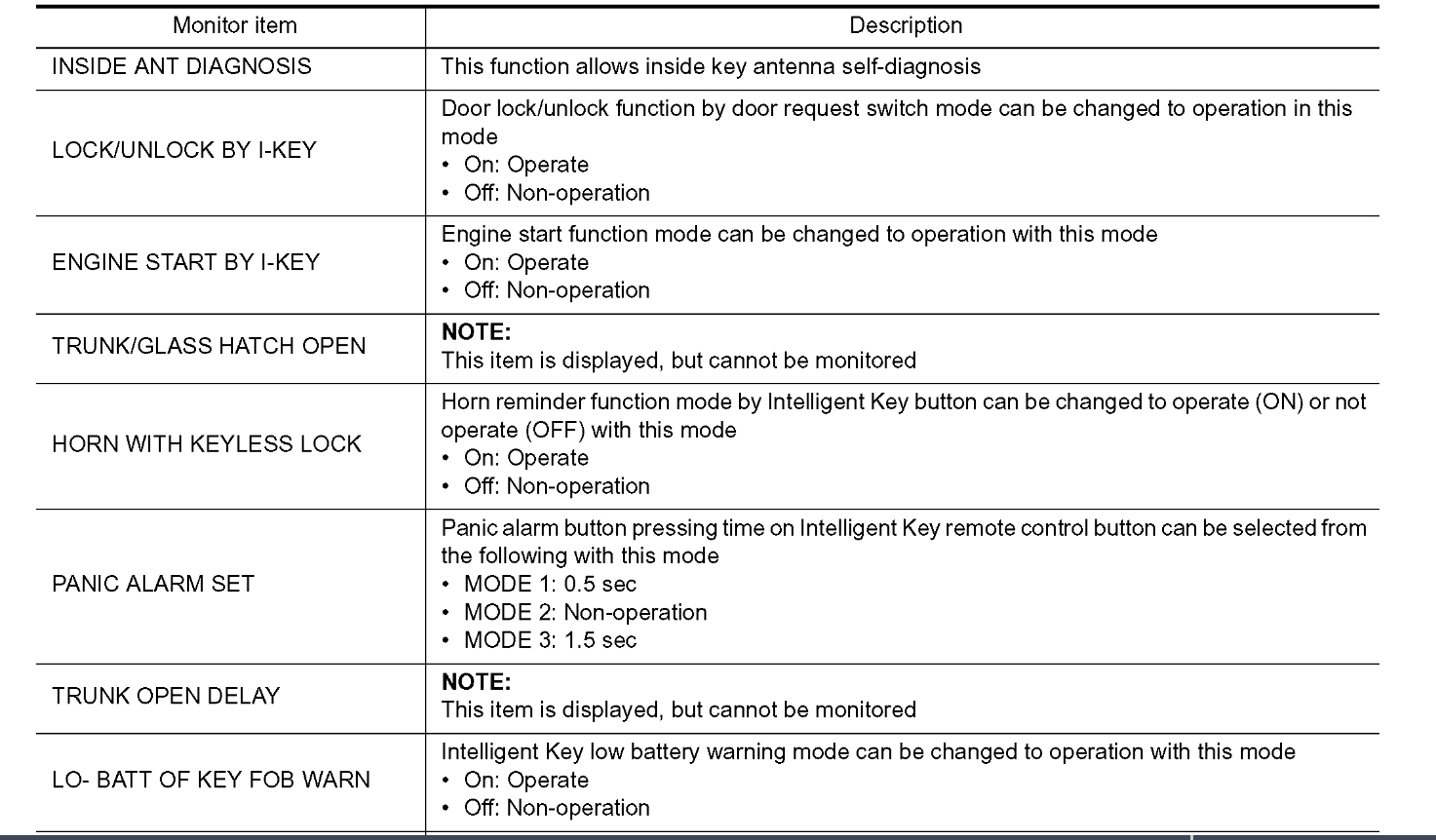

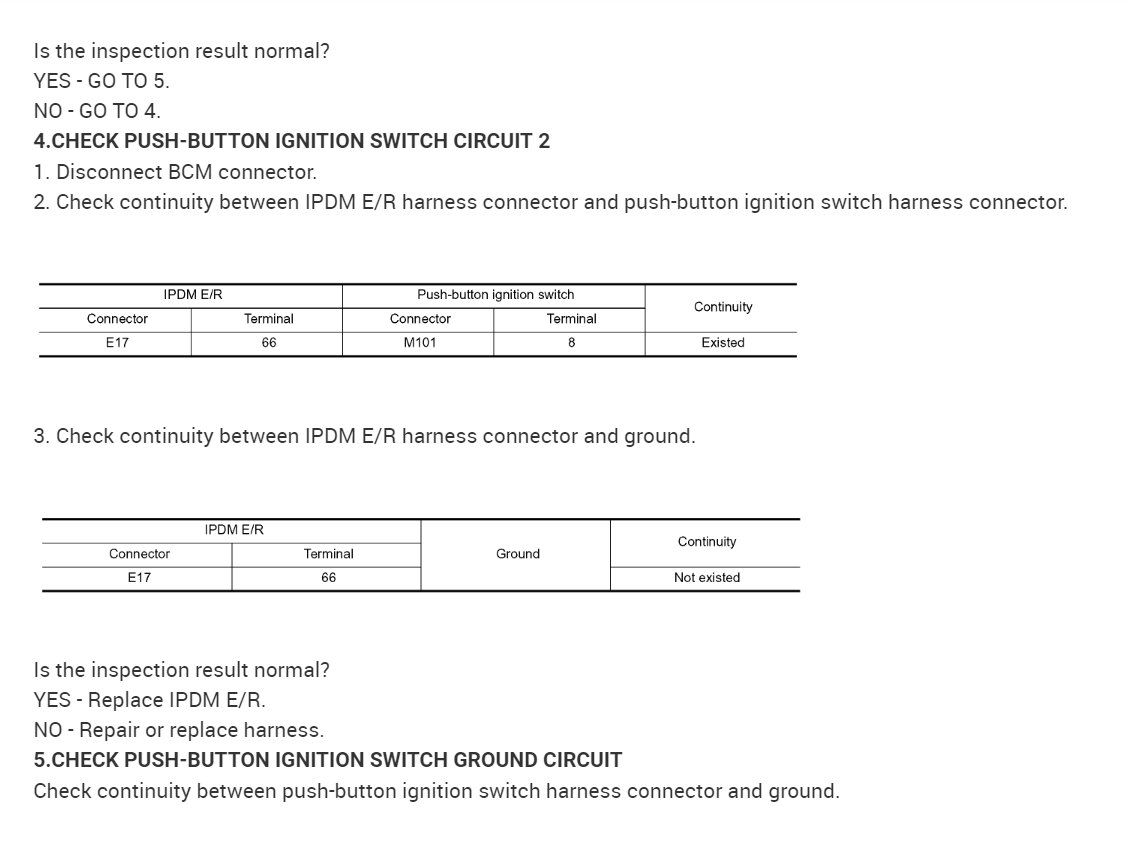

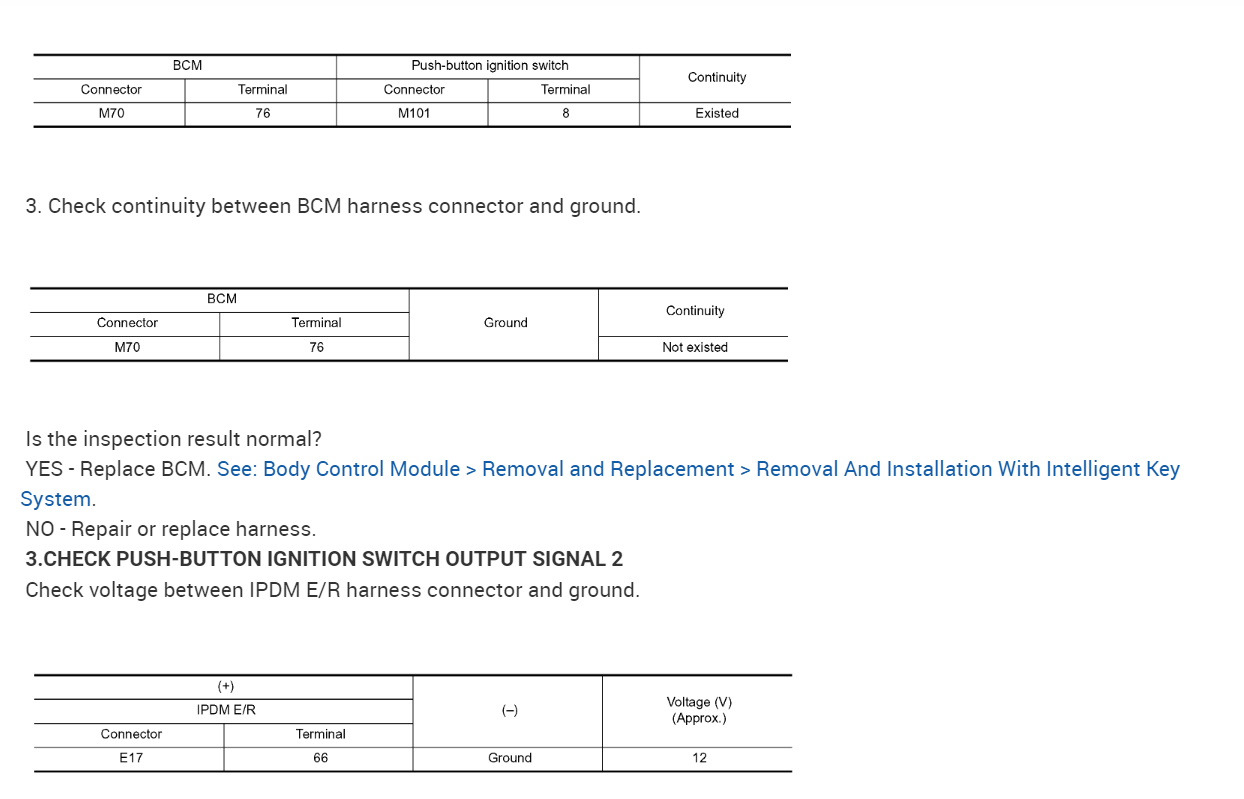

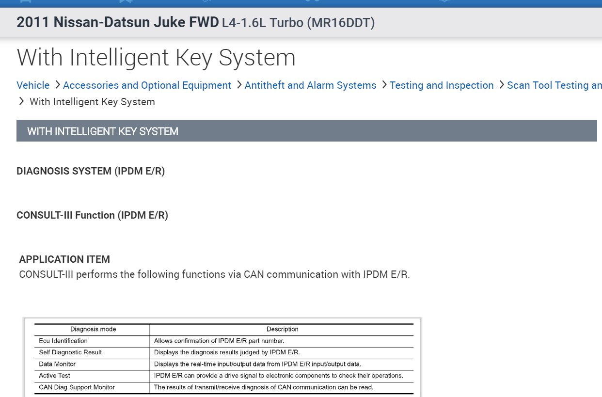

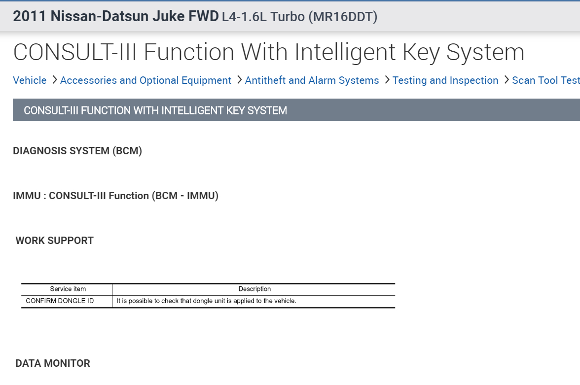

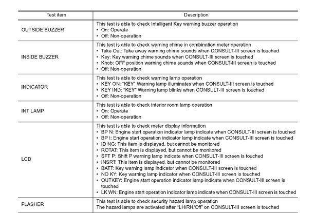

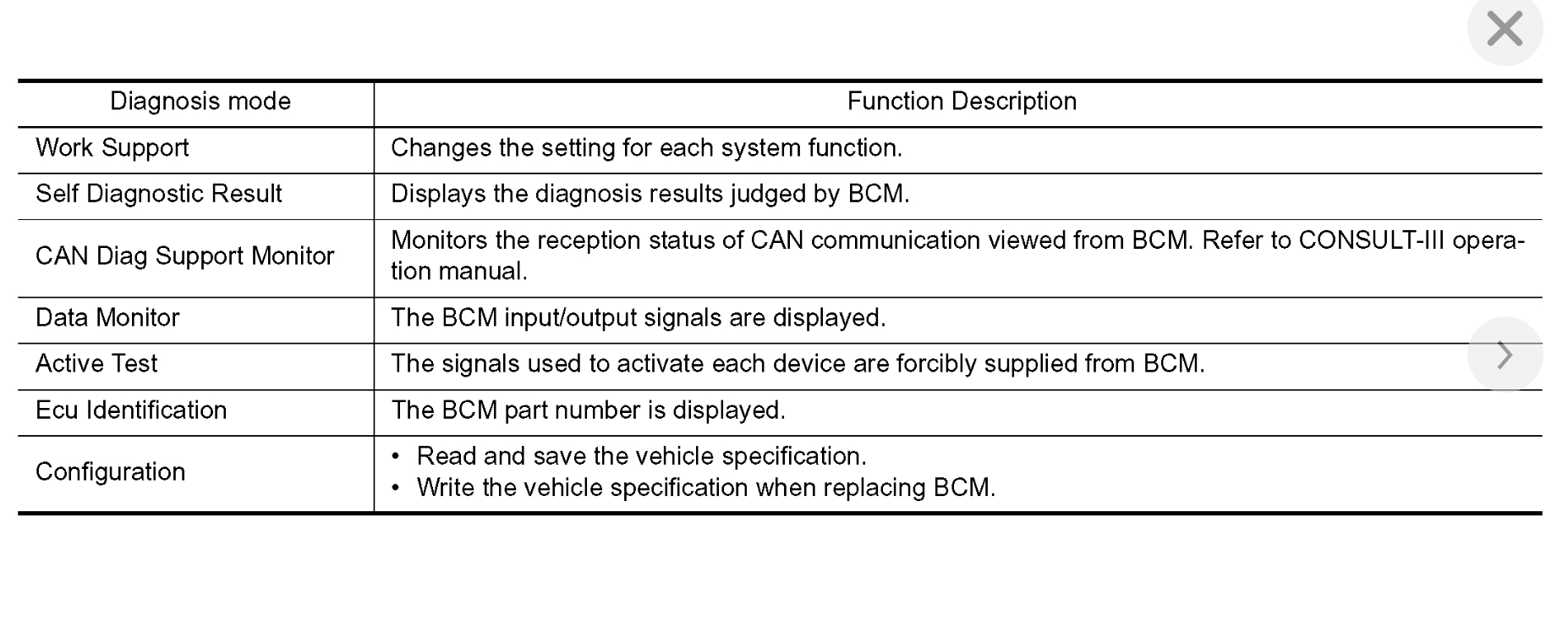

The information that you requested is in the diagrams down below. Please go through it and get back to us with what you are able to find out.
Thanks,
Alex
2CarPros

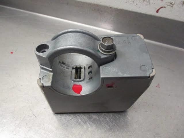

FAYCAL SALIM
  • 6 POSTS
I trying today to remove the steering lock module in picture and I canceled all security systems by removing the fuse of this. I'm not electrician, but to know the fuse I follow the colors of the wire of the switch for this steering lock OEM to fuse box I get is connected to 2 fuse. I removed it now the car opened light in dashboard showing everything well, but key not connect. I think I must reprogram key I'm waiting for key programmers to trying I will add later the results .
