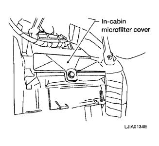

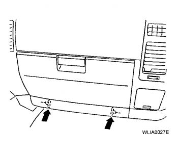

I know the cabin filters are dirty but I cannot located where they are hiding at? Could you please help?and with pictures ..

Locted behind the glove box door, need to remove the pins holding the door (fig1) then remove the cover to get to the filter(fig2)
