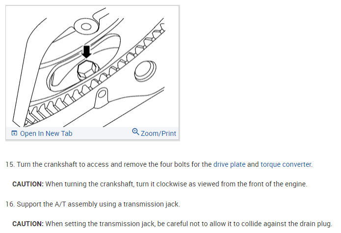

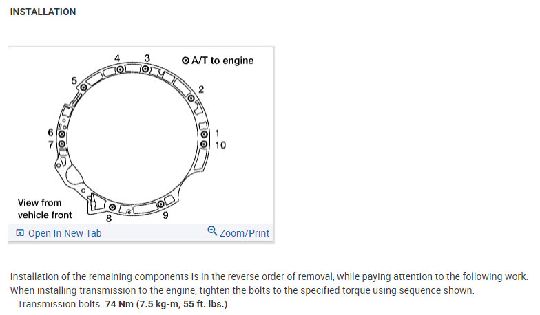

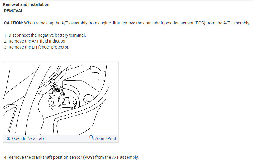

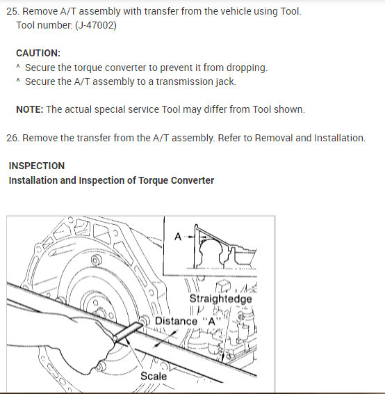

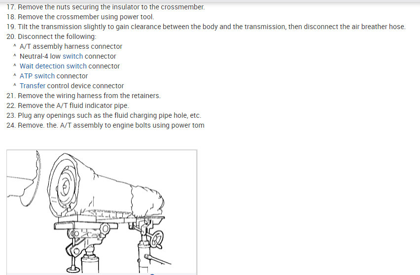

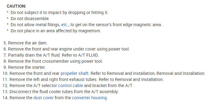

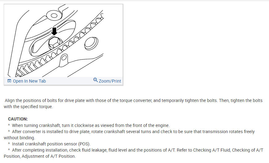

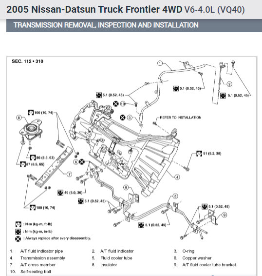

A dealer says I need a new auto tranny (actually it would be a Nissan remanufactured tranny) for my truck. It's an '05 Frontier 4wd. I guess I believe their diagnosis, but they want $6400 for the job. My problem is I don't live in Reno and had to leave it there for now, so I'm sorta stuck doing the job myself can you help? Thanks a bunch.
Oct 19, 2010 at 4:34 PM
DANNY L
  • 5,648 POSTS
Hello, I'm Danny.
Here is the information you requested. Here is a tutorial for you to view on how to replace a manual transmission which is similar:
https://www.2carpros.com/articles/transmission-replacement-removal-manual
I've attached picture steps below on how to remove and replace the automatic transmission on your vehicle. Hope this helps and thanks for using 2CarPros.
