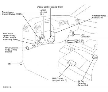

All electric windows failed to operate at the same time. Cycled window override switch, does not help
Friday, August 13th, 2010 AT 1:22 PM
DOCFIXIT
MECHANIC
18,828 POSTS
HI
Check circuit braker and fuses #5 & #28 on leftside dash see diagram
Do you have a meter and or test light?
