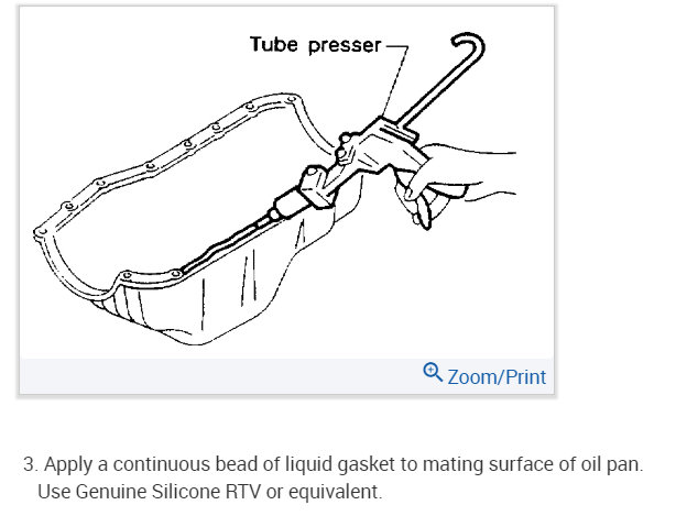

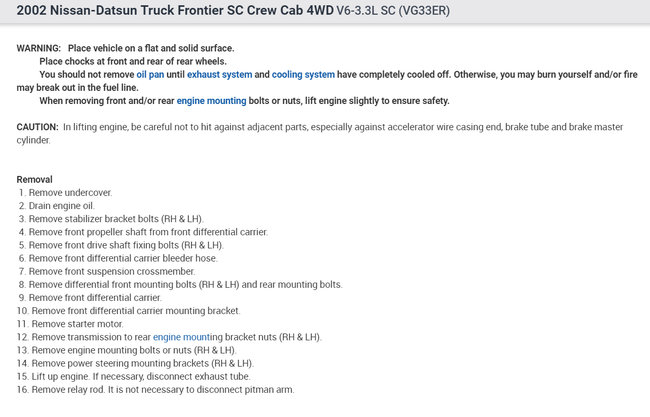

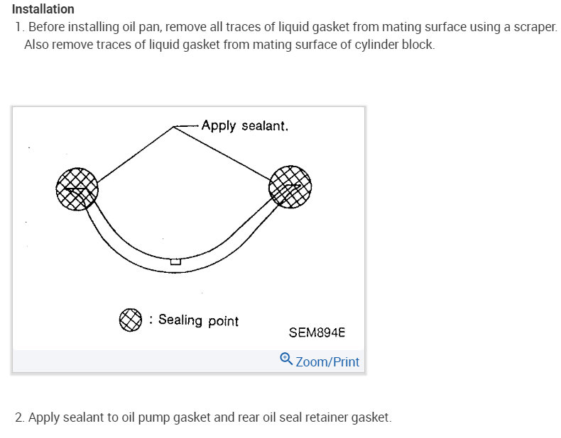

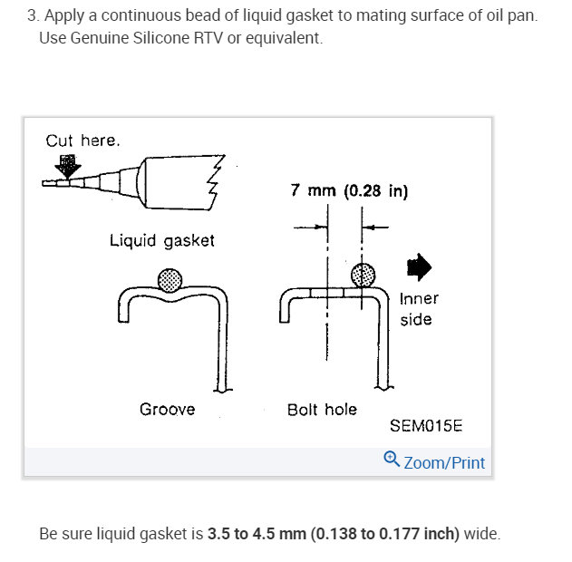

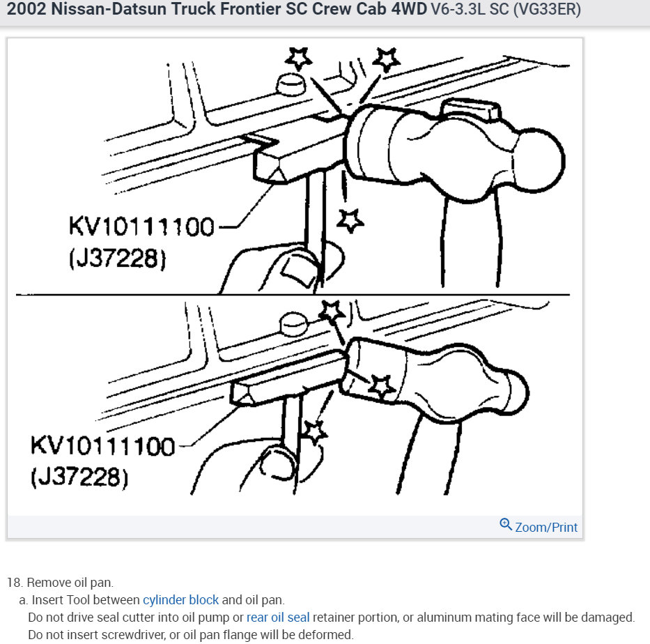

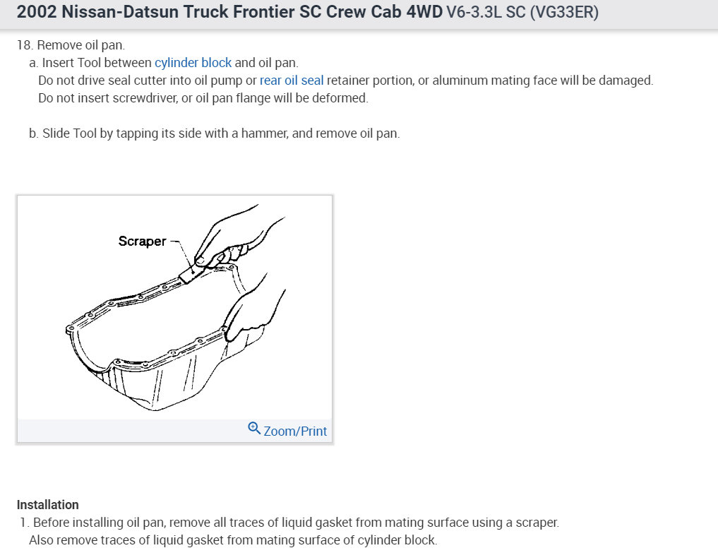

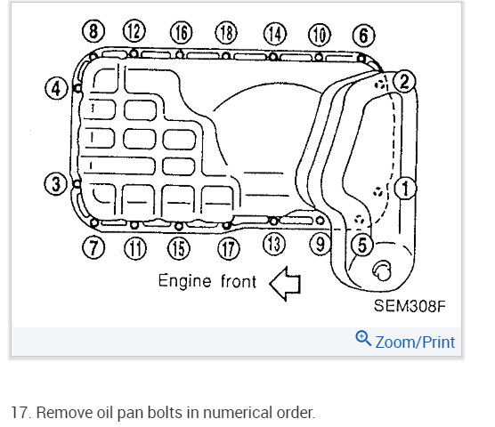

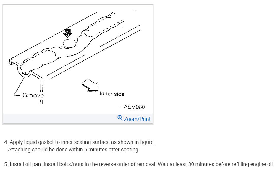

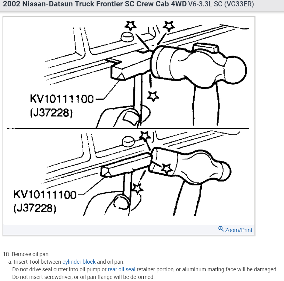

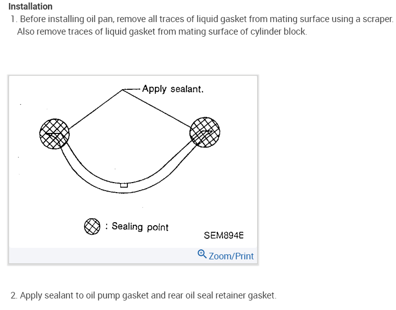

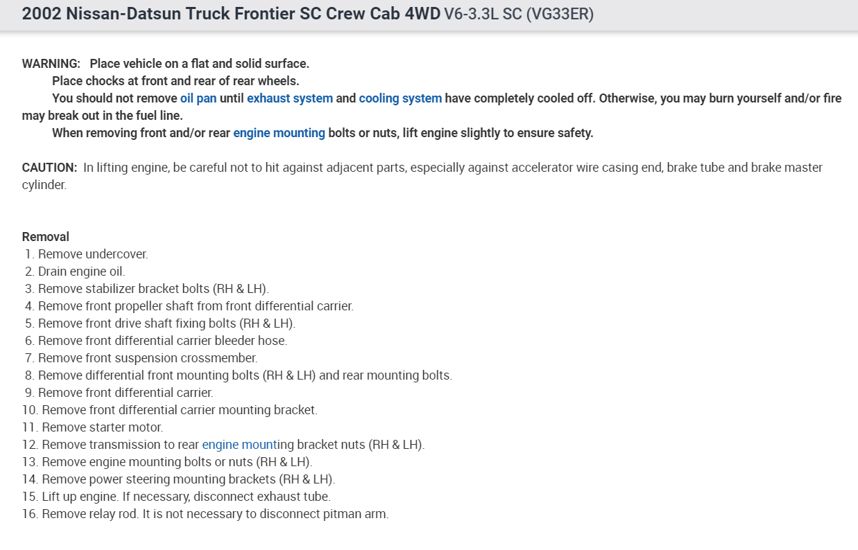

I need to change the oil pan on my 2002 Frontier. Are there any problems I may run into or any tricks I need to know before I do this?
Jun 11, 2009 at 11:52 AM
BLUELIGHTNIN6
  • 16,542 POSTS
You must start by draining the oil and disconnecting the battery. Use a jack and jack stands to secure the vehicle. Here are the diagrams and images and instruction of how to do the job below.
Cheers
