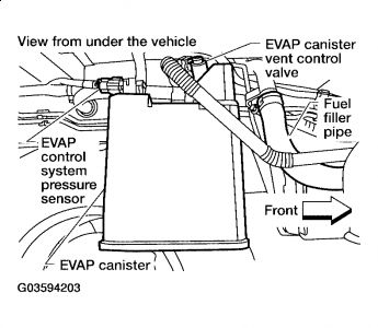

FRANK VELEZ
Code is 1446 What is the cause of the problem and how is it fix
Jun 1, 2019 at 12:10 PM (Merged)
DOCFIXIT
  • 18,828 POSTS
Hi Fault with Evap Canister Control valve need a diagnostic scanner to do testing. see diagram locate and see if hose good or anything looks damaged.
https://images.2carpros.com/forum/automotive_pictures/198357_Graphic_269.jpg
Hope this helps Thanks for donate
